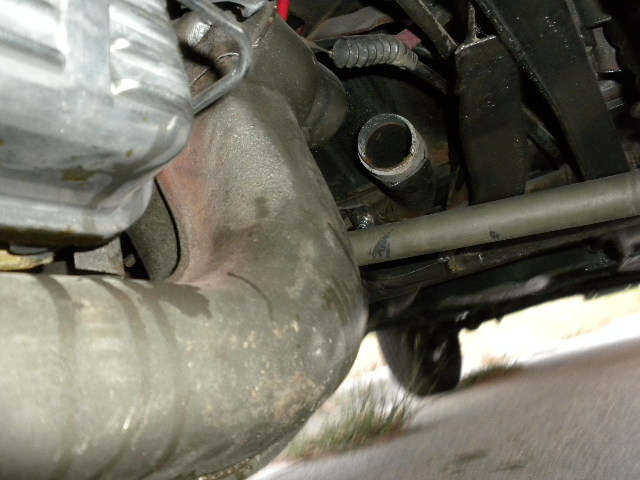

PostPosted: Thu Sep 29, 2011 9:36 pm    Post subject: Posted a few pics Reply with quote
So here the heater box and the missing pipe. Today I shoved a tennis ball in there to see if that would help and than drove to work. I wasn't smelling a lot of exhaust but still some. Got a headache when I got out of the car. Is this psychosomatic or what?

you need to tape them up until you get the system fixed before you kill your self. The headache is likely carbon monoxide poisoning.

PostPosted: Thu Sep 29, 2011 9:58 pm    Post subject: Reply with quote
x2
I doesn't look like much is missing with your heater boxes. The heater boxes look in great shape, and the heater control cables are even there. I'd definitely block it off immediately and start sourcing the parts.
As far as your rear window seal goes, if you have an air compressor you might try blowing so air around the seal with someone inside on the back side of the window checking if they feel any air coming through. If you don't have a compressor, maybe you could do the same thing with a hose? But definitely get those heater tubes sealed up and that should take care of the majority of your problems.
