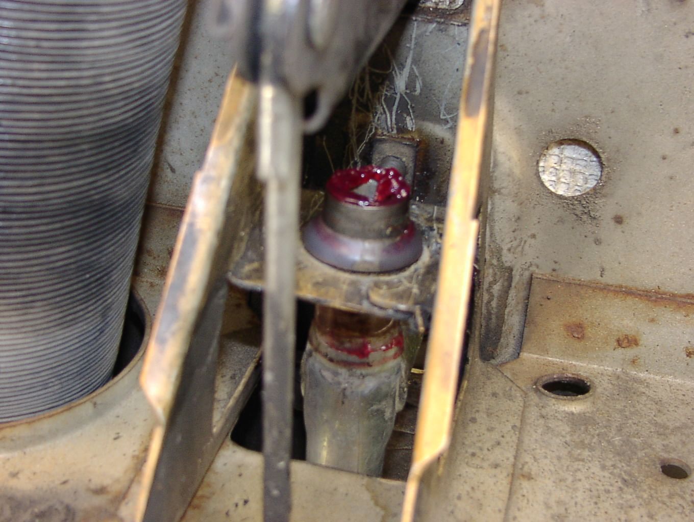

I recently purchased a 1978 bus that had trouble finding gears. It turned out to be the front shift rod bushing. I suggest you drop the front splash pan and inspect yours. If you decide to replace the front bushing you'll have to do two things.
1) Remove the shifter. Be sure to look at the orientation of the reverse lock out plate and see that it matches the Bentley pictures.
2) A couple feet aft of the front of the shift rod is a coupling where the front rod connects to the aft rod. There is a grub screw to remove and then you can separate the rods. This will allow the front rod to move aft enough to get the bushing in place. You have to do it this way, no shortcuts.
Before
after
