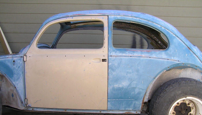

The 61... the car is for a customer and he doesnt know im doing this photo documentary, so dont tell Tom. Laughing

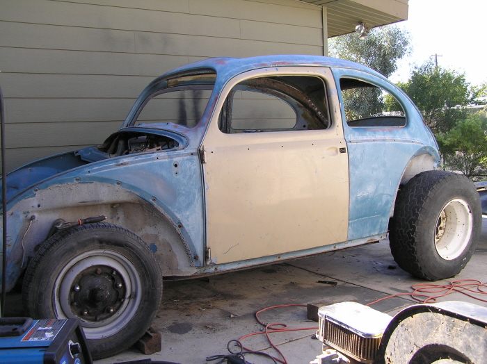

This is the welder i use. Wire feed with gas to keep the heat down,
bosch 4 1/2'' cut of wheel, markers and duct tape.

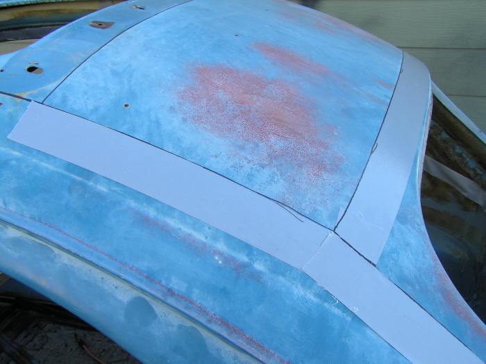

Thats a good point...
This will also need two roofs but one extra roof will work.
You can see where the duct tape is used.
This works out to be a 3 3/4'' chop. More chop, wider tape.
And more roof setions.

Every post gets the same tape guide.

Also tape or mark it where the posts are the same size around.
Thats why the door it taped lower than the front window post.
