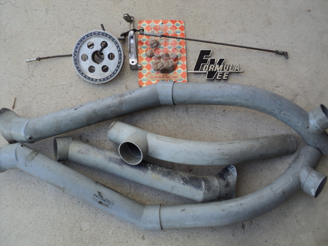

I have a full set out of a car now.. Ill try to remember to snap some pics
Here is one from the gallery
