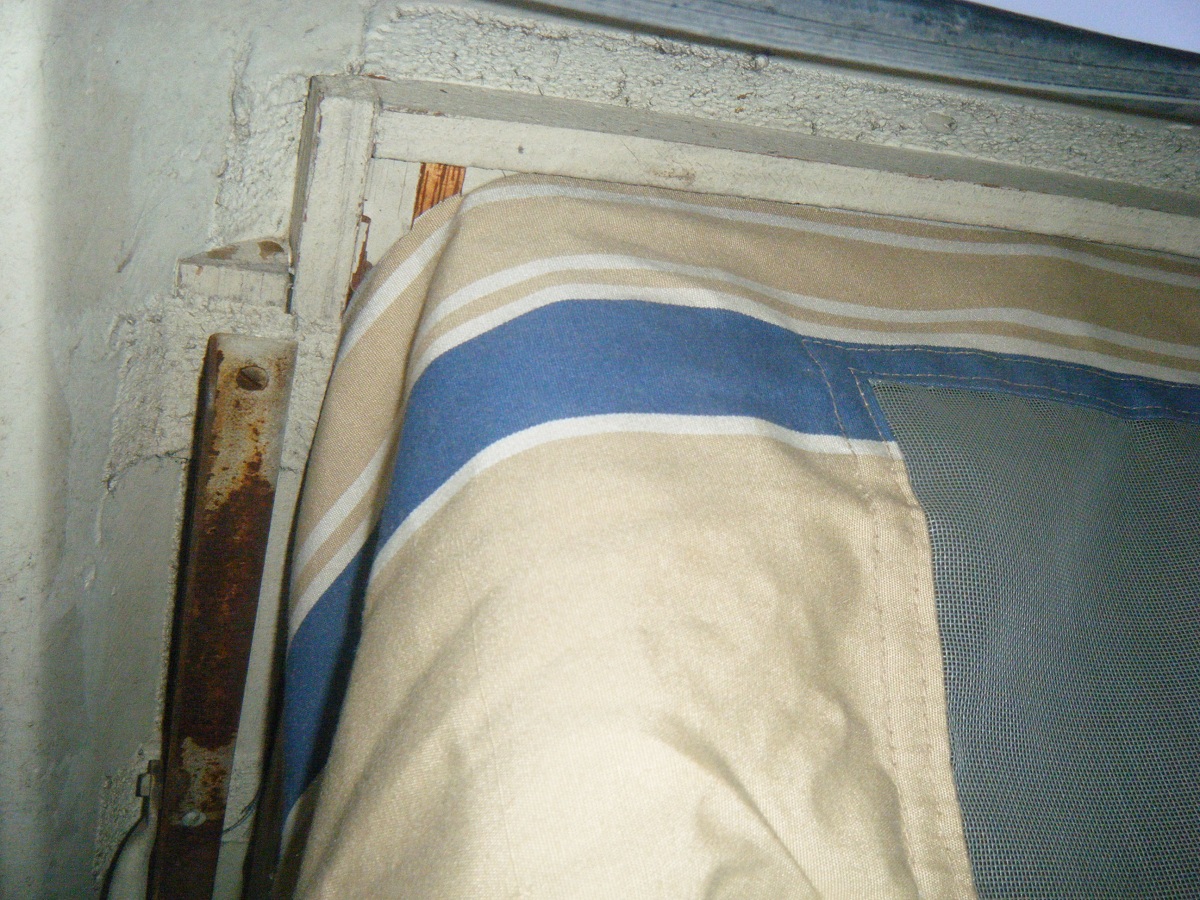

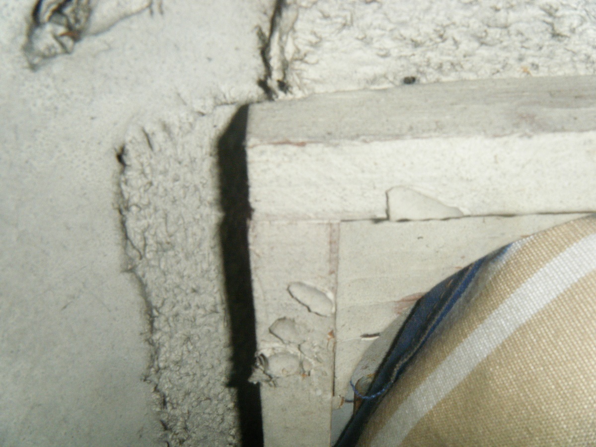

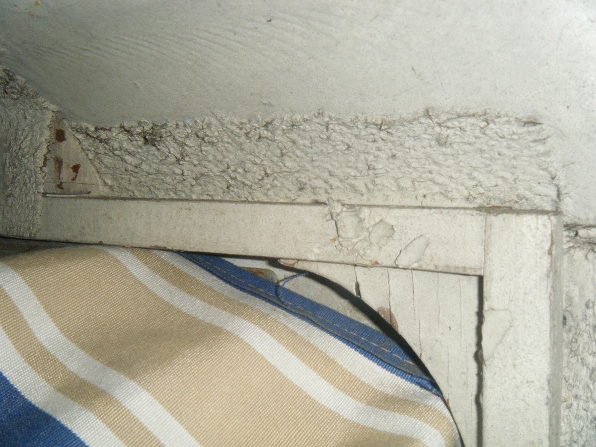

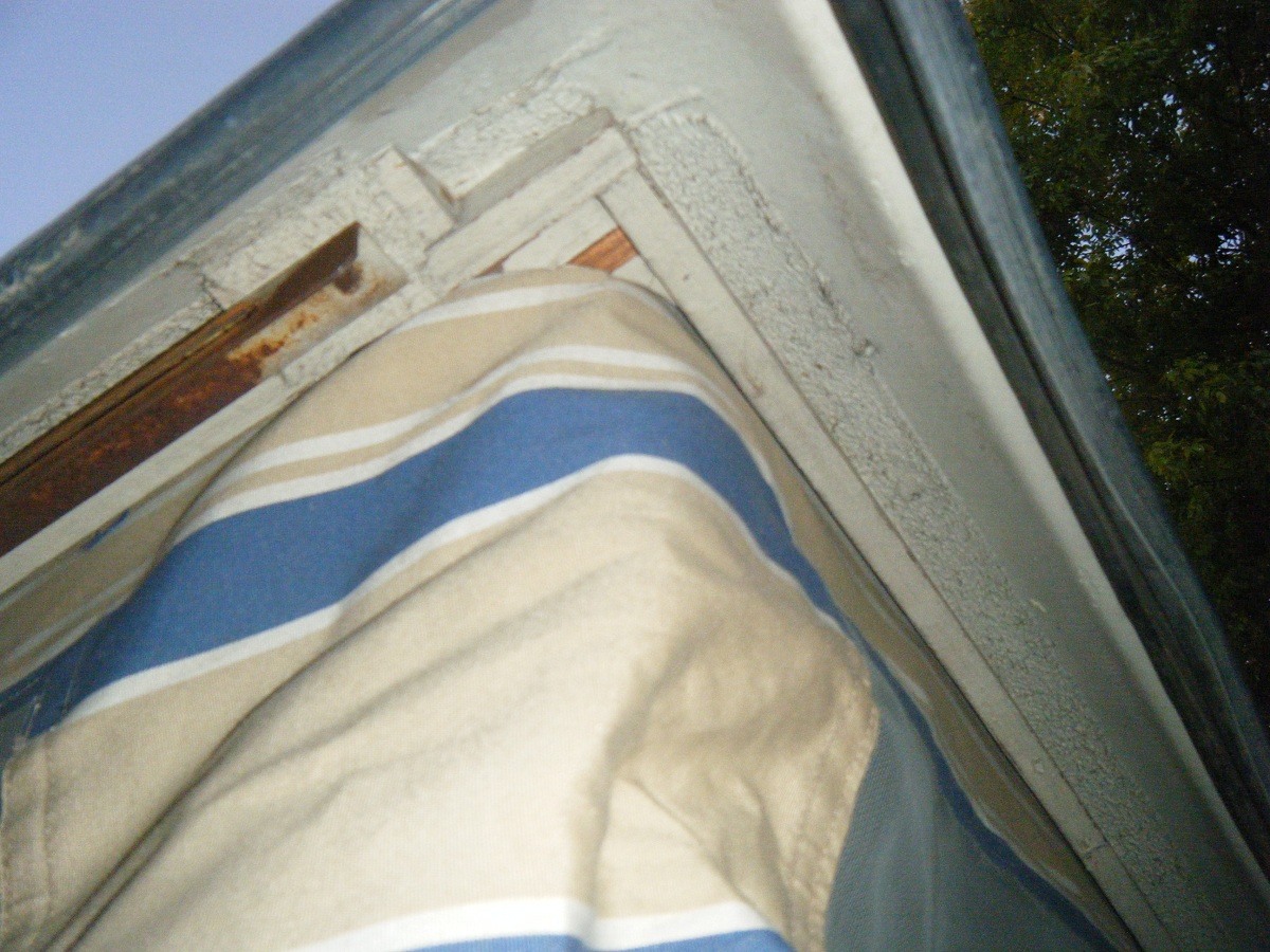

PostPosted: Tue Nov 15, 2011 7:01 pm    Post subject: Reply with quote
OK, went and measured and took pics of an OG top:
This is the longitudinal stringer, end to end measurement:
Sorry, I couldn't find a metric tape but the height was a little short of an inch:
Yeah, this one sucks, the other end of the tape was on the end of the crossways stick and ended up 5/8" long of however many inches that is, that doesn't include the width of the longitudinal piece:
And a little detail shot of the corner:
If I can find the time I'll pull the top out of where it's stored and do better.

busdaddy & Busryder, I guess it's time to get those new bifocals I didn't see the wood frame and thought there was a wood board inside where the handles go. I have looked at this top several times and I guess the dirt in the inside kept me from seeing there is no board inside and I don't know why I didn't see the wooden frame. Thanks so much for opening my eyes here is mine below yes I need new glasses. Not in vain as I'm sure this post will help someone down the road. Thanks again for all your help, I'm trying to get a lot done before the awful cold and snow of the north east so I am not seeing what is in front of my face I am embarrassed, Embarassed So glad I didn't buy the one for sale (it sold the previous day)...still Embarassed

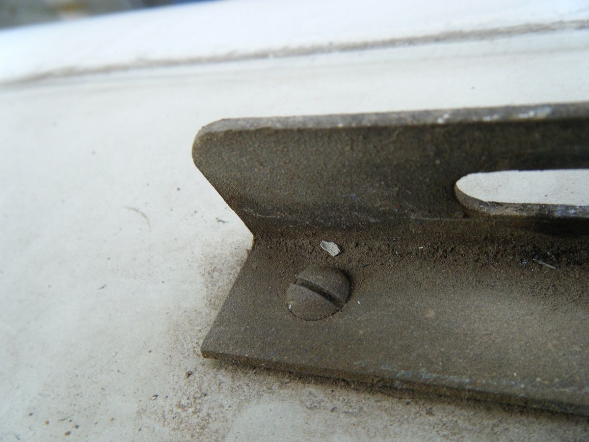

I know I'm pushing it but what type of screws did you use to attach to the bus? I thought there was still one attached to the frame when I got the bus back from the body shop and it looked like a pan-head sheet-metal style screw, yes it goes through the hole in the metal roof then to the wooden frame on the bus roof.
mine Embarassed
Linda, they appear to be the exact same screws as the ones that hold the scissor mechanism to the top portion of the Pop-Top wooden frame. I did not, however, attempt to back the screws out to determine they're length.
Hope this helps a little.
