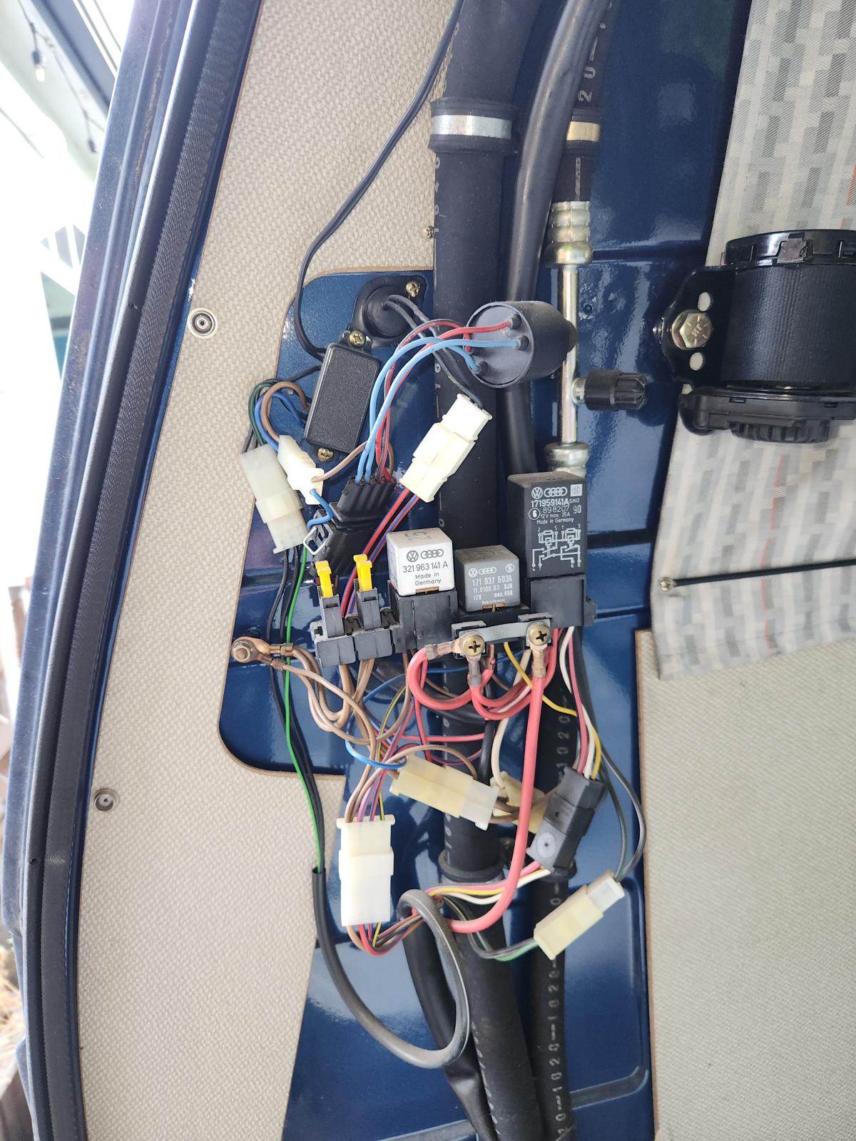

A few pictures of the easy part. I was suprised by how good and clean everything looked, compaared to what some of you have posted. Was the A/C used at all? Who knows.
Looks brand new!
I have yet to test the blower motors, but the resistors look good. Their mounting brackets are the only things that broke. Even the drain pipe bits are in good condition.
Evaporator
I will be modifying the wiring as per the Wiring master topic. Will be discussed further in this topic. Looks good anyway.

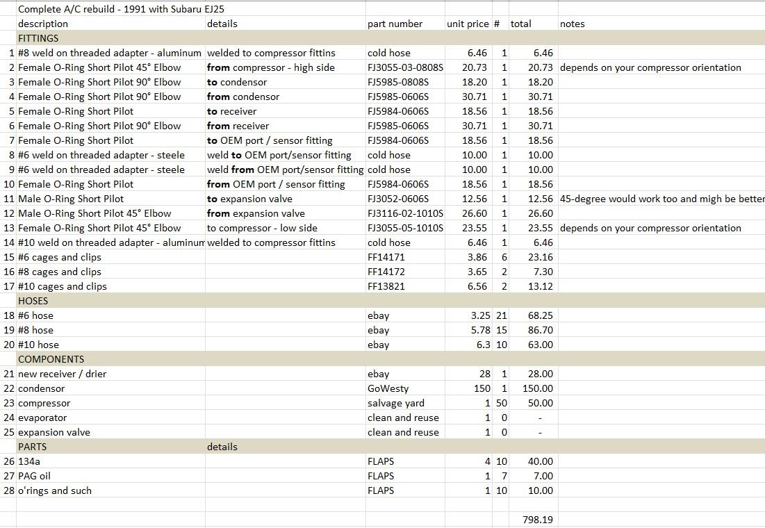

I am at the tail end of doing what you are doing: just finished putting the system together and about to pull a vacuum.
This is an all new system in a subaru swapped 1991 camper. I used EZ clips throughout, replaced the compressor, condenser, and receiver. Cleaned and reused the evaporator and expansion valve. I am working on a write up and parts list, but will add the draft to your post. The system will use 134a refrigerant.
About your oil question, the info is in the Bentley. If I remember correctly, it is 0.3 oz in each of the receiver, the high pressure hose, and the low pressure hose. The evaporator gets 5.something oz of oil. I used PAG 100. Feel free to DM me your phone number if you want to talk.
To get you started, here is my parts list and diagram of the system. Yours should be exactly the same with the exception of the connection to the compressor -- this wil depend on the location / orientation of your compressor, the specific adapters, and how you want to route the hoses.
I suggest you take all the hoses out -- go ahead and cut them to make it easier. Pay careful attention to hose routing and take some photos. you can take some measurments of the three sizes of hose (-6, -8, and -10), but you should be able to use the lengths in my parts list.
1991 manual camper with EJ25

DeLvxe! Wow! That is going to be so helpful. Thanks. It might be helpful to talk on the phone, when I'm further along.
Compressor: Is it the same model than the stock Subaru-provided one?
Hoses: you used the same sizes for the new hoses?
Fittings #8 and #9 on your list: what are these? where is the OEM port?
