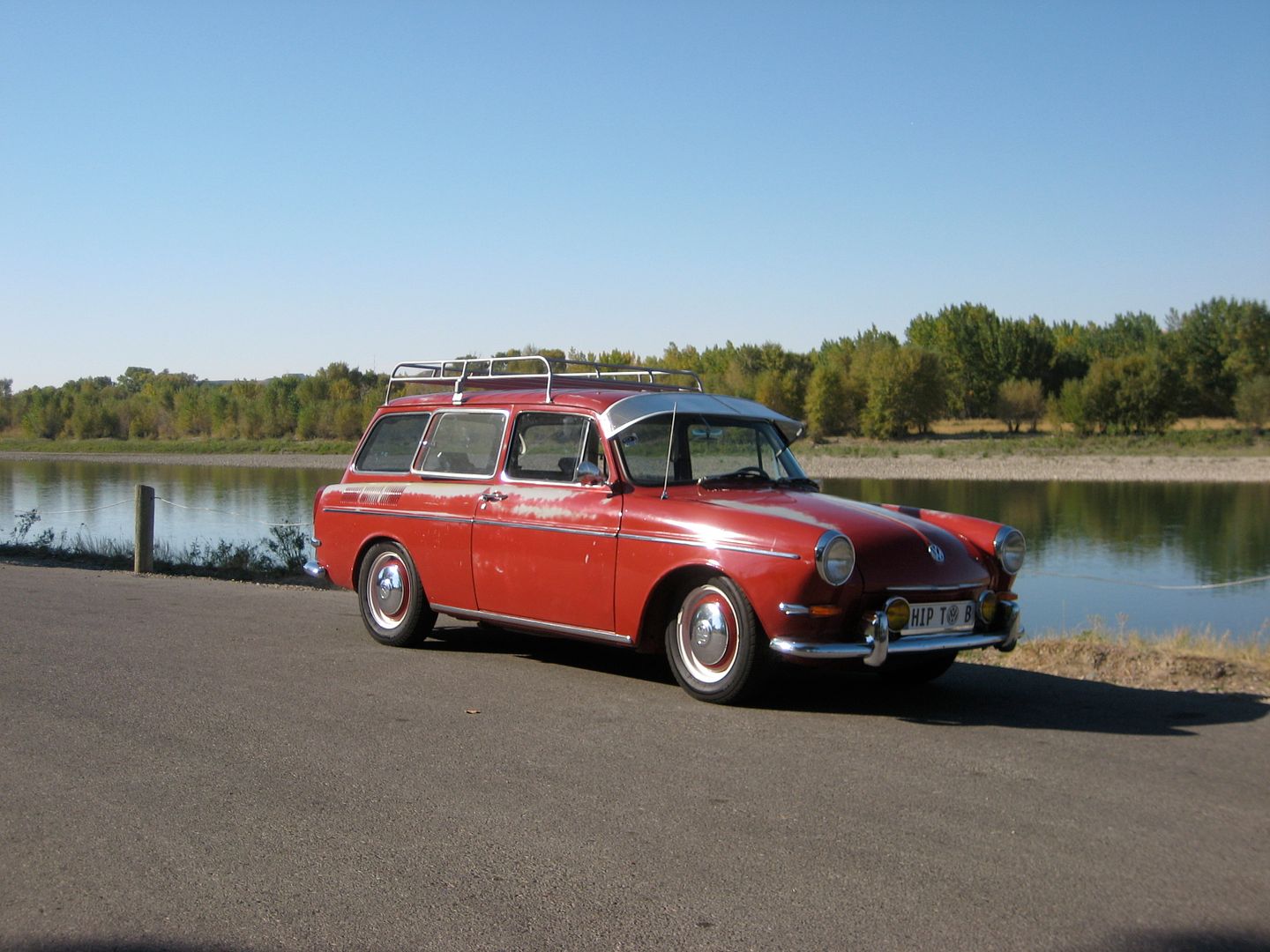

wanna guess which panel was sprayed with zero-rust?
It was a wierd coicidence, I ran out of red oxide and reordered but they shipped me safety red so i mixed them 50/50 and had a bang on match for 46 year old ruby red. Wink
