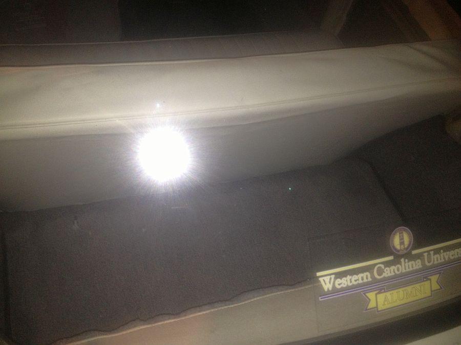

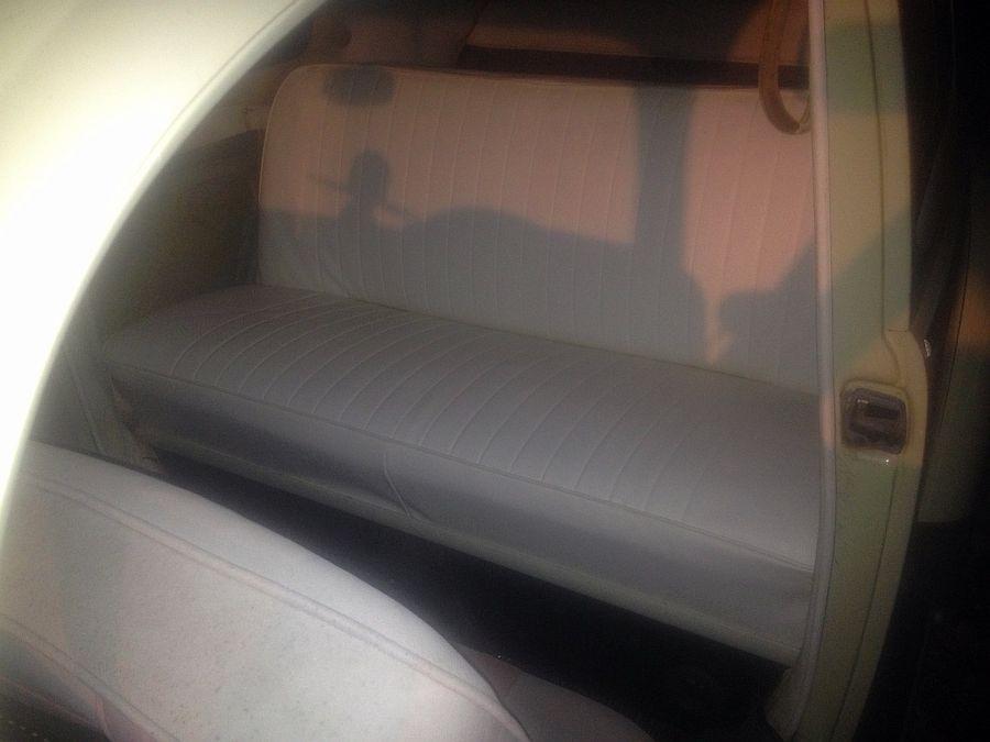

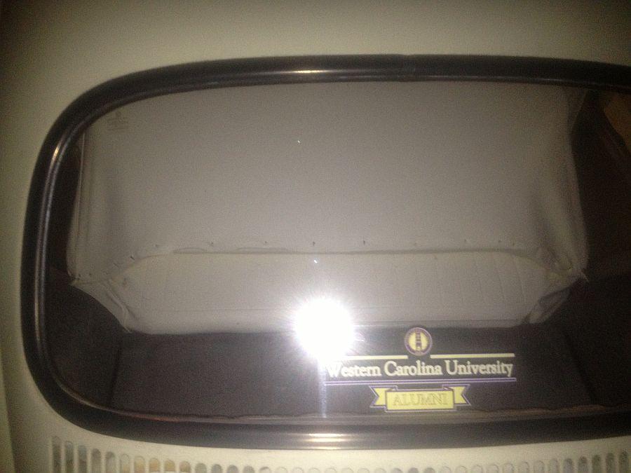

I just recovered my rear seat in my '64 ( Oct '63 )
There was no board backing, the new cover just went over the seat material , prior owner had a saran wrap material over the top area to make the cover slide down easier, massaged and stretched the cover and hooked on the spikes at the bottom.
OK here are a few pics... dark outside, but should give you an idea.
maybe one day I can save up for some OG seat material. $200 / yd is not in my budget at this time.. lol
