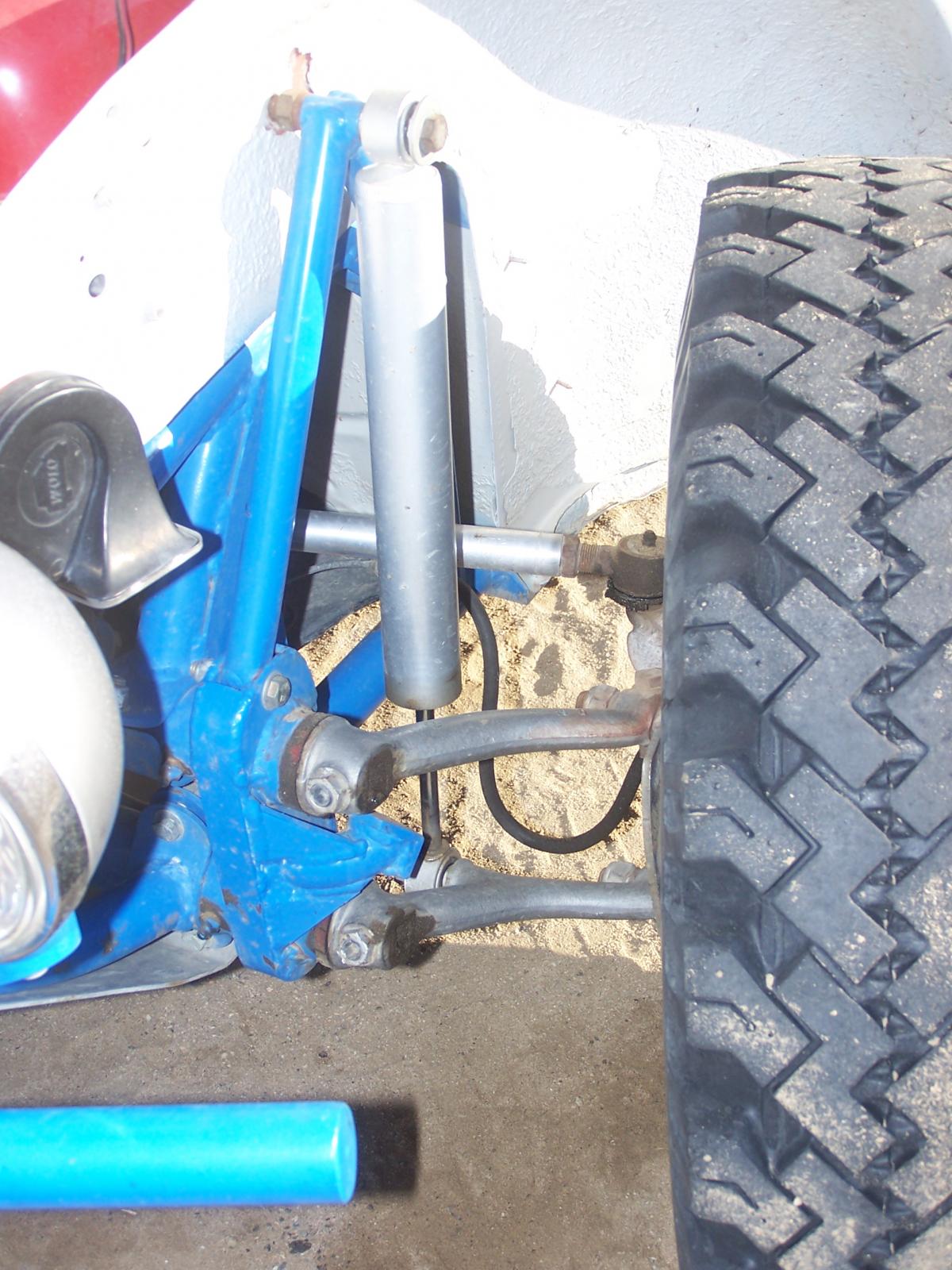

https://www.kybshocksonline.com/product.aspx?zpid=1533
would these fit on a lifted linkpin my mount to mount length is 16 inches

PostPosted: Tue Nov 15, 2016 3:58 pm    Post subject: Re: SHOCKS SHOCKS SHOCKS Reply with quote
Those shocks are KYB's cheapest. They dampen like stock shocks. But they're made way better than most any car company's stock shocks.
Still, they're double tube. stock replacement. They're like Monroe or Gabriel street shocks.
They're NOT offroad shocks.
When you say "lifted link pin"...
- Where are the shocks mounted to the towers? Are the towers stock height? 8"? 10"? ?????
- Where are the shocks mounted to the trailing arms? Stock mounts? Extended mount near the lower link pin? Longer aftermarket arms?
- How much travel do you have the stops set at?
There are more possibilities. Each of the above and each of those not listed all affect how long the shocks need to be. And compressed length is as important as extended length.
Your question is like going to the butcher counter at the market and asking "How much does meat cost?"
Richard

sorry dusty its a stock link pin beam stock trailing arm with the stops cut off cut and turned a whole lot so when off the car you couldnt even get a shock on becuase the trailing arm would be in the way. the front is already really stiff i tried bouncing on it and it didnt budge. no limiters what will be the limiter is the shock sharft cover hitting the lower arm. yeah im aware thats horrible for it thats why i want cheap ones untill i can get nicer shocks and taller towers
