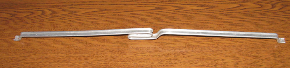

Total length is - 20 7/8"
Curtain area - 19 3/4"

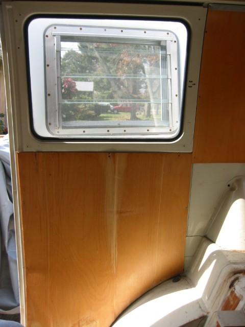

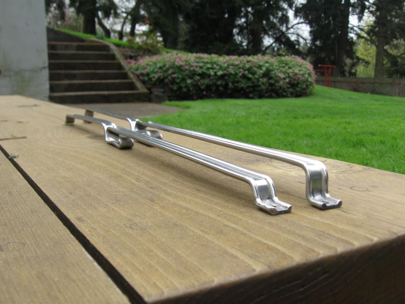

My curtain rods on the long wall (driver side) and inside the closet are 21" overall. They project away from the wall just 9/16".
The curtain rods on the cargo doors are half an inch longer. Because there is no room on the doors to mount the curtain rod above the window frame, Westfalia screwed them in lower, over the fake wood garnish. Consequently these rods must project outward 13/16" in order to clear the garnish.
The hole centers vary by bus as these were lined up and screwed into place by hand.

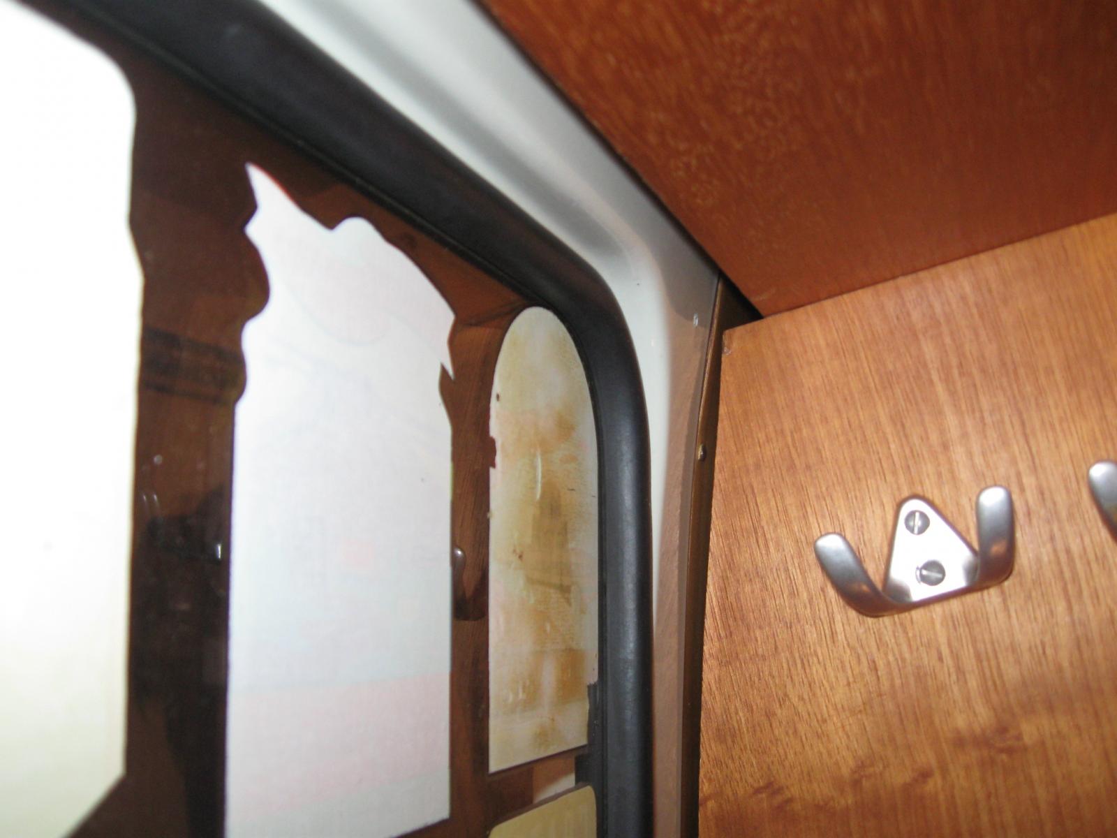

Inside the closet, the curtain rod is right up against the roof of the closet. If for some reason the closet is not placed on top of the wood flooring, it will sit too low and interfere with the curtain rod.
The information on the curtain rods for the rear hatch, along with the little doohickey that supports the center of the upper rod, is in another thread.

Thanks for these pics Major. My SO-42 did not come with a curtain rod in the closet and when I put one in there it seemed odd that it was all the way against the cabinet top as you mentioned. My closet is on top of the OG floor so I'm guessing it's just a very tight fit to get curtains on that rod?
I have not sewn my curtains yet so the rods are not in the bus. That said, I agree with you that it looks to be a very tight fit. I do intend to keep mine closed all the time anyway but it does seem like they could have mounted it a bit lower.
Here is another old photo I just found showing the holes without the closet in place.
