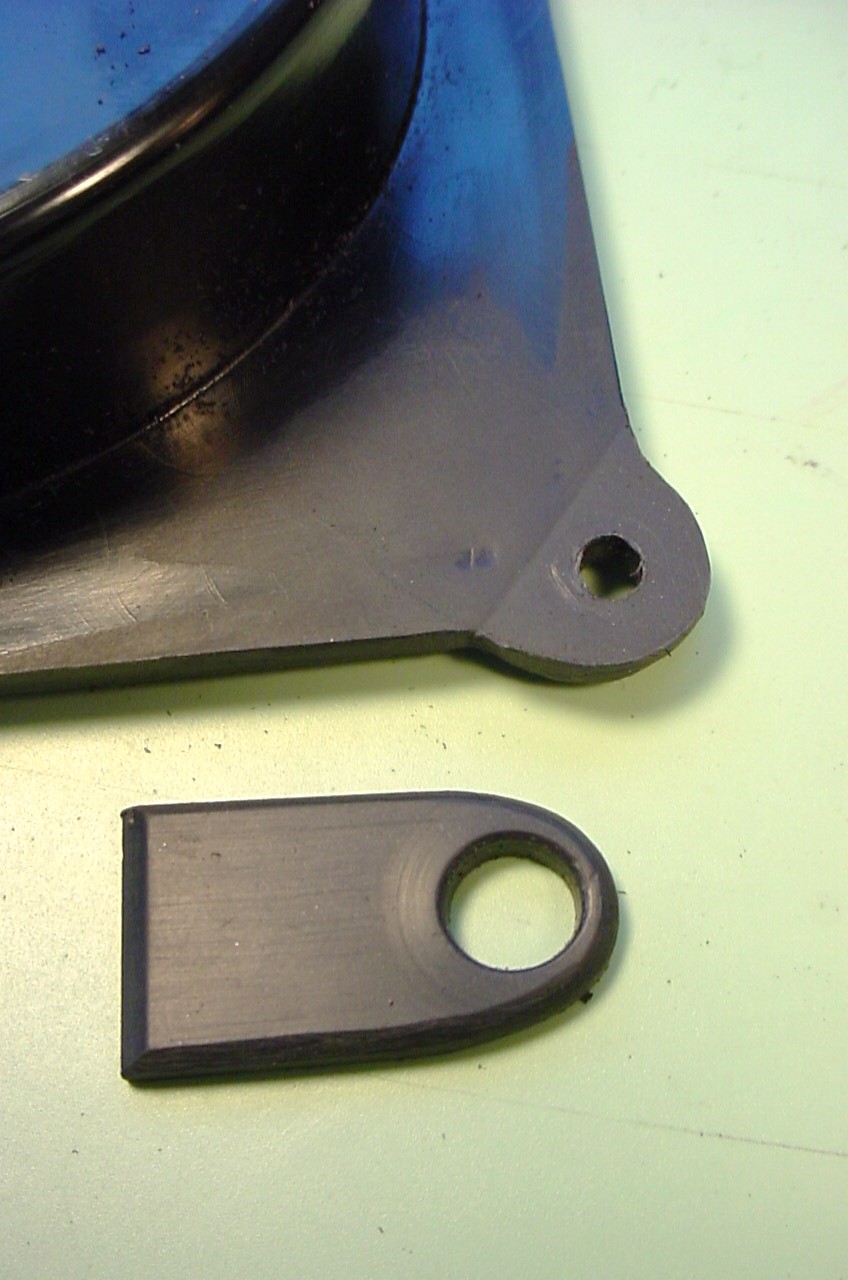

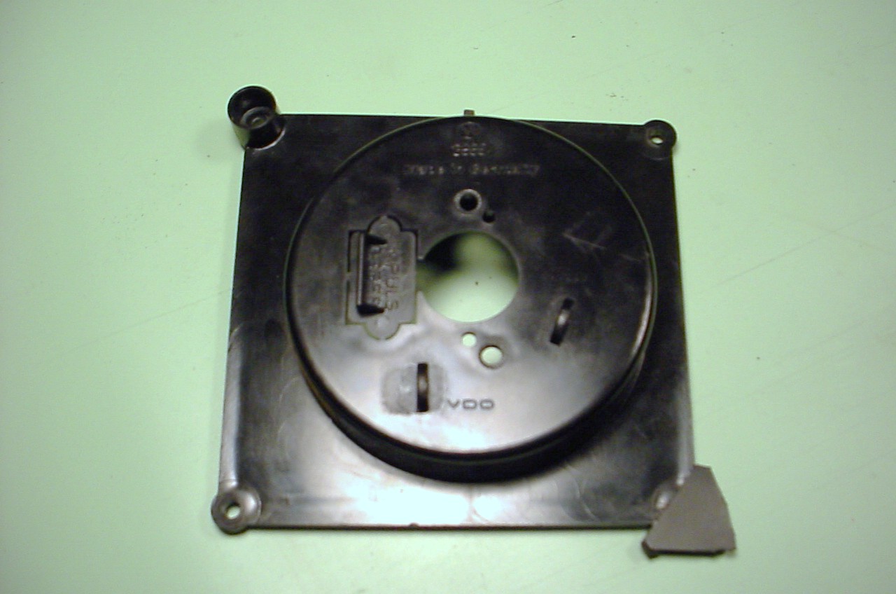

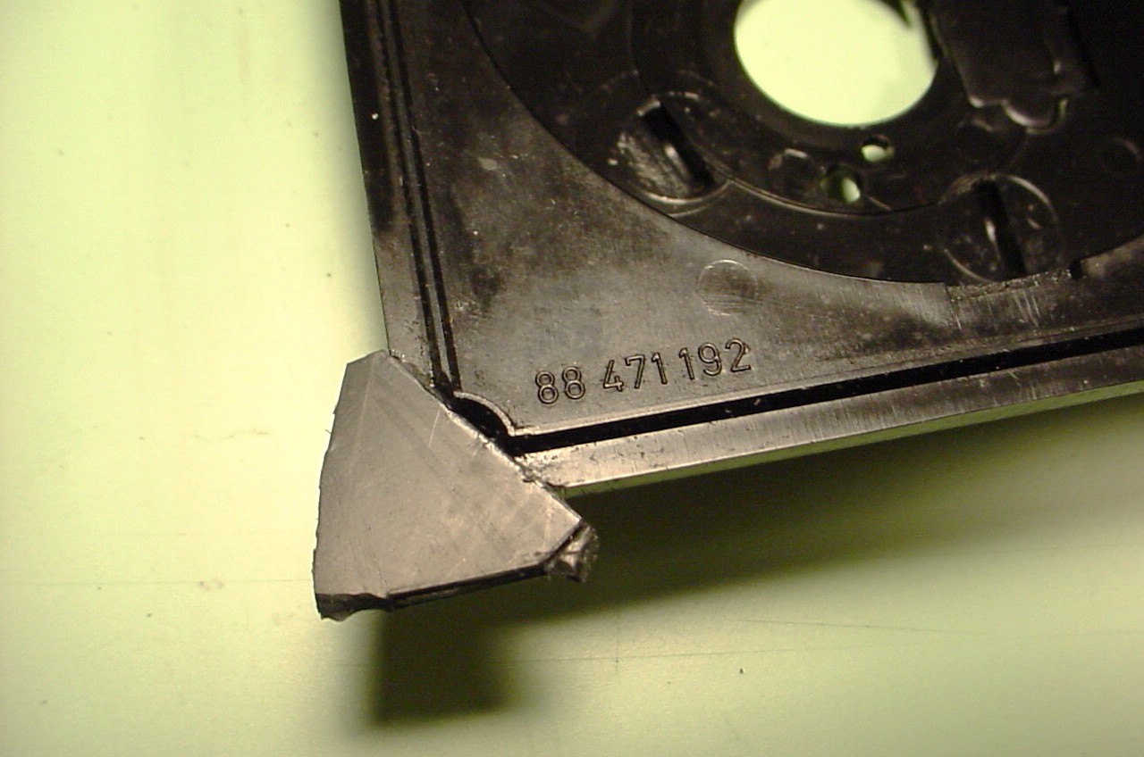

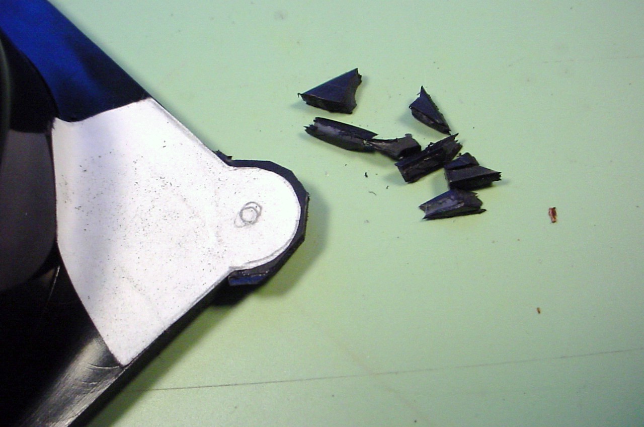

Utilizing some ABS and Styrene plastic from various sourcesin my garage, I was able to reconstruct and reenforce a damaged corner on the speedometer plastic support.
Solvent glue was used to smooth out the repaired area.
Hope this helps.
-T25 Pilot

Can you be more specific on the type of glue used? Also any hints on how to identify the types of plastic?

Technically it is dichloromethane (or methylene chloride) but is sold commercially as Plastic Weld or other such brand names. It is a solvent and works amazingly well with certain plastics such as styrene, ABS and acrylic (on some other plastics it does nothing at all). It fuses the pieces together without adding "glue". I have used it for many similar repairs and I am a big fan. It is usually available in hobby shops.

I had to repair the ear on my power mirror adjuster on my 80 series LC, and did something similar.
I used some small nails(picture frame nails) as imbeds into the existing plastic, and then used some epxoy called AquaMend. It comes in a small roll, and is a two part mix that you mash together kind of like play dough. You can form it to whatever shape you need and then modify the shape to what you need.

The plastic cement I used for these repairs was made by Testors. It contains methyl ethyl ketone (MEK), however, in the past i have also
used the Plastic Weld mentioned by Perales. Both of these plastic cements/solvents are available at most craft stores, Walmarts, Kmarts, as well as hobby stores.
In identifying suitable plastics for your repairs there are a couple of methods I use. One is to look for the recyleable triangle with the letters "PS"below it.
The other method involves testing a plastic piece with a drop of solvent to see if the plastic is softened, or try joining two test pieces together.
I've used wire spools, food containers, broken toy parts anythig I can get my hands on, preferably black in color.
