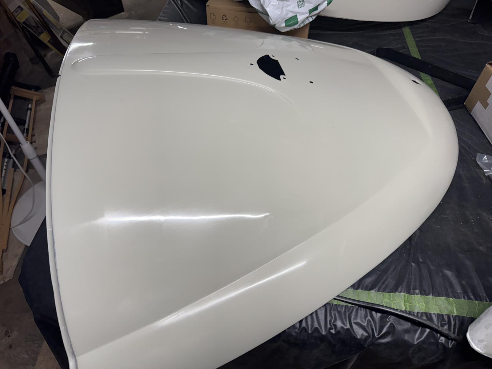

Ready to paint. Deck lid, engine lid, doors and fenders are all off . Would like to paint it all at the same time. Base/clear. Will I have a problem shooting the interior and then when I do the trunk will overspray mess up the interior I just sprayed or vice versa . TIA

The only thing I did in sections was the body. I did the inside of the trunk and trunk side of dash separate from the rest of the car. I then covered the trunk area (hood was sprayed off the car) I used paper to fill the windshield opening to prevent overspray from hitting the front of the car or vice versa - from getting into the interior. Also covered openings in dash from trunk side when I did that. So when I painted the body I did the dash and interior when I did the exterior. I painted the engine vents below the-rear window with a small gun I bought at Harbor Freight. It’s a 4oz. Detail gun gravity cup and was only about $15. It worked great. I also splurged for a new gun- the black widow from HF. Very happy I did. I used almost 2 gallons of paint -$700.00! Good luck!

Hi @Far rider - what color is that?

Yeah - hard to tell from that picture but it’s Pearl White
