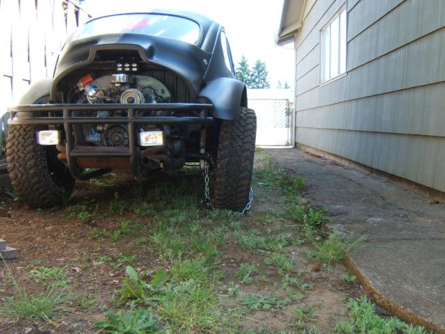

1938 - 1967 used the swingaxle rear end. Limited wheel travel. tendency to be unstable at high speeds. tendency to roll over.
Can someone dissect this a little bit for me? I have a 65 pan with a full length fiberglass buggy body. can you define "limited wheel travel" and "your definition of high speed. and is there a way to tackle this problem..
From 1938 to I think 1959 (may be 1960 also, just can't remember right now) used a split case trans are are the weakest. The 1960 and up (including IRS and Bus) are tunnel type with a solid case and stronger than the early versions.
Limited wheel travel means that the axle will only drop so far until it binds up on the inside of the axle where it goes into the differential. Same on upward travel. A total of about 9 inches of travel (some can get just a little more and some just a little less, but very close to 9 anyway). So if you need a lot of travel to soften the energy absorbed from going airborn while jumping, the swing will not get it.
High speed depends on the surface you are running on. I drag race a swing axle trans on asphalt and high speed to me is 150 mph (I currently run 115 mph in the quarter mile). High speed off-road on dirt/sand could be over 40 MPH depending on terrain.
Jack the rear of your buggy up until the rear wheels leave the ground. See how they tuck in on the bottom? If you are running higher speeds on dirt or sand and go around a cornner and the wheel diggs in, it can jack the car up like this and increase the potential to roll over.
Mal evolent wrote:
by limited wheel travel, I mean: what you got is what you get. limited to factory specs.
IRS cars can be modded with longer, wider trailing arms. you aren't limited to what Dr. Porsche decided to use 70 years ago. No point doing this if you don't change the front travel to match.
high speed, in a baja bug, is when the ass end decides it wants to get there first. when you get over enthusiastic with the fun pedal, the back end starts to twitch left and right. more so if you have high positive camber. get a little behind in correcting that, or over correct, and you get to find out how well your roll bar works.
why, yes, now that you ask, I did.
this guy knows what I'm talking about. Note that the rear tires roll on the outside edge:
GreeneHoosier wrote:
Swings are tough, but the camber issues are a PITA.
