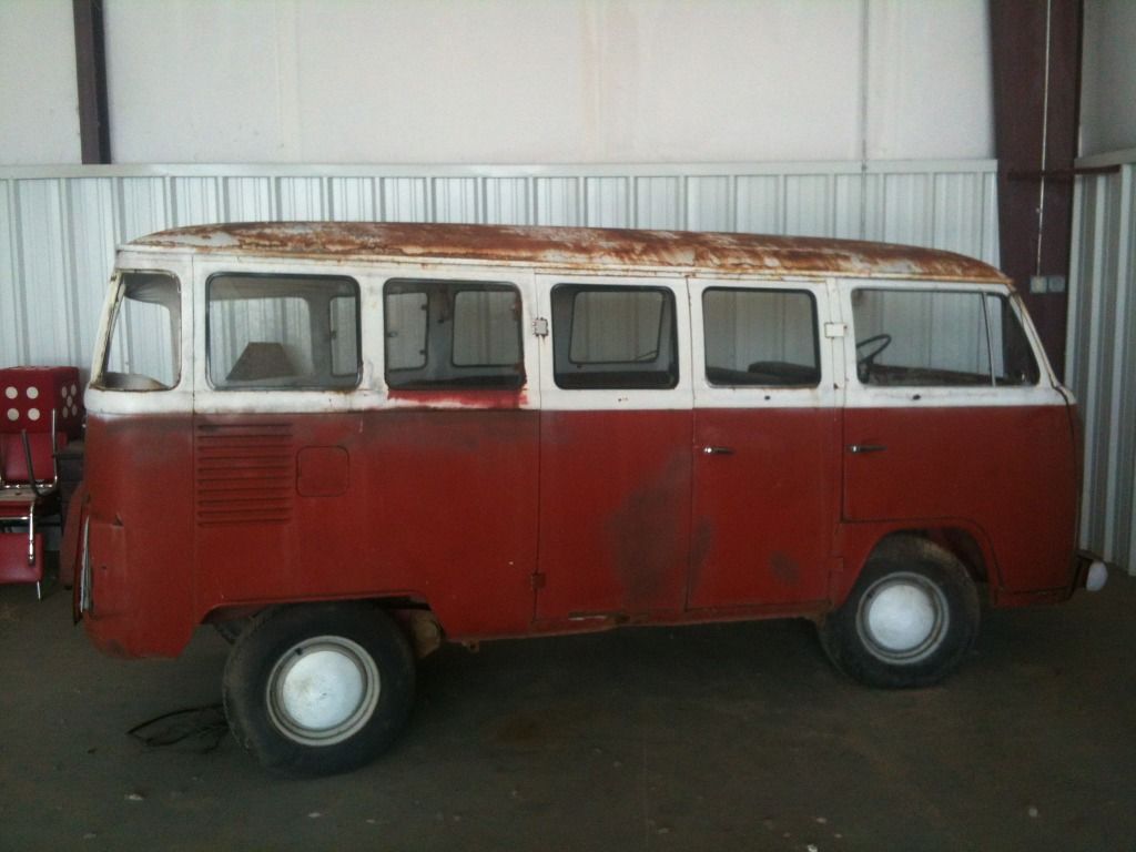

I got an old wrecked 1982 Brazil bay window/barn door/??? bus about a month ago - I could have saved up and gotten a way better condition running newer bus, but I've never seen a bus like this before and wanted a challenge. It was in an accident (killed the driver, not wearing a seatbelt Sad ) that damaged the front left and back left corners. The interior paint is the only thing I'd say is in good condition, but overall, I've seen much worse come and go on here as far as restos go.

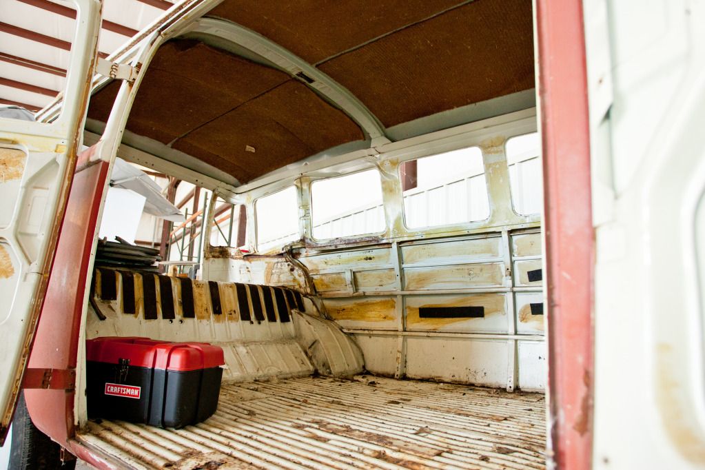

My latest progress was removing all of the windows, miscellaneous hardware, headliner, and interior panels. You can see in the above photo that the sound-deadening material is still glued on to the roof and walls. Since all of the interior paint is in very good condition with no rust, I will leave the roof like it is and only remove the wall material.

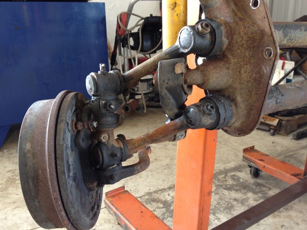

I have the front axle beam out and welded up a stand for it, so I'll be able to work on it without leaving it on the floor. I hate working on the floor - it feels unprofessional and is a pain!
Last Friday I was able to remove all of the axle parts that appeared damaged in the previous accident. I found a little more damage than I had hoped, but all of the damage is reasonable. As a technical side note, what I found was a twisted upper torsion arm and either a slightly bent kingpin or spindle assembly. The next thing is to send my spindles out for overhaul.

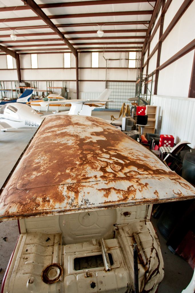

One of the biggest work areas is the back left. The damage isn't catastrophic, but it will take a good bit of work to get it repaired. In order to do a full repair, I'm researching pulling the body off the frame. Most Volks say it's impossible or can't be done, but I've seen photos and videos that show otherwise - right now it all depends on how much work it will take to pull the body off, or in simpler terms, how many welds will need to be drilled and ground off. I'm most likely going to have to un-seam the exterior from the interior sheet metal and cut the exterior metal out, for replacement. I may be able to recover some of it, but not much.
It's coming pretty slowly but there is a lot of work to be done on it. I expected to find more problems as I got into the project, and I have, and they have all been manageable so far. Rust, some frame damage, etc.
