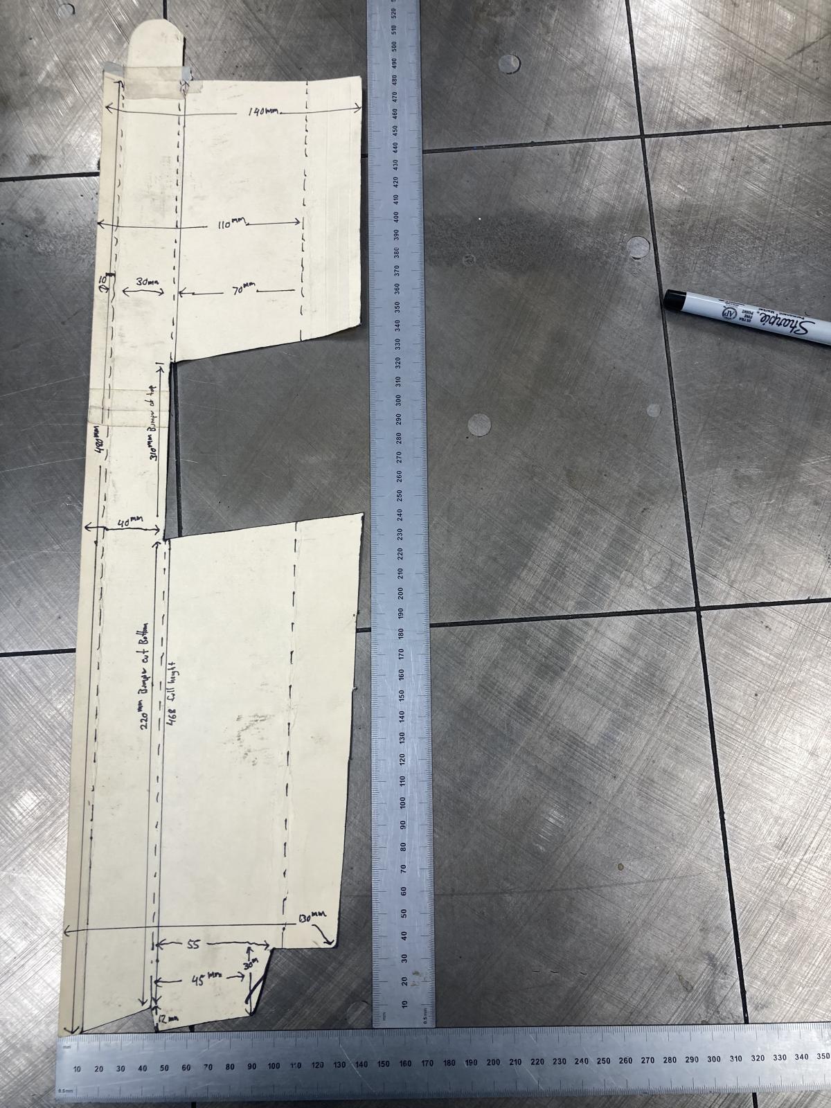

PostPosted: Thu Jun 26, 2025 8:30 am    Post subject: Re: Radiator card board deflectors Reply with quote
After my engine swap noticed these where missing. Do they make an improvement? No evidence yet, but I don’t think they will hurt as VW had then there from the factory. I struggled to find and accurate template with all the dimensions. There are a couple of older pdf files on different sites that samba members have posted over the years.
Anyway this is my template, hope it helps someone. Made them out of a plastic card type stock that I found in the garage. Original ones where a coated cardboard. I drilled the mounting holes in place. The dotted lines are bends about 45 degrees seemed to work for each one. Bends are opposite for the left and right sides. Once you get them in place it becomes obvious how they fit. Also go-westy has a Video showing installation.
