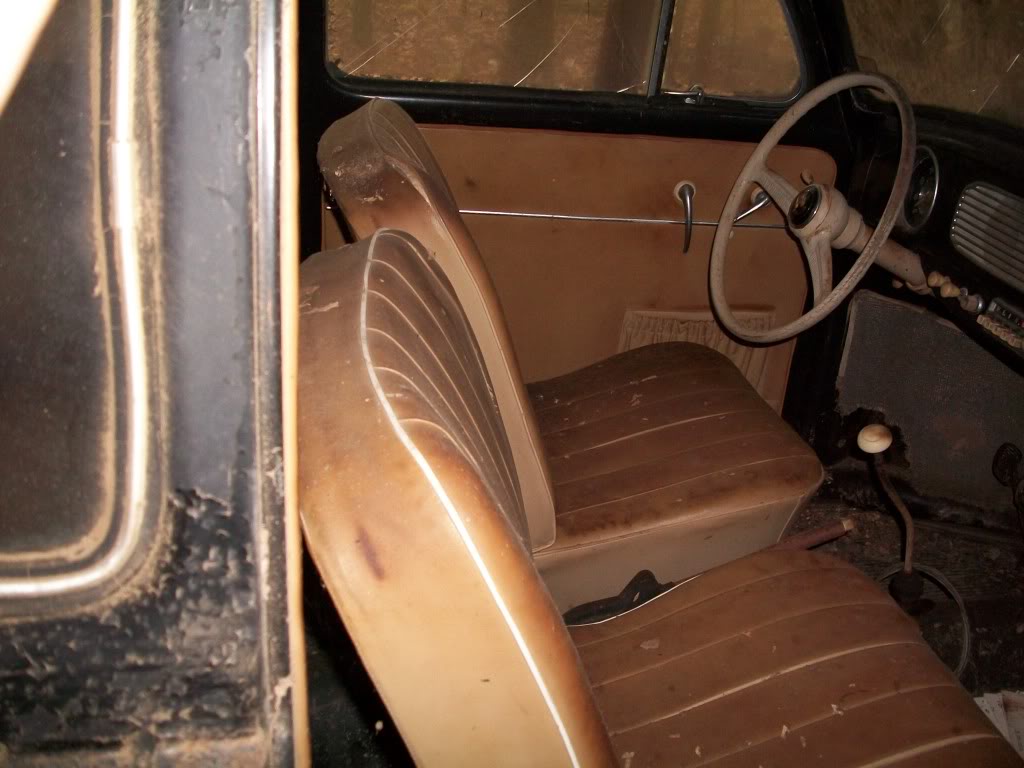

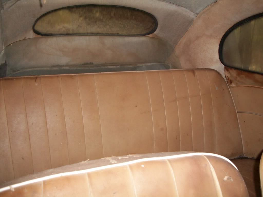

Pictures from Upshory leatherett...if the car was black then the interior would be red or Tan colour like cream for example?
regards.

about the leatherette
then what do you say about this M code?
135 Upholstery, leatherette Beige (thesamba) then if my car would be beige should have the M code 135??
So what do you sugest? the catalog is from 10/1955 and the car is from 1/1955
but in my case according tecnical from thesamba the M079 Upholstery, Stone Beige/Fur Grey and which says is leatherette instead of this material, nothing is written about the leartherette colour if beige red or other.
but for example according to another info i found this:
