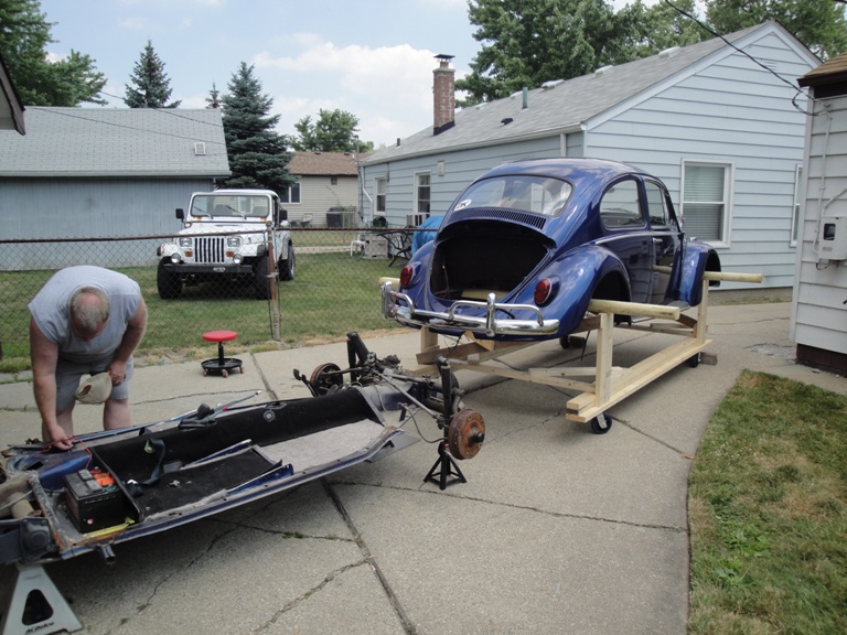

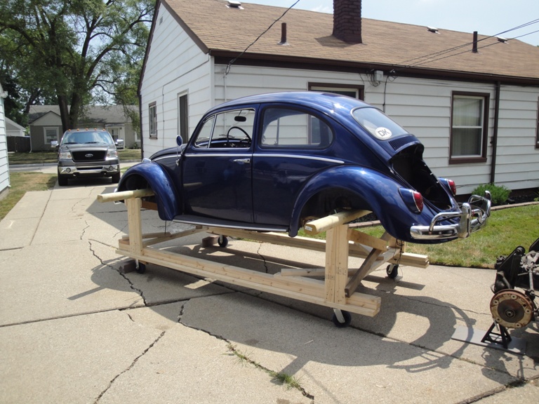

Hello and thank you guys for helping with some of the questions I have had answers here on the Forum. I really got into my project today. First a bit of history(I will bore you with this but I am a bit excited) I got the car from a guy a few years ago that was going to junk it. He had paid to have it restored but whoever he had do the work did not do such a good job. I will remedy the problems as I find them. I have had the car in storage in many places over the last few years finally ending up in my fathers garage for the last 2 years because I had lost my job and could not afford the storage fees. When I finally found work I had forgotten about the little car until about a month ago, when someone made me a offer to buy it. I had mentioned it to dad and he told me he kind of hoped I would keep it, because he liked it and would like to have it but it was up to me. I brought the car back to my house and put it in a neighbors garage, as my neighbor told me he would love to work on a project. This brings me today I have decided not to sell the car but to correct all the problems I have found(bad engine and trans) so far and fix whatever I do find. In the fall I hope to have this car finished at which time I will drive it back over to my fathers house and hand him the keys and title to the car he wanted but thought that he would get. Thanks Dad!
It will never be a show car but it will be a great daily driver.
What I started with...
Today...

Ummm there must have been really something wrong with the engine and trans to warrant the body coming off the pan?

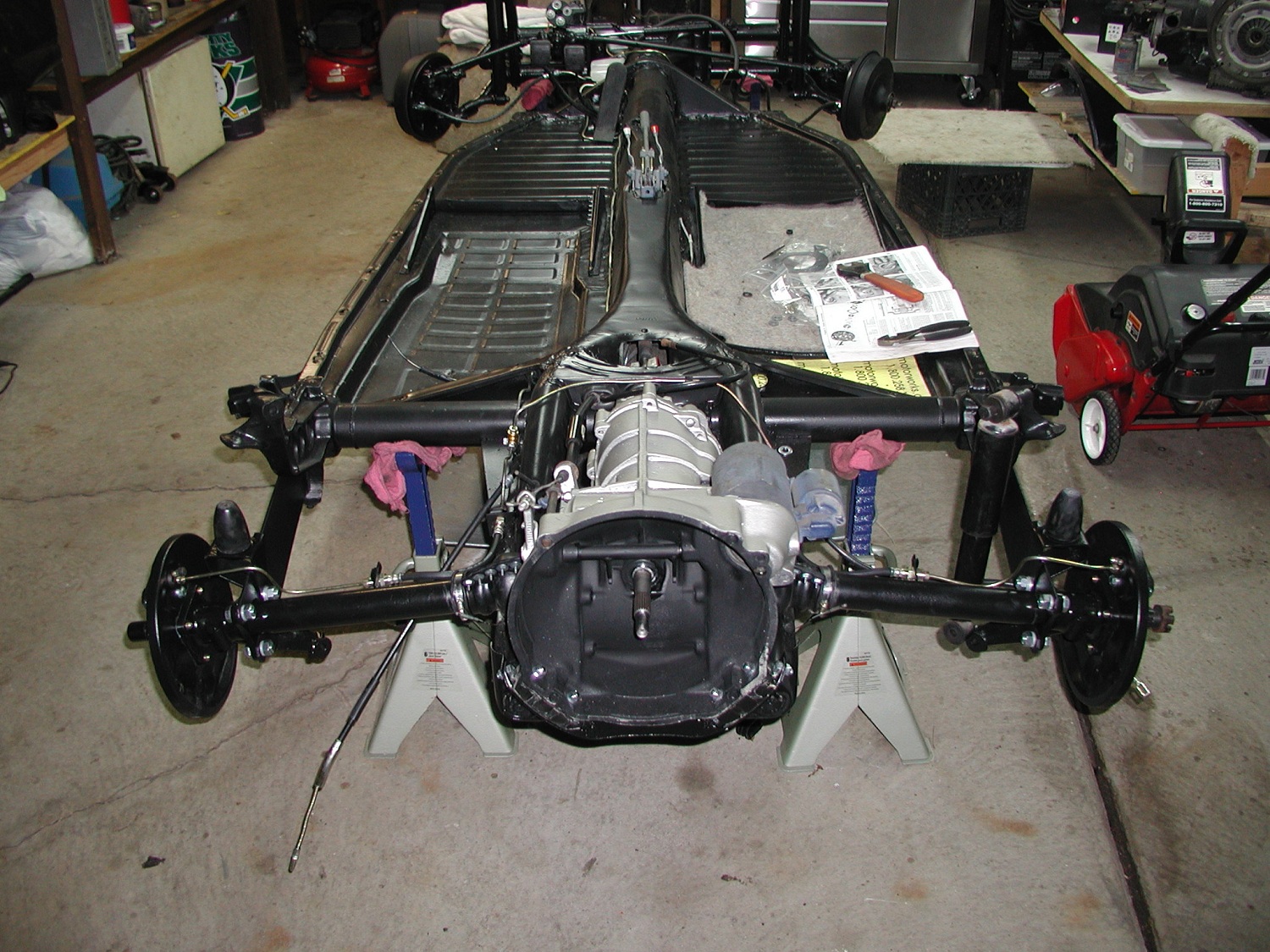

The project is going a bit slower than I had hoped but its getting there. I had found so much wrong with the car I decided to check every thing.
Things I found wrong and have fixed:
1 Broken pinion gear teeth, loose ring gear, broken teeth on spider and side gears(Rebuilt Rancho trans)
2 Worn out axle shafts (New Sway away)
3 A half inch of sand in the tunnel from being sandblasted (removed sand)
4 Sand in the brake lines(Every brake part replaced)
5 Frayed accelerator and clutch cables (Replaced)
6 Paint on floor pan flaked off easily (stripped and repainted pans and axles)
7 Floor pan only had welds in 2 spots per side(added few more)
I do feel sorry for the previous owner that paid to have the work done to this car. He got ripped off. I am trying to find out the name of the shop he paid to restore the car, so no one else gets ripped off.
