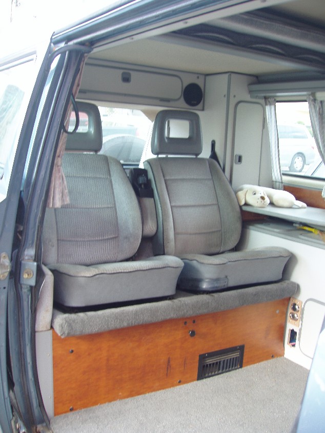

I really don't get the weight concern.
If you put a few adults in a 7 passenger vanagon, you've tipped the scales over what a modestly loaded-for-camping Westy weighs.
As an example, one adult weighs well more than the Westy kitchen unit.. which is by FAR the heaviest of the cabinets.
Having done the light-wieght racing yacht thing, I'd just warn that its an expensive rabbit hole.. with extremely diminshing returns on the dollar.
That said.. I am happiest thus far with this mod.. it added weight BTW.
The kids ride in comfort and we arrive rested. I'd like to lower the seats about 2-4".. but that will require some more premanent mods to the Westy setup.
I am trending towards modular.. Using the Westy layout as a place to start.
The next cabinet to be replaced will be the Westy water cabinet. It will be 4" shorter in length, which allows me to move the kitchen cabinet aft.. Allowing the driver to recline his seat all the way (YAY!). And providing a a slot to store table tops.
A shorter water cabinet will also allow me to slide the middle bench all the way in when the kitchen unit is out.. which will be most of the time. Middle bench 3-point belts lurk behind the cabinet.
(more pics in the gallery of the seat mod.. Westy bed is still functional, and its takes only a minute or two more to "make the bed")
Great thread.. Looking forward to seeing more interior ideas.

I'd be amazed if you could shed even 50 lbs by going to a hollow core material for the cabinet skins. More like 30lbs.. from my "guesstimate"
Where is the real "extra" weight in a Westy camper?
The fridge and stove.. unless you go fridgeless.. but an icebox will only buy you 30lbs weight savings.. and many of use/carry both anyway.
The propane.. unless you go to bottles, pretty well stuck with that weight too.
Water tank.. can't lose that either.
Then there is the Westy bed.. not going without that.
So.. hollow core for the cabinet skins... MAYBE 50lbs, total?
The real weight impact is when we load up. Its the STUFF that weighs the most. A 2 week camping load will almost entirely diminsh the 50lbs - diminishing returns (maybe 100lbs total? = one teenager?, if you find lighter plumbing fridge and propane)

in a Westy, the entire plywood cabinet setup adds about 160 lbs.
And if you replace it with entirely something else you need to subtract that from the figure you came up with.
Lets say at the very best you shave 50lb... that's half your tank of water or 5 gallons of fuel in the tank. Do you notice any difference when they're full/empty?
Weight shaving is a dumb game.
