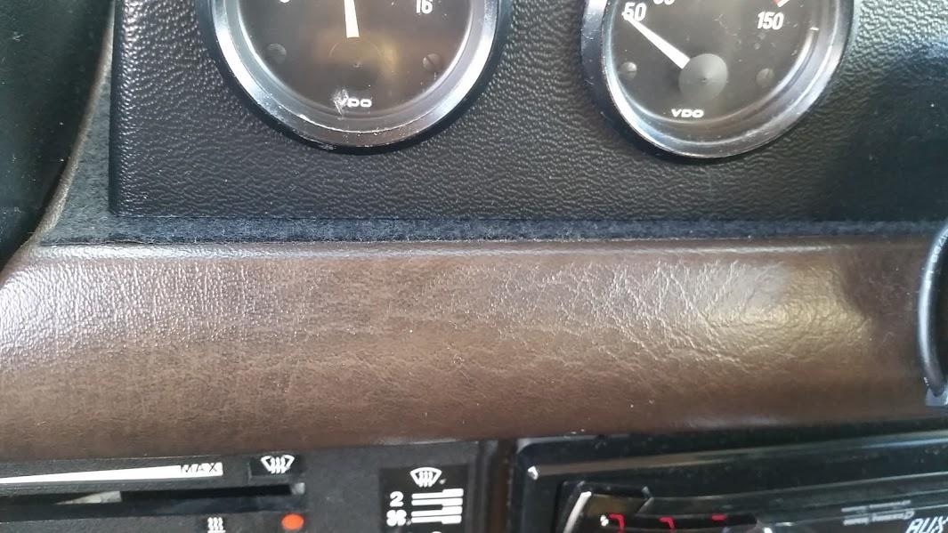

PostPosted: Sun Mar 15, 2015 10:43 am    Post subject: Reply with quote
Here are a couple more pics:
Thanks for the pics, worth more than 2,000 words! The part closest to the windshield looks as I expected after your last post.

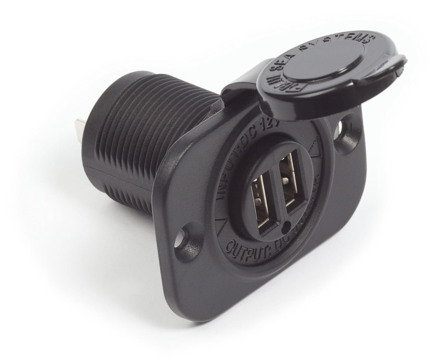

I'm considering a dual USB port charger vs. 12v port just so I don't loose track of the adapter. Once I get started I'll post (hopefully this year ... so many projects!).
Funny you mention that--The 12v adapter for the XM radio was clumsy and ugly, so I replaced it with a USB power cord and got one of these adapters so I can also charge my phone and/or GPS:
http://www.amazon.com/gp/product/B00M7M4GLI/ref=oh_aui_search_detailpage?ie=UTF8&psc=1
I was considering this: http://www.amazon.com/gp/product/B0082CXEI8/ref=ox...WS4MSNTF2A
Ultimately a tradeoff. I just know that the usb adapter moves around and I've bought more than we have cars at this point. Crying or Very sad Obviously it's the principle ...

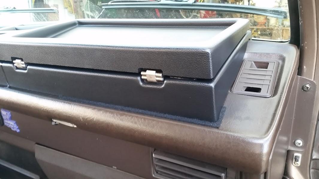

Have you got any images of the new console cover with the table opened?
This cover has been on my mind and really liking how you put the gauges into it.
Here are a few more photos from today. I ended up mounting the XM radio to the dash itself. The poptop warning sticker was a gift from a smartass friend, after I drove out of Red Rocks with my top up.
The USB power wire from the radio snakes under the console, through the ash tray hole, then out of the space where the heater cover and dash meet. the aux input follows the same path. It's still not as clean as I'd like, but it works.
My wife really likes the fold-out table on road trips. It's plastic, but surprisingly stable.
hey thanks, I know it can be a small procedure to post images!
How does your wife like the angle of the table? Is it easy to view or do you have to adjust yourself to see easier?
She's 5'4" so she has to lean up a bit depending on what she's doing I guess. It's a good laptop base when we're parked.

My dash console keeps humming along nicely, but the occasional squeaks and groans have always bugged me. I finally got around to taking care of it today.
I ordered some 8x12 sheets of adhesive-backed craft felt from Amazon and added it to the squeak points under the console.
I also took off the folding shelf to see why it's such a prominent source of squeaks. The shelf is two pieces of plastic with wood inside, and the two pieces are bonded so I couldn't get it apart. Instead I ran a little 3-in-1 oil in the seams (you can see some dripping in one of the pics) and on the hinges and put all back together.
The van is still a symphony of squeaks, but none of them are coming from the dash.
