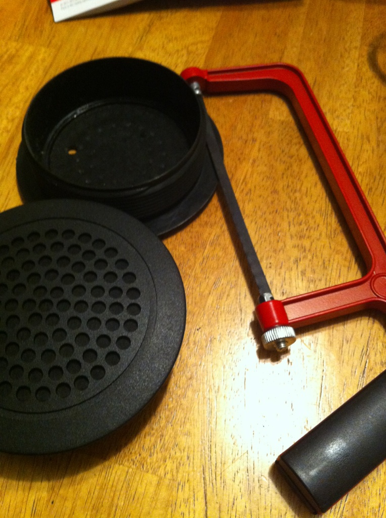

BTW, the original Blaupunkt speakers are glued into the plastic cylinder of the original grills. If you just carefully squeeze the edges of the cylinder in the back, the glue should crack and the original speakers will pop right out (at least they did for me)
So, next I used a hacksaw, and sawed the cylinders right off (sorry the pic is sideways...damn iPhone!):

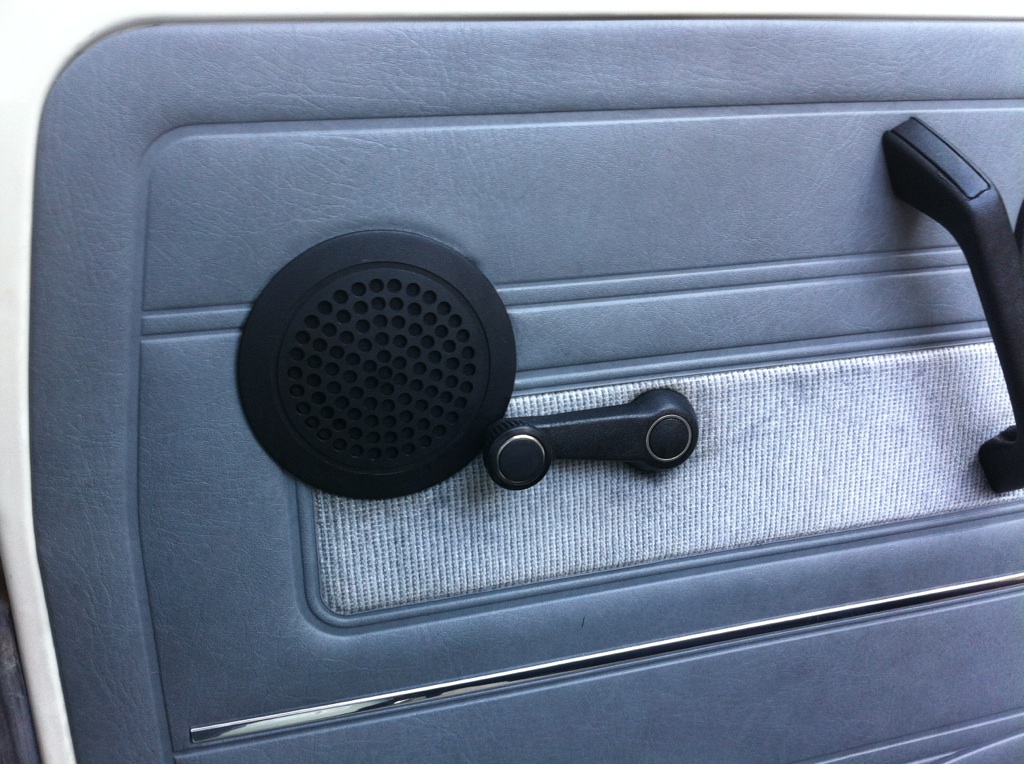

And here's the finished product. Those of you who are more handy, could probably make them look a little more seamless than me...I think I attached the grill just about half a millimeter too low. But overall, not bad. The cranks work fine, and I love the vintage look of the original grills.
The Polk speakers are a huge upgrade from the stock speakers. I'm really happy with how they sound.

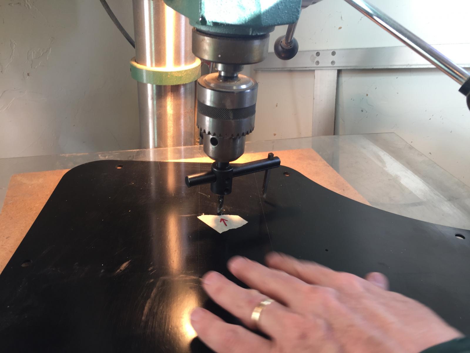

PostPosted: Mon Jan 02, 2017 1:20 pm    Post subject: Moving the front speakers Reply with quote

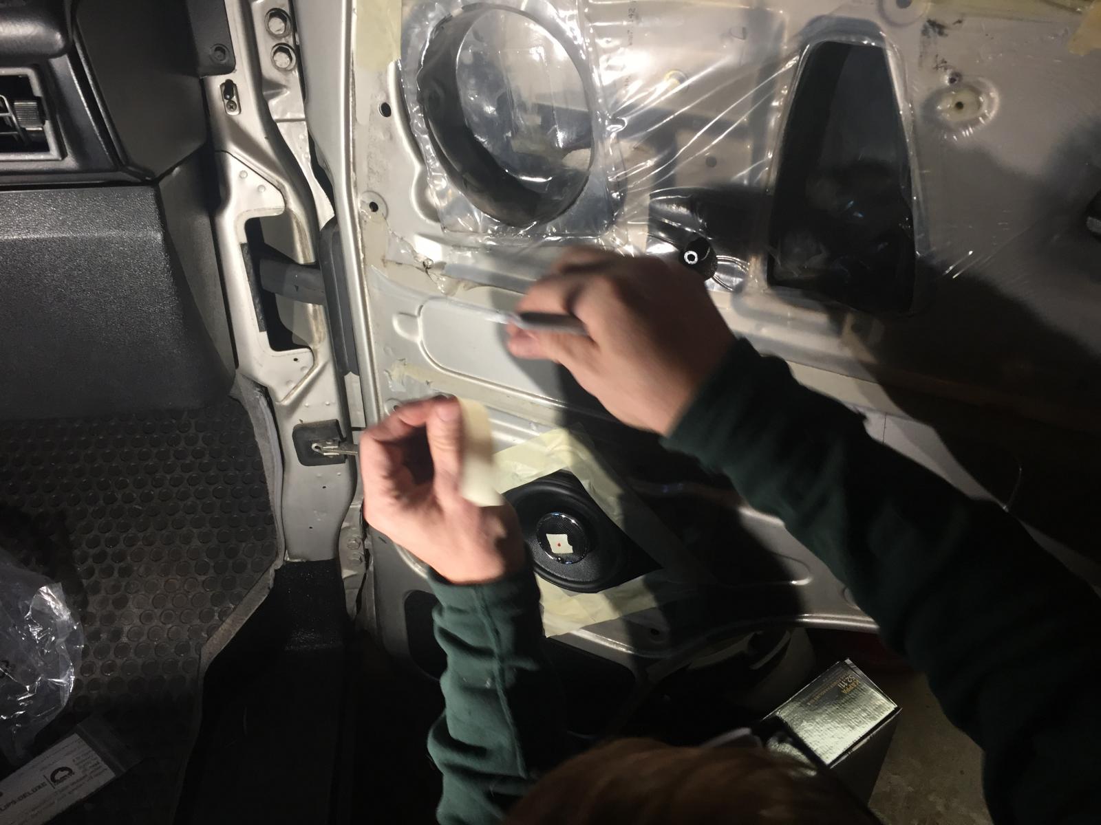

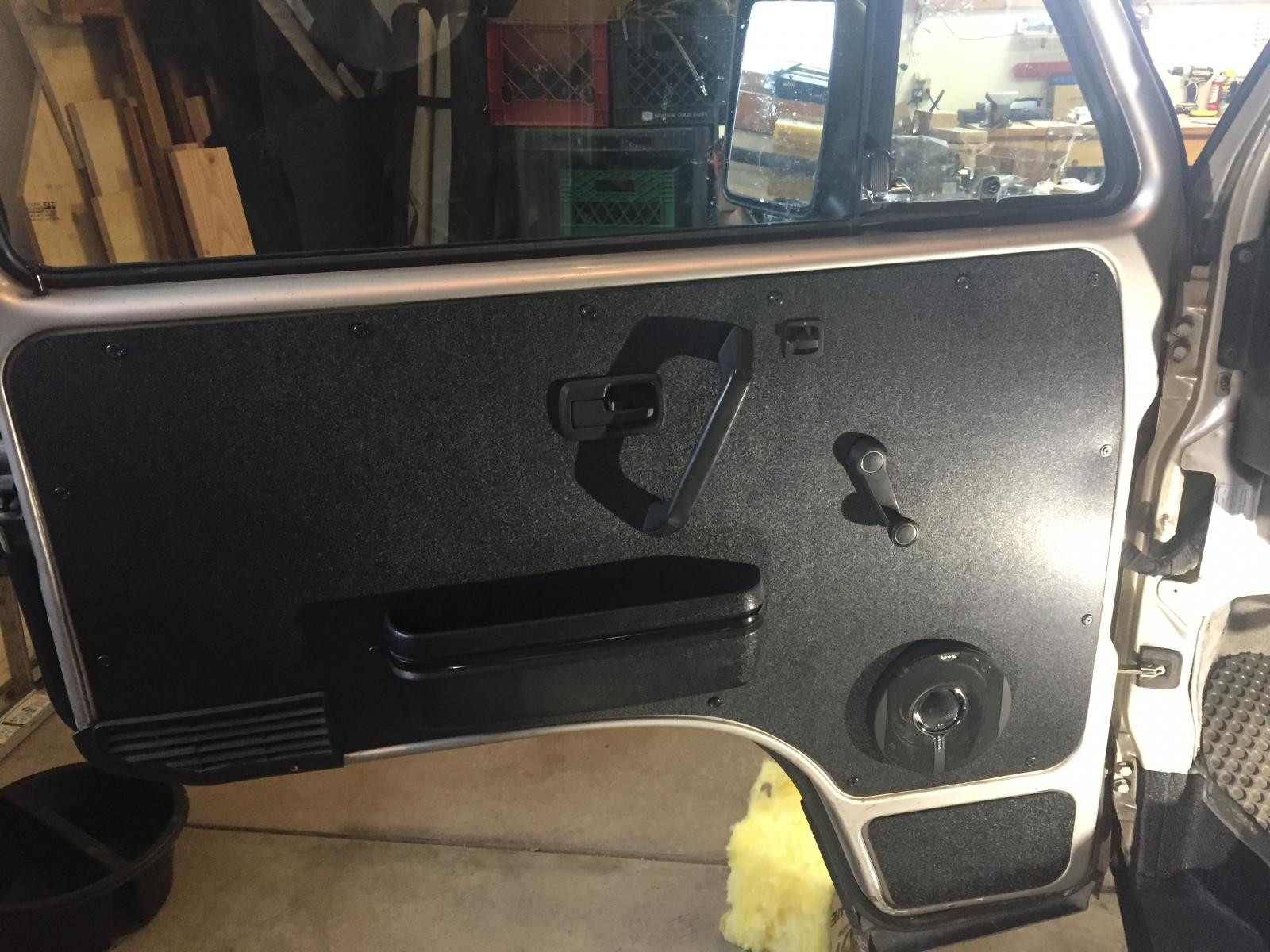

I recently installed GW ABS plastic door panels and moved my front speaker down from the original location. The speakers are 5.5 in KAPA Infinities and they sound great. Hope this helps anyone thinking about moving their speakers.

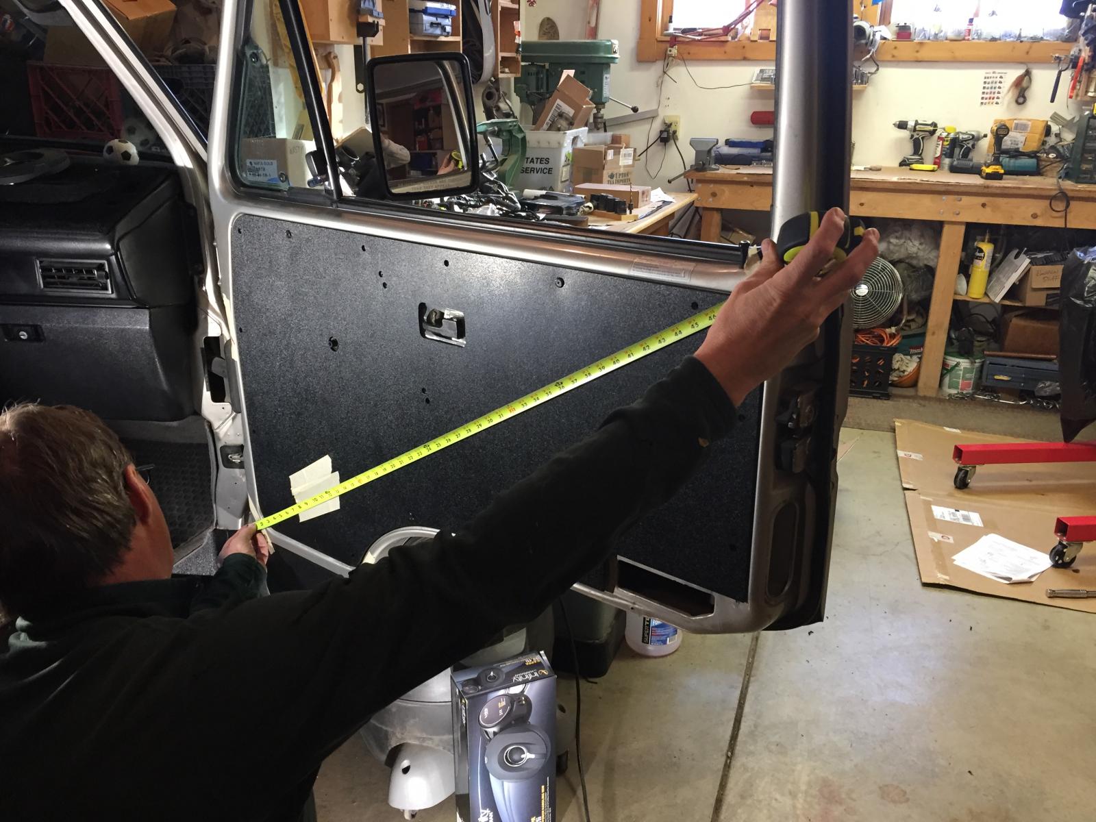

Notice the speaker taped in place with a red center point. Make reference points on the sides of the door to transfer the center point onto the panel. I then drilled a pilot hole in the panel and hung it over the speaker to see if my hole alined.
Use a tape or a straightedge to get your center.
Put the speakers in without the door panel as seen in the first pic. use tape on the actual door edges the make a X shape cross-reference. Take out the speaker and put on the panel and make your middle mark.

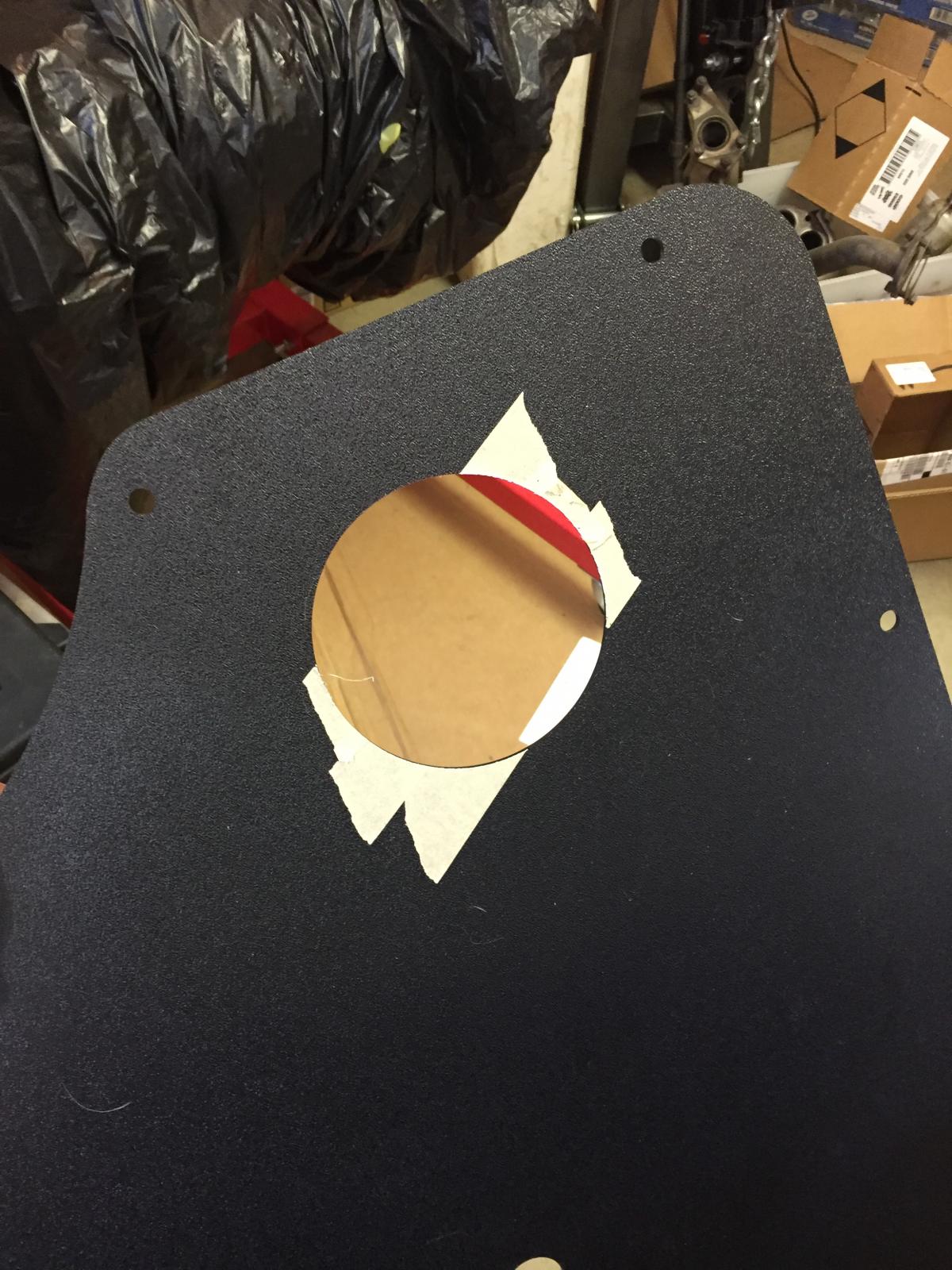

Depending on the speakers you are installing finding a hole saw that will work can be hard. I bought a adjustable hole saw on Amazon for $18 that worked great on the panels. My speakers were a 120mm hole, a hard size to find.
Before you drill your hole, make the same mark on the other panel to save time of having to redo all the measuring. I recommend checking your pilot hole before drilling though!
In order to put the speaker lower and also be able to use the window crank I had to move there map tray. This was not overly difficult. I made a template of the screw pattern and then transferred it to the new panel.
