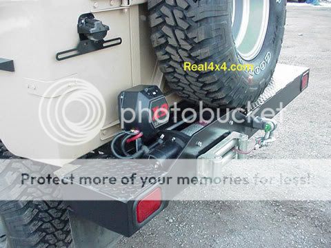

I have been trying to decide about where to mount my winch. If it is mounted on the bumper or in the old spare tire area it will be out of the way and more secure from theft but if I keep it removable using 2" receivers then I can relocate it front to rear as needed.
Mounting it under the van in the spare tire area keeps the center of gravity lower, looks stealthy, and free's up space on the bumper but I worry about water crossings, mud, and being able to reach the free spool lever and plug ins if the nose is buried in mud or rocks.
The receiver mount would give me the most versatility but can have its drawbacks as well.

My plan is to use a receiver mount in the reinforced bumpers I build, front and rear. I wouldn't need a winch for 95% of my trips but if I do it would be nice to be able to put it in either end, or possibly hook it on to another car that might be stuck and I couldn't get to it.
I think some Range Rovers had a center mounted winch with a pulley system so you could run it through the front or back. That would be pretty cool and we do have the space but you would want it set up before you enter the obstacle where you might get stuck.
You might be able to decrease the force the winch pulls using a pulley block? Not sure on my physics on that one.
I do like Das Mule's set up in the spare tire area though!
I am also thinking if you are planning on building or mounting the winch to the bumper, it's going to have to be reinforced anyway. A 2" receiver is going to be attached to the same bumper, so that's why I figure on using the receiver to mount it.
http://www.bb4wa.com/articles/Accessories-winch.html this guy doesn't like hitch mounted winches, and has some very valid points for not liking them.
I am not opposed to just a front bumper mounted winch, I just like the versatility of either end. Searching more on the internet reveals mixed results on peoples opinions on receiver mount winches. It will be interesting to read as more people chime in, hopefully with experiences with both.

The last thing I want is to haul a winch along on highway trips. I don't even have my winch mounted permently on my 4WD pickup. It's about 90 extra pounds to haul. I use it for Baja trips or southern Utah where I might need it but why haul it otherwise. I vote for the receiver mount front and rear.

Hidden winch is awesome.
Reciver mount is good move.
Keep the winch in truck until needed. I.got stuck with a buddy in a bronco had winch on front bumper Reciver and hit something in a big puddle that got us stuck plus ruined the winch. Nothing like loosing plan B in the middle of nowhere.
