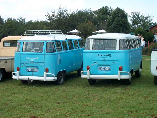

Have you ever driven a Brazilian bus Sweet Rides?
I have driven three 1975 Brazilian split buses a total of more than 300,000km and I have found the quality to be similar to German buses, in which I have driven about 100,000km. My buses were made in Brazil and shipped CKD to South Africa for assembly; they were originally sold alongside German 1975 baywindows as budget models under the name Fleetline.
I used to believe they were more prone to rust than German buses, but after driving Fleetlines for the past 15 years I haven't found any of them to be any more rust prone than my German splits. Body panel alignment isn't perfect and there's lots of splatter around welds, but those are the only quality issues I have noticed. Brazilian buses are every bit as tough and reliable as German buses.
1970s Brazilian splits are a hodge-podge of early and late parts: barndoor (pre-55) style cargo doors, pre-60 front door handles, 63 bodyshell, rear hatch with knuckle indent, 70s dual port 1600 engines with 12V alternator, etc. The Brazilian non-deluxe splits have the front VW emblem embossed in the nose, probably their most obvious difference.
There's nothing wrong with them. I have a fourth Fleetline in the bodyshop for restoration and I wouldn't hesitate to buy another one.

OK "Sweet Rides" seems like you're an expert.
Well here's our SHIT!
It's a '63 Brasilian original condition, 43 year old and still hanging together very well thank you. It has panels and fittings made from the same superior German presses and dies that you so admire.
When VW set up the factory in Sao Paulo they bequeathed some of the obscelete equipment from the German factory. They even went to the extent of exporting some of their workforce and a whole lot of their expertise to ensure the usual high VW standards were set in place for the new venture.
There was already a large ex-pat Germany community around the area of the new factory and the new German immigrants were made to feel very much at home. The quality control was carried out by these German immigrants and they in turn passed on their expertise to the local workers.
So you have second hand experience of a Brazilian Kombi, and it was a rusting shitty hulk. Well whoop de doo if I had a £ for every rusting shitty hulk I've seen, (German, South African, Brazilian) I'd be a rich man.
Sweeping genralisations are usually uninformed at best. I don't expect to change your mind but you've got to see a lot more Brazilian Buses before your opinion carries any weight with me.
John, I`ve been in the U.k bus scene for 14 years, I`ve personally restored a "Vanfest Show Winner" with all the work done by myself. Which I brought back from a rotten wreck from Sweden using only og parts.
(This bus is the 66 double door green/white SAMBA, now B.W.A bus with turbo motor now owned by Ronnie)
I`ve also restored numerous splits for other people and a have owned dozens of buses over the years.
So now your a little better informed on me, I`ll correct the statement which you reported I said, and didn`t...
I didn`t question the quality of the presses or parts used on the Brazilian buses. I actually use many Brazilian parts myself at the moment as I think, in some cases, they are of superior quality to the German parts - this especially applies to the current Gearbox mounts available.
I have had a very close look at well over 20 Brazilian built Fleetlines over the past 14 years and have not had need to question the quality of the parts on theses buses. Where they do, quite undisputedly, fall very short of the German Splits is in the build quality/quality of finish departments.
If you park up 2 buses of the same year in the same condition, one Brazilian and one German, the differences become apparent very quickly, even to the untrained eye.
But, you get what you pay for. If you`re after a cheap split then maybe a Brazilian bus is the way to go for many people. As I said before, like for like you could buy 4 Fleetline 15 windows for the price of 1 German one.
Although they would never be a vehicle for me, the factor of cost may make them a very appealing way for people buying their first split, to get into the scene without having to remortgage their house!
