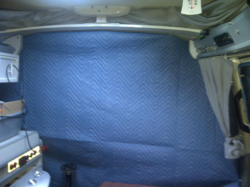

In my bay window I used big magnets and a blanket. Mostly to contain heat in the front. probably less elegant than what you are going for but it worked well. _________________ '77 Bay Window / '89 Caratsburg (aka. the Stormtrooper) |

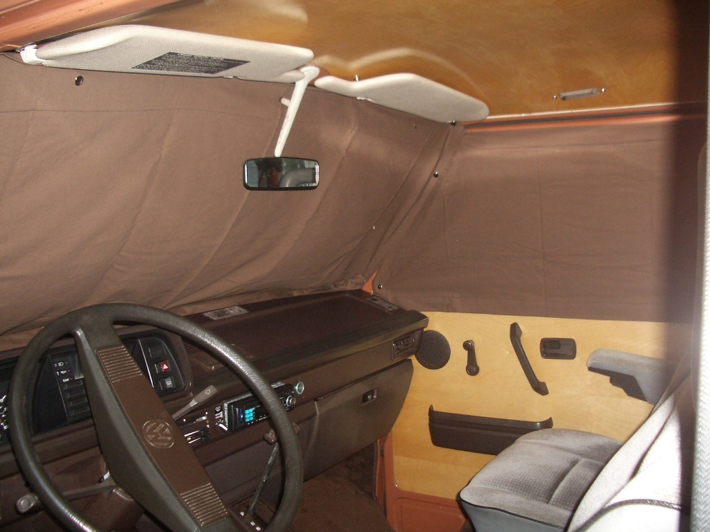

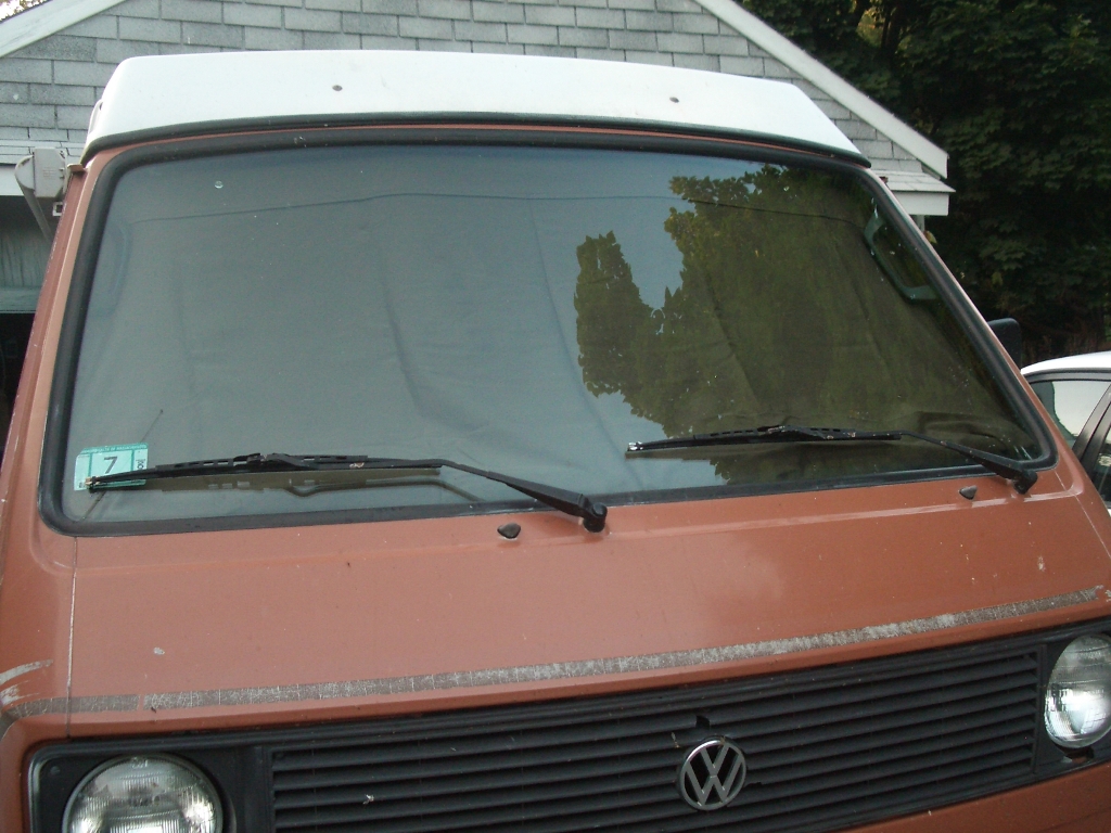

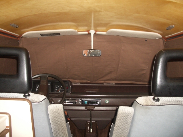

I initially installed a track, and made a curtain with a contour to match the roof line. It was one piece, and I would slide it behind the drivers seat and tie it back when not in use. Really easy to use, and readily available (thus used). I got the track from a newer model Westfalia, and carefully bent it to match the roof line just forward of the pop top opening, and screwed through it with some really small screws.
I now have a snap in curtain that goes there, but is stored when driving, making it less handy. However, the same curtain has additional snaps that match the snaps that I screwed in around the windshield, and it is a nice tight fit against the glass, with the excess rolled up in the angle of the windshield and dash. That combined with snap in curtains on the side windows replace the bulky factory front curtain that was useless at keeping out the light, and at night with the lights on served more like a one way mirror to look INTO the van. It also make the cab feel much more roomy with the curtains drawn.
In the cold weather, with aircooled heat being precious, I have the curtain in the middle when driving, until I have plenty of heat, and then I can just unsnap it with a little tug.
I don't have a photo with the curtain in the between cockpit/cabin position, but here it is mounted in the front:

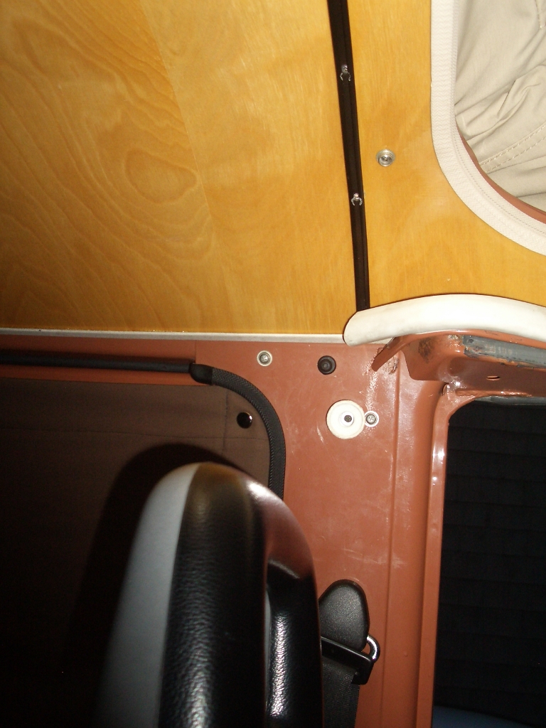

I removed the screws at the rear of the headliner and replace the screws with screw in snaps, and made the curtain to match the snaps, and added some small bungie cord (actually tent pole elastic) in the hem above the snaps so the curtain would suck up to the ceiling. Also with the elastic, the position of the snaps on the curtain did not have to be a perfect match to the screw in snaps. _________________ 1987 Syncro Westfalia, stock (bought 1994)

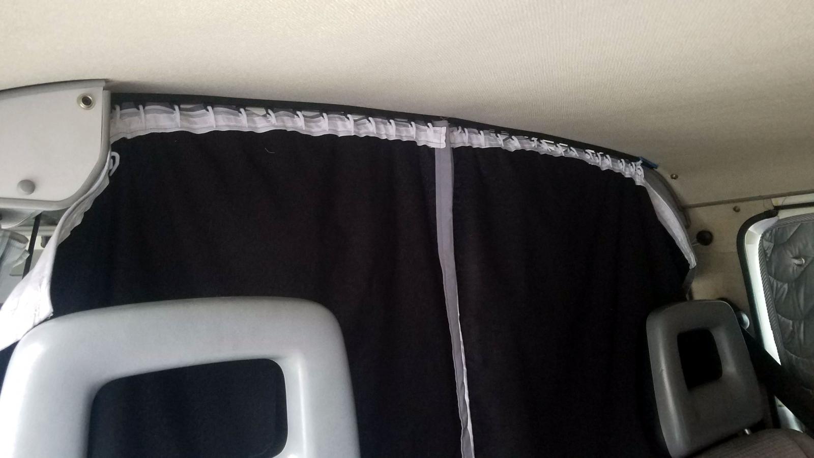

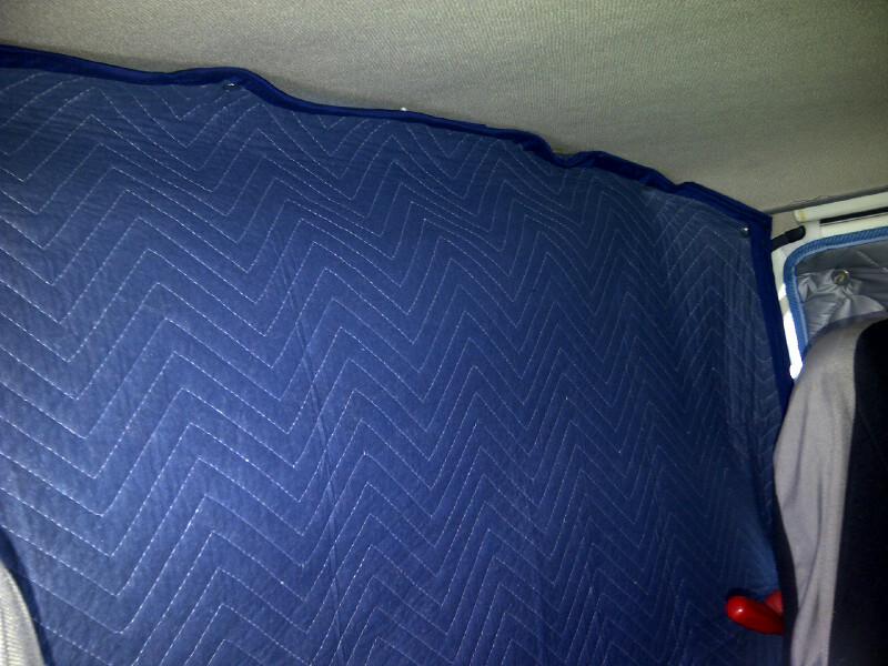

The curtains are "3-ply". The outer layer(what you see outside) is green plaid, the middle layer is a sheet of "bubble-wrap" insulation, the inner layer is this red/gold pattern you see here. These are thick curtains and cannot slide horizontal like the factory curtains, so I roll them up vertically and use tie straps to secure them. With all the curtains down and the drapes drawn closed, the interior is complete darkness even in midday sun, greatly reduces solar gain and keeps it a good 10 to 20 degrees warmer inside when cold outside. To keep the curtains from moving when down, I put several magnets lining the bottom and sides.
Here's a picture of the tie-backs used to hold the curtains up when not in use:
outside view of curtains, green plaid material:

Actually, this is a great idea! Craft a curtain to fit the opening, add loops (w/ velcro if you like), then string a dough-nut type of magnet through each loop. When not in use, just fold up and store behind driver's seat - easy up, easy fold and away. _________________ 89 Westy

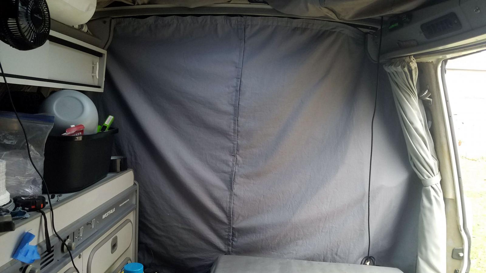

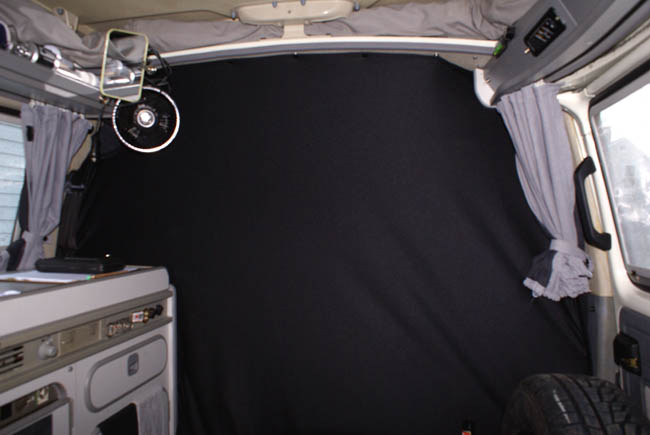

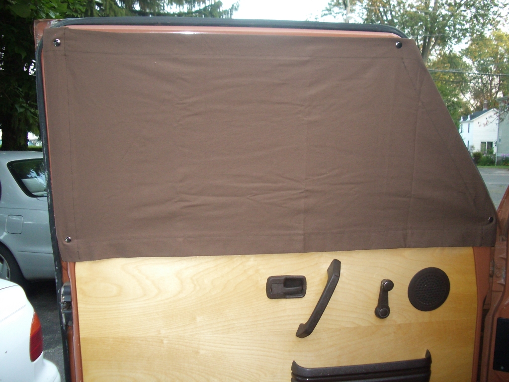

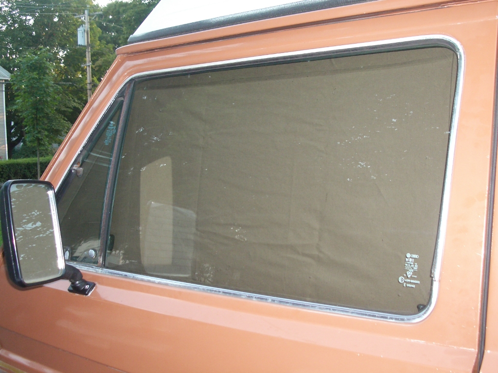

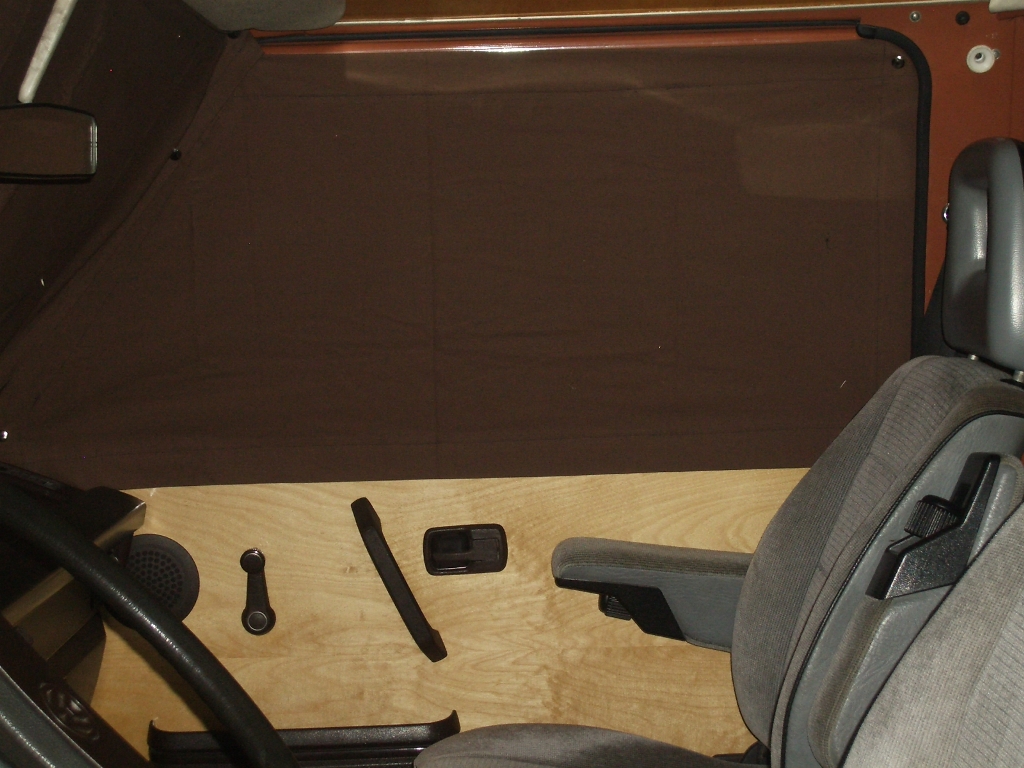

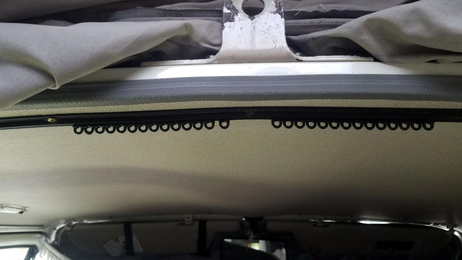

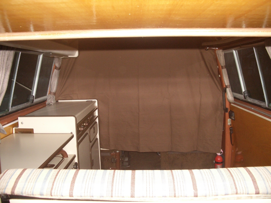

I made them myself. The front curtain doubles as the middle curtain: that is what the extra snaps you see are for. The excess is just tucked away at the bottom. I, too, did not like the idea of privacy curtains being only adjustable to everyone but myself. I also did not like the way the stock curtain hung inside the cab away from the doors and windshield. These are right up tight to the windows and windshield, making it feel more roomy. Here are some other pictures of the set up, as well as the track that I took off another westy and used for my first curtain just behind the front seats.
Exterior view:
Interior view:
Curtain in middle position:
Curtain rail (no longer used, but in regard to the OP's post)
