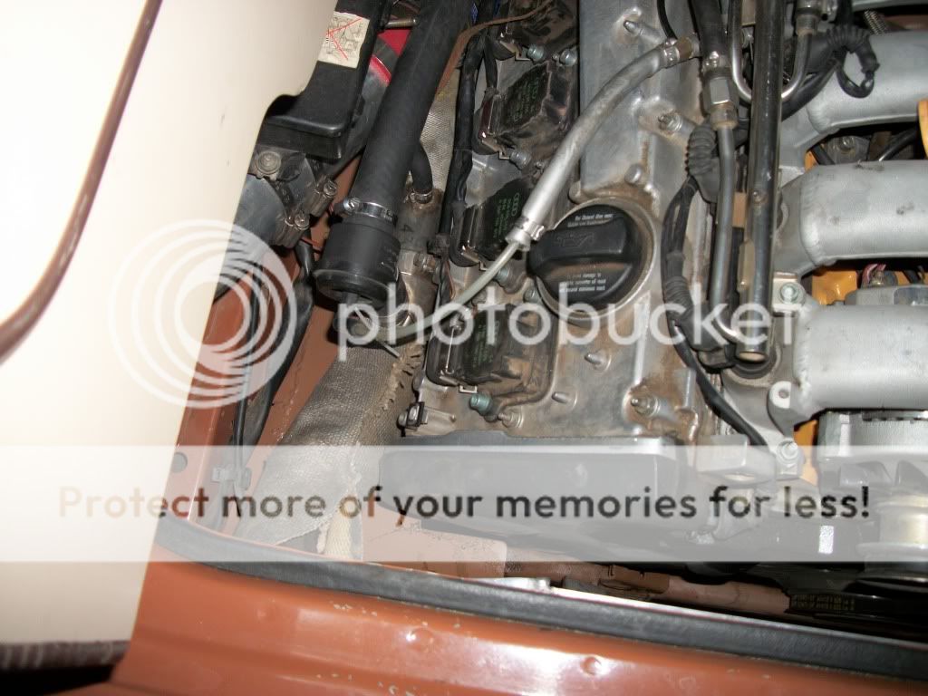

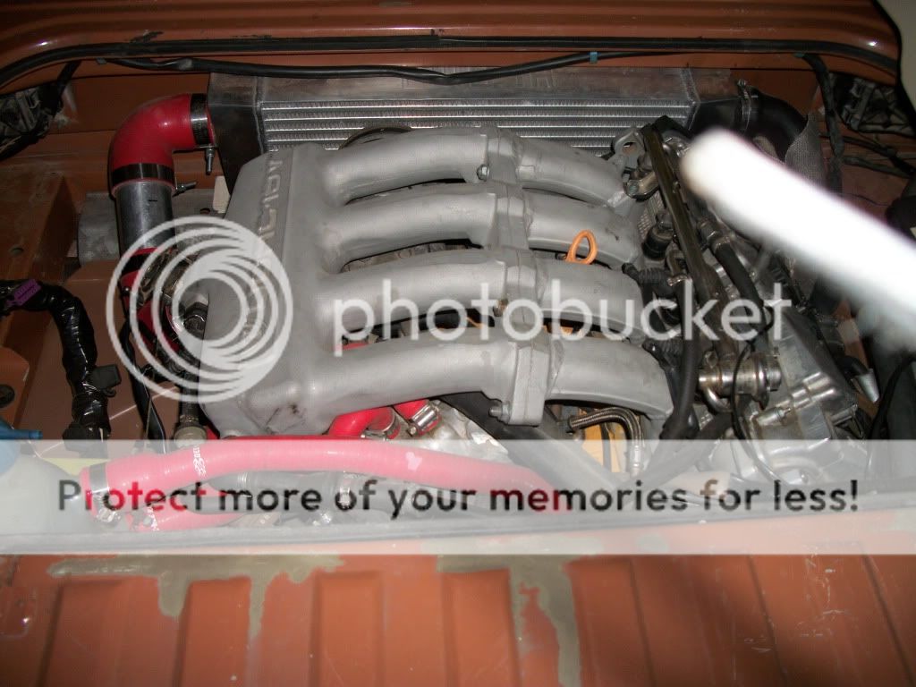

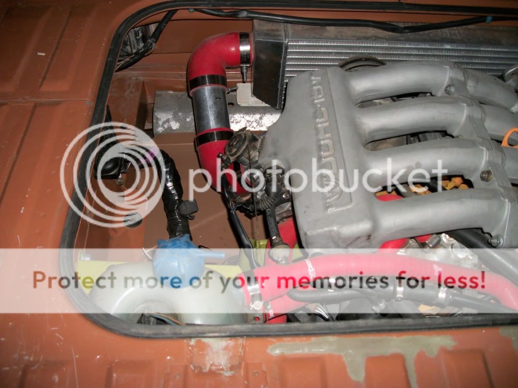

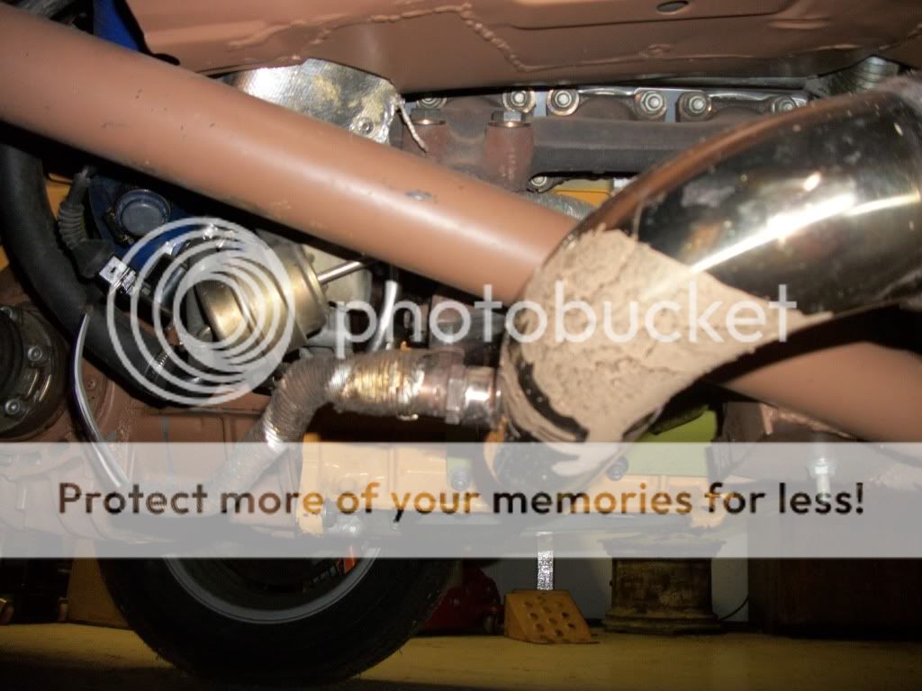

Finally Finised the Swap!! Been running for a week now. Lots o Torque and plenty HP!

What was the most challenging aspect? This certainly looks like a "one of a kind" swap.
This is your build thread?
http://forums.vwvortex.com/showthread.php?5083773-...4a409c613f
Did you weld the intake runners? If so, any chance you did it with MIG?

I just saw your update on The Vortex. Nicely done! It's a packaging masterpiece. One question. Could you achieve the same intake manifold results by joining two AEB intake manifolds rather than an AEB and a PL?

But what about the oil pan, there is no modifications on it to fit on the engine block??? I can't see anything about this on your pics.

jabba wrote:
Wow! Very clean job on this engine. Congratulations!
Very much diesel oil pan indeed.
He used an early 1.8T based on the EA827 block, so the diesel oil pan and pickup tube bolt right up.

[quote="jabba"]Wow! Very clean job on this engine. Congratulations!
But what about the oil pan, there is no modifications on it to fit on the engine block??? I can't see anything about this on your pics.[/quote]
The AEB and ATW 1.8t's are based on the 058 block. which goes back to the 1600 rabbit motors. in 2001 VW went to 06A blocks and every accs is diffrent. AEB uses all early parts. oil pickup pan bellhousing, pulleys are earlier parts. DClymer in my opinion, you would need at least 3 AEB manifolds. not the later manifolds B/C they have a smaller port size. i felt the 16V gave me the length, size and a flange i can buy a gasket for and remove there to get at the Alt. and A/C.

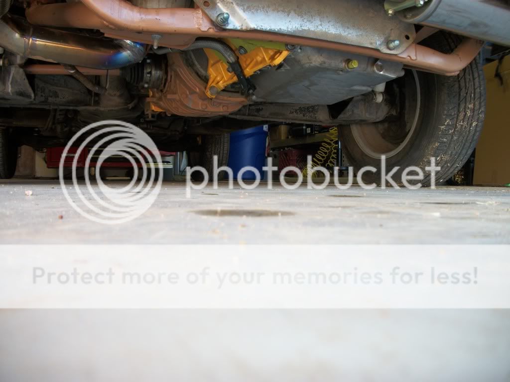

Looks great, 50* is the way to go, how's the ground clearance? I was looking at this on the vortex too.

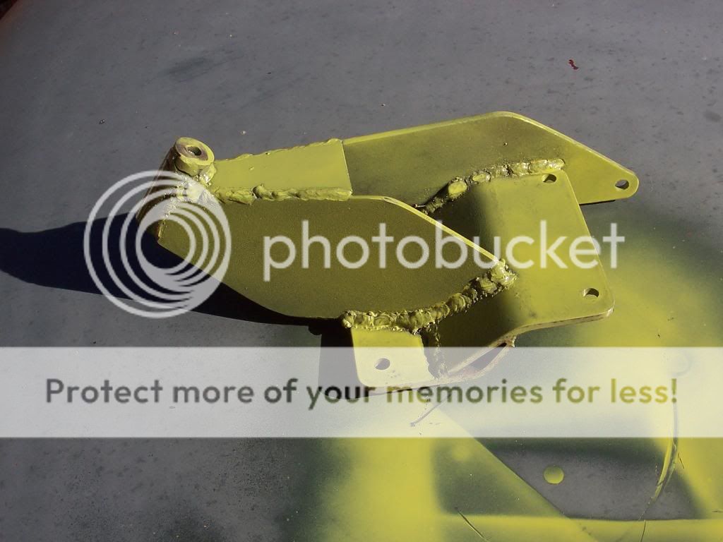

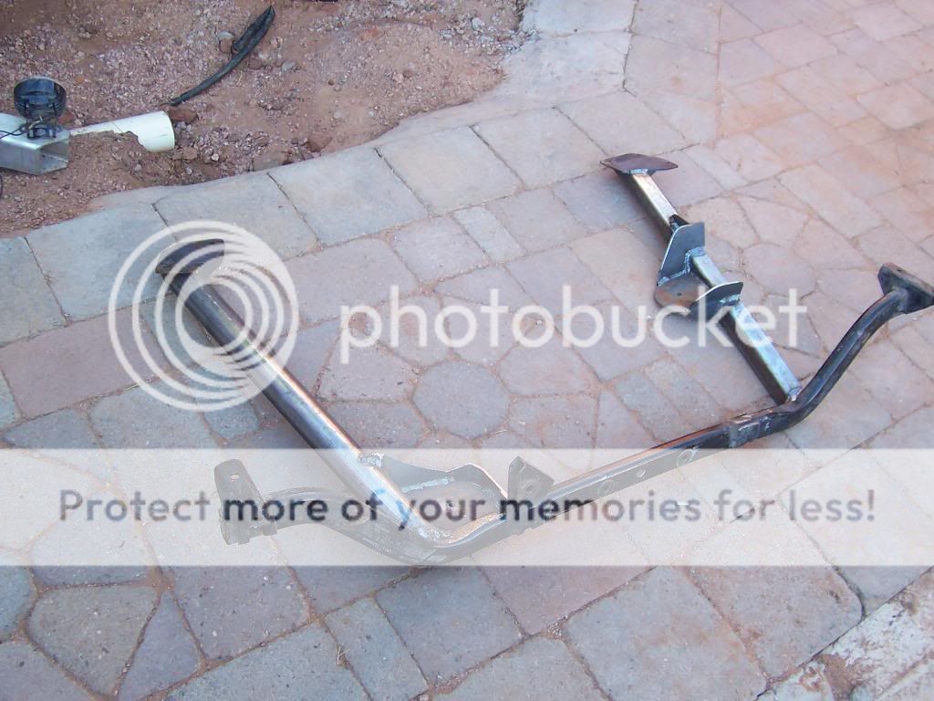

I was able to get parts from my Rabbit parts and the donor Passat.

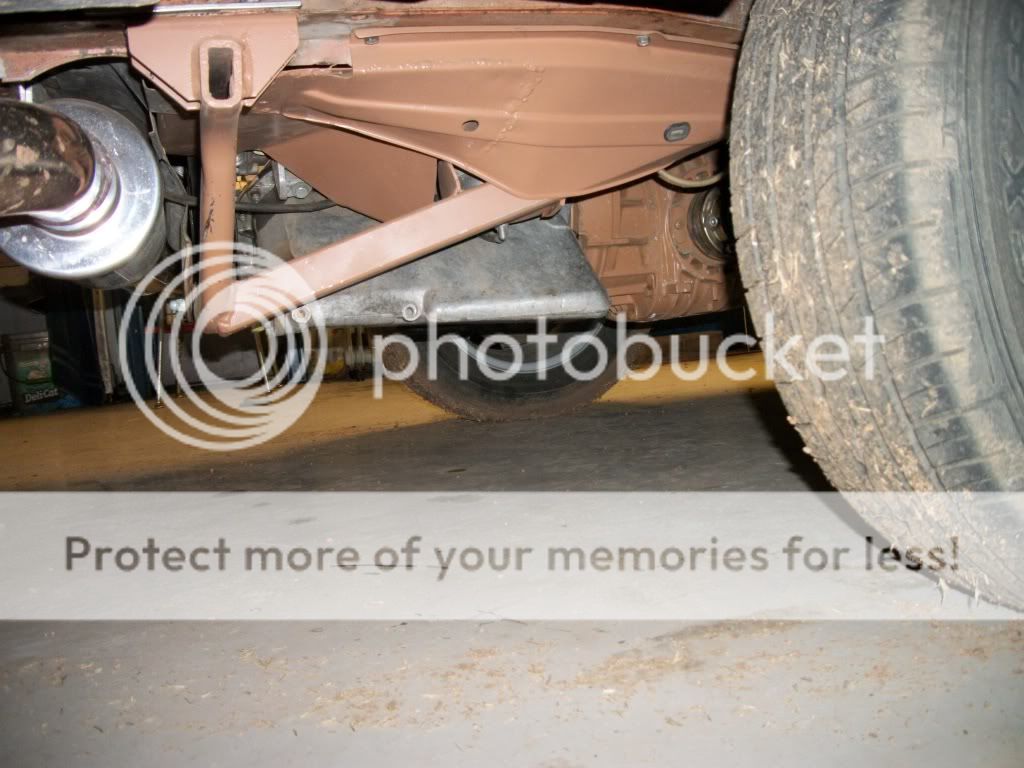

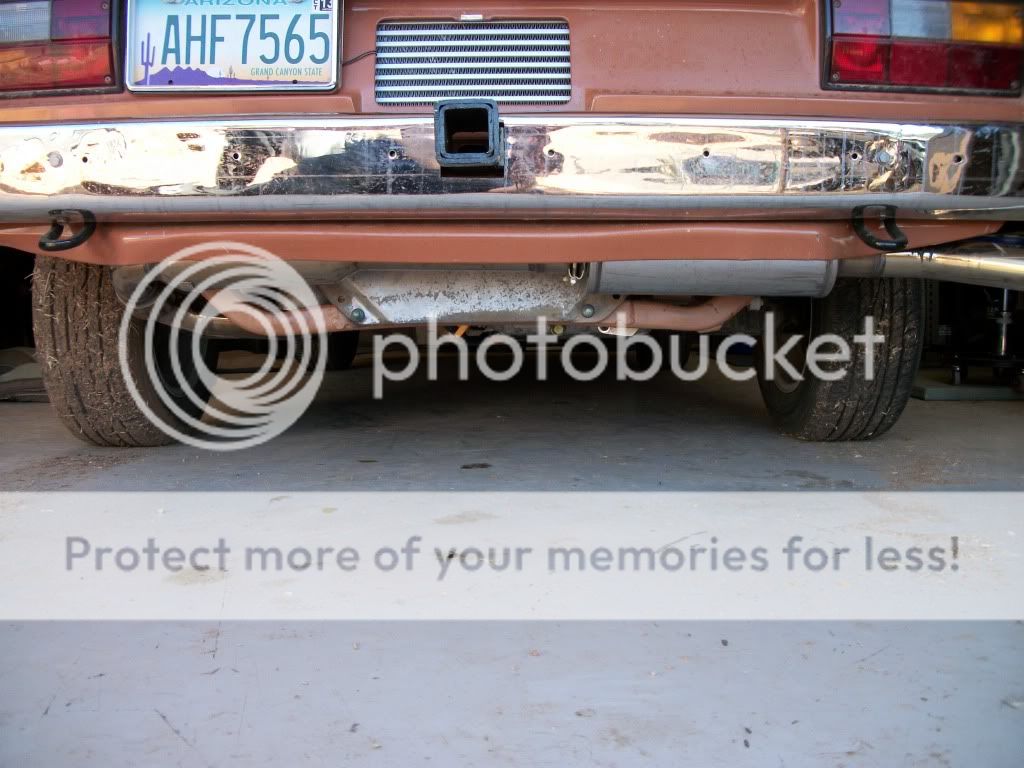

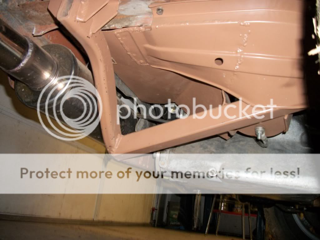

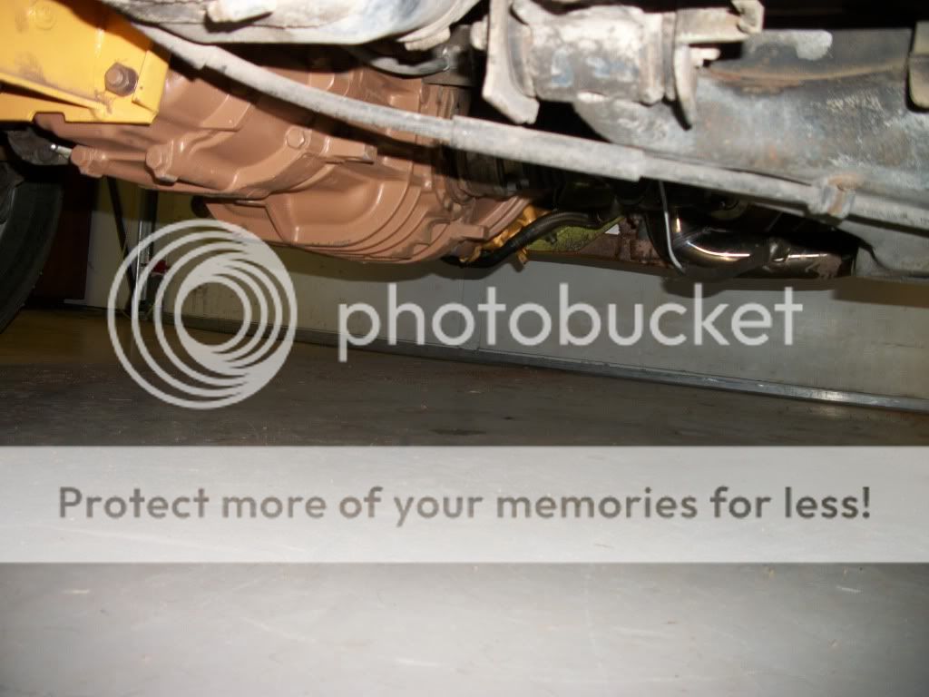

The biggest head ache was the engine cradle! i started w/ VD Bars i was amazed how much Flex they had w/ the engine in place . I could push on it with my Hand and feel it moving alot. the rear panel on the vanagon is really thin and Flexible. When i bolted the I/C mount there was a slight bow in the rear that dissapeared as i bolted (4x 8mm) it up. Now its Flat! So i used the mustache bar and the front VD mounting points .
Like this!
this one holds ALL the weight!
Shocked Laughing
Clearance same as VD. did not lower the transaxle! Exhaust is higher than stock. nice departure angle. Brown Vanagon

PostPosted: Fri Jan 20, 2012 7:51 am    Post subject: Reply with quote
I really like your mount design. Using the moustache bar for the rear attachment was wise. I've always been amazed that VW attached to that flimsy rear member without reinforcing it.
If you ever want to produce more of those mounts and bars to sell I'm sure you'd have lots of customers.

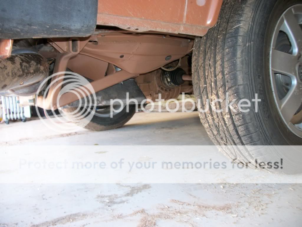

I would like to know ground clearance AND height of wheel center off ground. This will tell us how far below the wheel center the ground clearance is. That way it matters not what size tires are being used.
for example, my wheel centers are 14.5" off the ground, and my ground clearance is 11.5". That means my conversion hangs 3"!!! below my wheel center.. Im hoping you did a lot better.

The originally diesel vans have reinforcing plates welded to that rear member where each carrier bar attaches. Even some aircooled bodies from mid 81 have them as those bodies were changed to allow either engine when diesel production began in 81 models. Waterboxer van bodies mostly don't have them though a rare few do. More have it just on the pass side with the PS tank bracket bolted to it and sometimes welded to it.
The early TIICO kits had durability problems with the rear crossmember attachment points and TIICO eventually began providing the diesel type reinforcing plates to people who asked.
Mark

Yeah, I've seen the mounting plates welded to the attachment points on diesel vans. It looks like the WBX vans have only two of the four holes at each attachment point with the other two being part of the reinforcement plates. Correct? I've just always been surprised the length of the beam itself wasn't reinforced. It seems like it would be a NVH amplifier. It must be fine or VW wouldn't have used it. But what the OP said about the flexibility of that area concurred with what I've seen.
D

Yes, each three holed diesel plate welds on over 2 existing threaded holes and provides a third new hole at the top.
My point is to make people aware that attaching to that flimsy member requires additional strength, as recognised by VW when they did it and as found out by many conversions that failed to do it.
Mark

I could make these mounts if there is enough interest in them. Brown Vanagon
On the Ground Clearance issue. we should be measuring from the van Floor to the bottom of the trans and to the bottom of the oil pan. Not from the ground! every van is at a diffrent ride height and tire combo . the only consistant is from a fixed surface not the soft suspension.
I will do some measuring and picture taking over the weekend.
