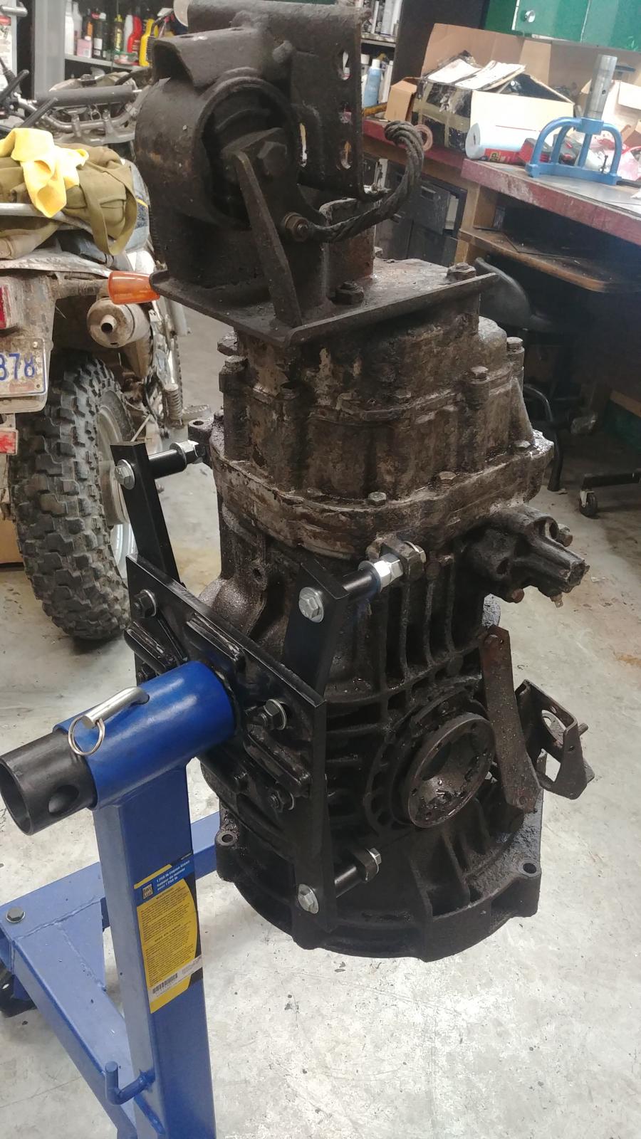

What do you guys recommend for a transaxle stand for a trans rebuild? Do they make an adapter for an engine stand?
Or would this be a better option?
https://www.amazon.com/Original-Tubster-Extra-Larg...&psc=1

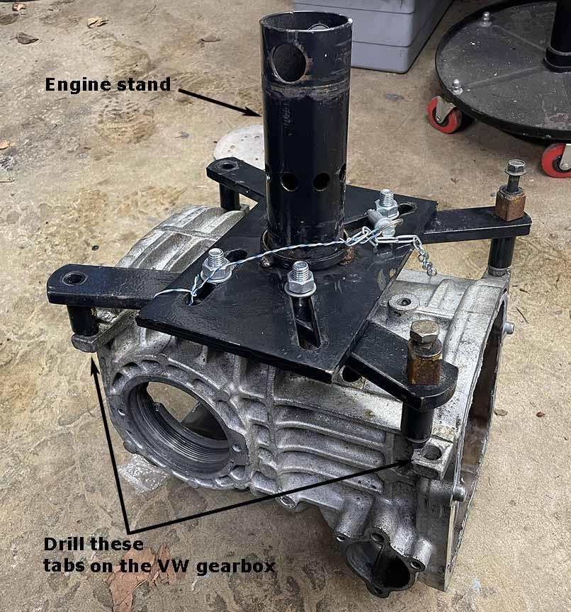

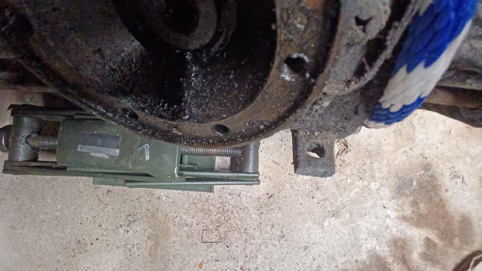

I built this for a friend, laying on my back, under the van....
Luckily it turned out to work very well in the shop!
Note those four nubs that this unit grabs onto.
You can drill holes in them and bolt the four arms of a 'normal engine stand' to the gearbox case.
That's pretty easy way to do a seldom gearbox job.

I really like that mount idea, which grabs those tabs. I think I can fab that up. I will also add a stub in the middle to fit into my floor jack.
I'm trying to find the trans code. I broke the locker thing off when I pulled the trans. I was on my back & didn't realize how heavy it was...
You can drill holes in them and SIMPLY bolt the four arms of a 'normal engine stand' to the gearbox case.
It's a harbor freight engine stand, a drill bit and some bolts.

I just checked - the 2 tabs on the left (passenger side) are already drilled - cool

Hey thanks for all the input. I'm going to get this transaxle outside for a thorough cleaning, and drill the tabs for my engine stand. I've already reached out to GT Gears to get some parts moving this way. I will be getting his slider hub, and plan to get his 0.925 4th gear to replace the factory 0.85.

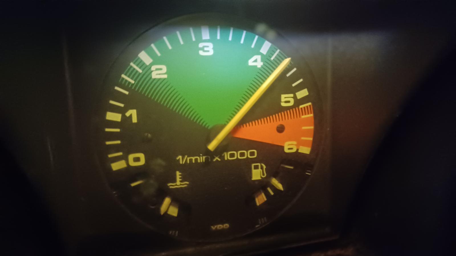

Driving in 3rd at 60 MPH @4400 RPM for 2+ hours I realized that the OEM 4th is just too tall with my 29" tires. I'm not sure what cam is in this mystery 2.2 wbx I picked up a few years ago, but the engine really wakes up at that rpm.
when I did that, I was shocked what a big pile of aluminum I has after drilling those holes.

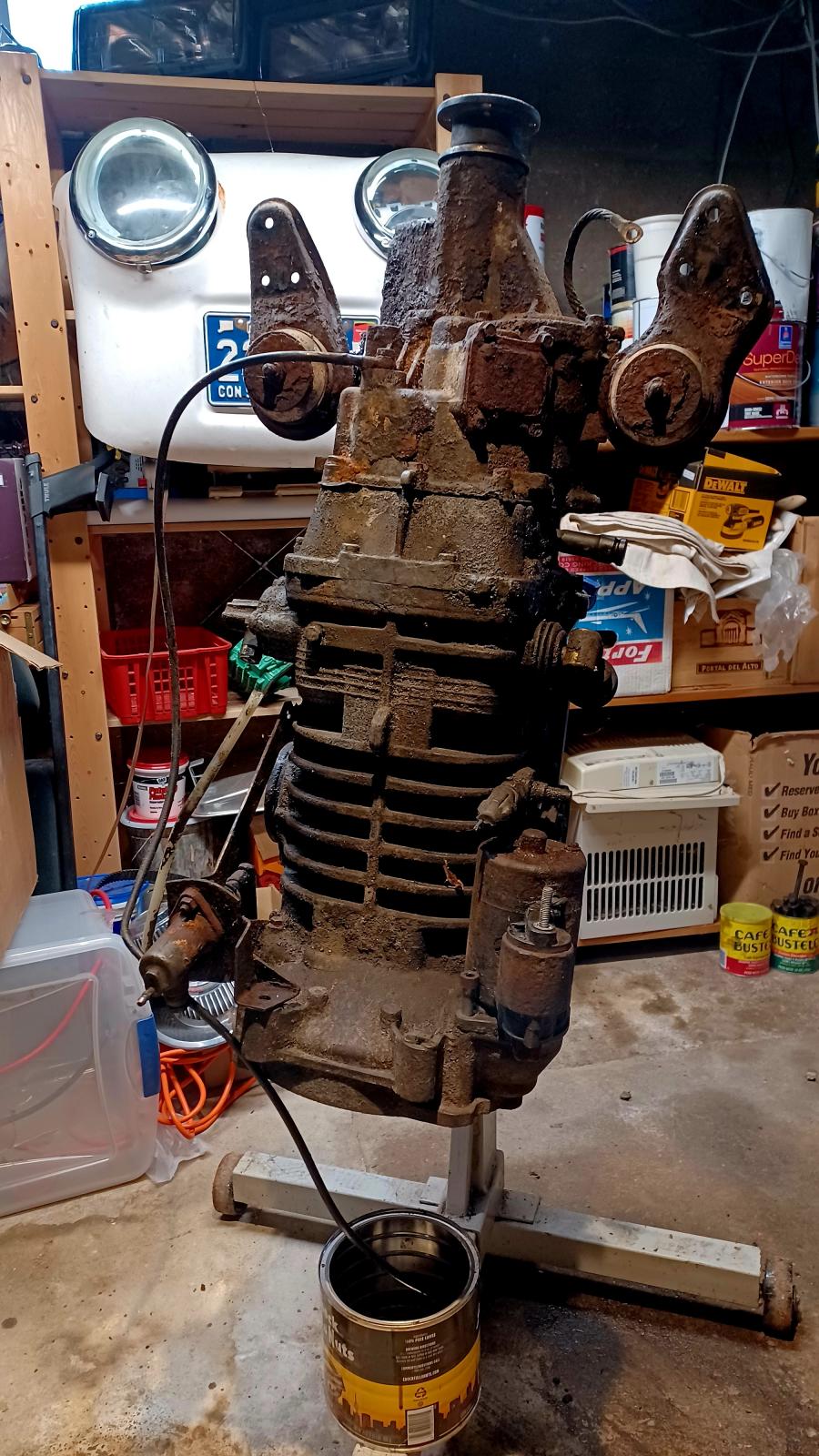

The drilling of the tabs for an engine stand worked out perfect. I have it in my basement.

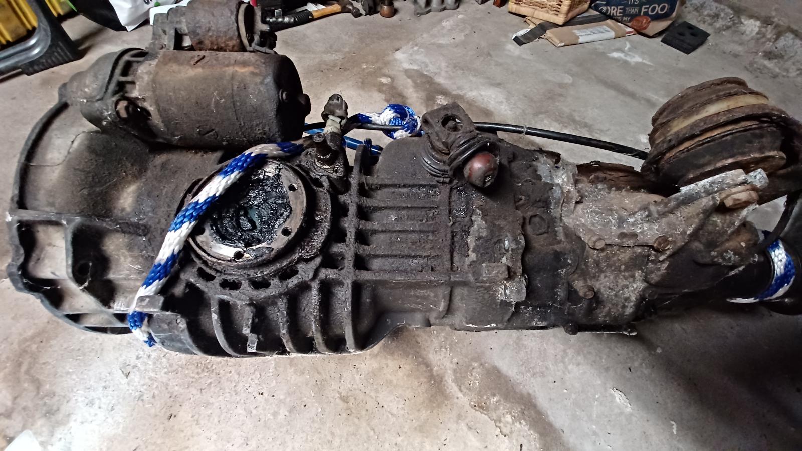

What is that just behind the starter? (above).
