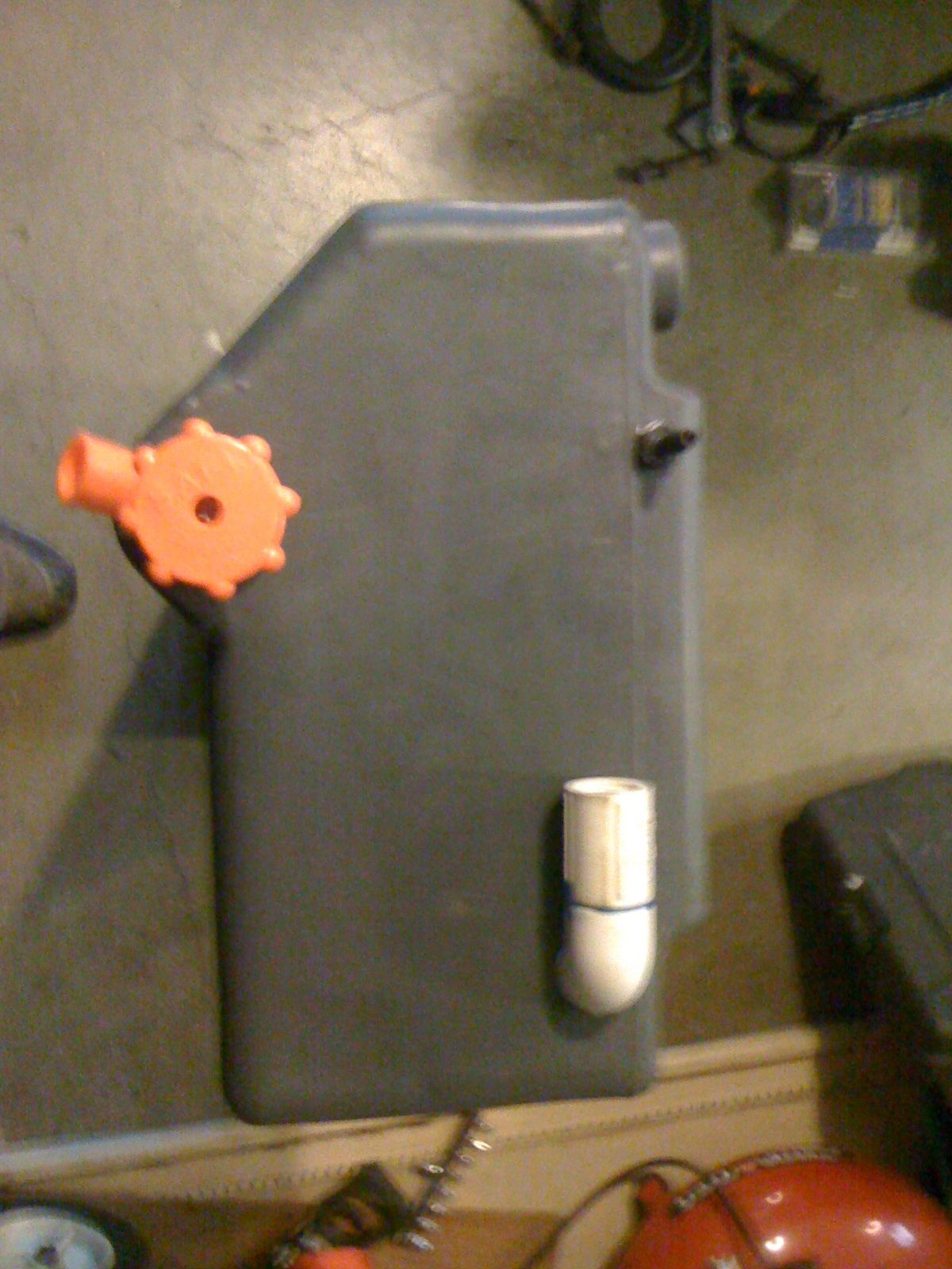

I mocked up my grey water tank this weekend and took some pictures to show how I did it.
The grey water tank from Eurocampers(sorry about the blurry pic)
The tank does not come with a drain spout installed so I drilled a hole and threaded the nozzle in(with teflon around the threads) I added the inlet out of pvc and added a nipple up high for a breather line. I drilled the hole for the inlet two close to the edge which is why it is facing the wrong way. I will route my flex vinyl to that.

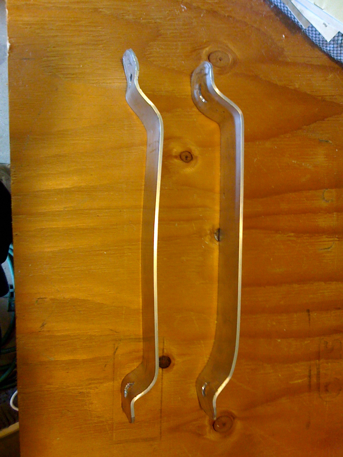

I cut the 1/8 aluminum bar to slightly larger then the width of the grey water tank. I used a hacksaw to cut it and rounded the corners with a bench grinder to try to make it fit better. I drilled two holes into each piece and then strted test fitting. I wanted the braces to be as tight to the tank as possible so I would bend the aluminum bar using the vice, test fit, bend, test fit, bend, till it was finished.
The support straps after bending.

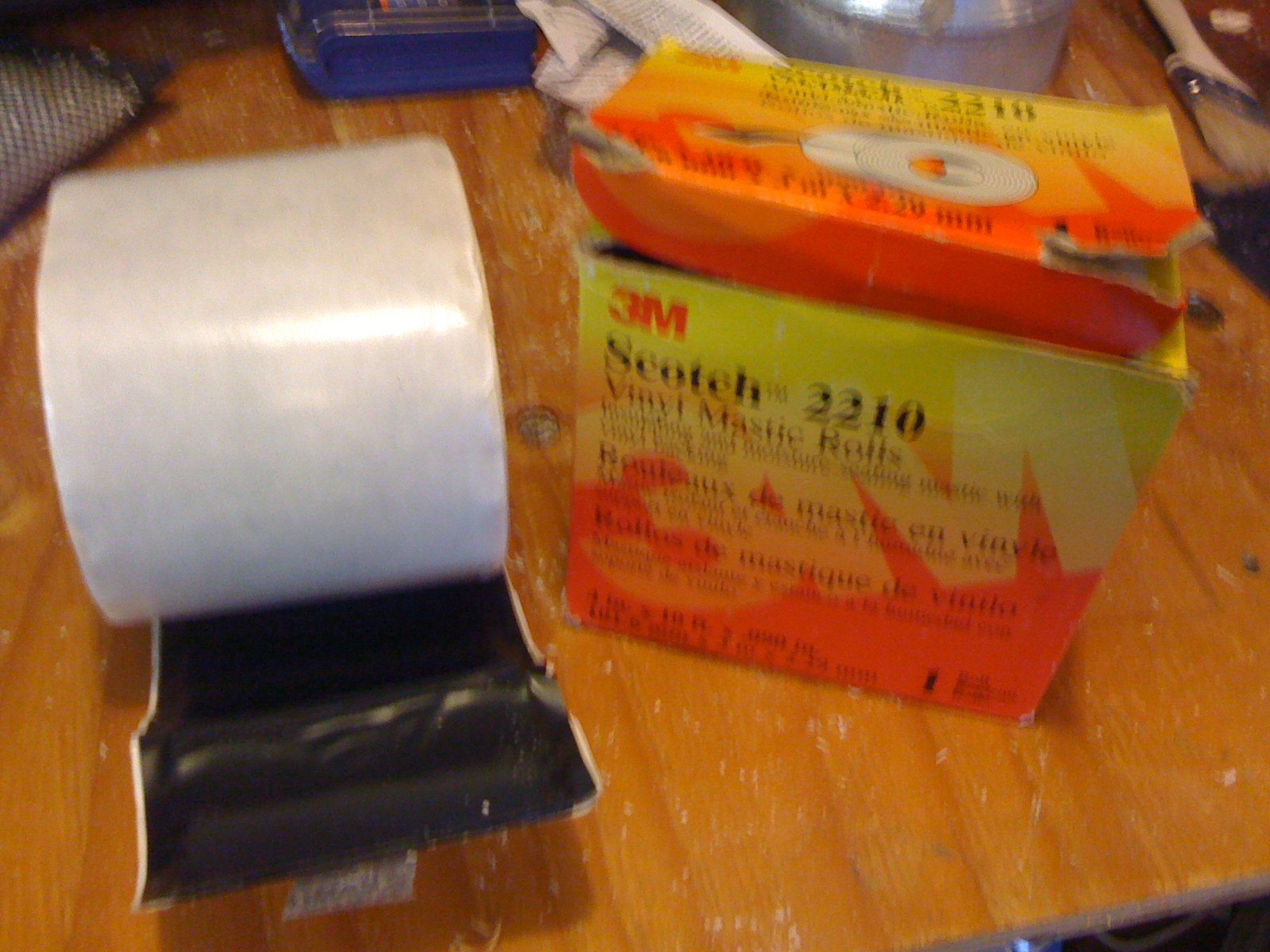

I had a box of 3M vinyl mastic tape for putting on my syncro stainless fuel tank straps so I stole a little for the inside of the support bars.

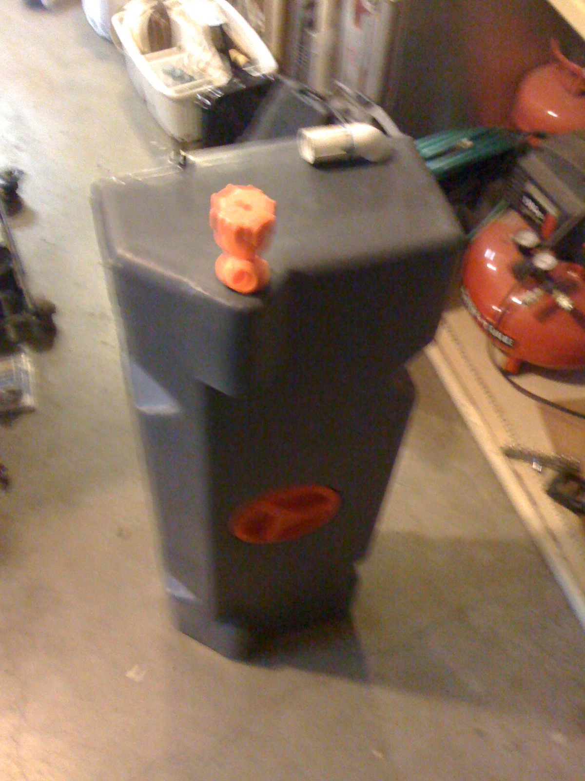

A finished shot of the tank hanging
A pic of the finished hardware.
