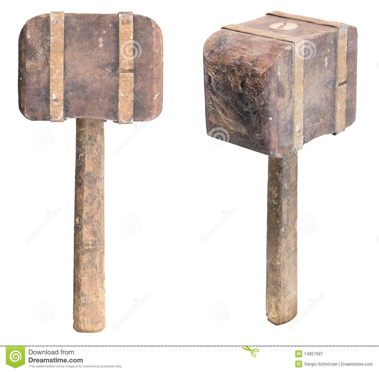

I've had pretty good success with one of these.
Laughing

Thanks for the advice I got this hamer out off mine cave.
I sprayed WD-40 and let is sit for one night, and it came loose, thanks.
