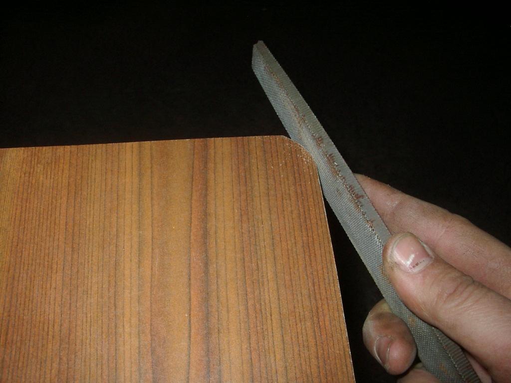

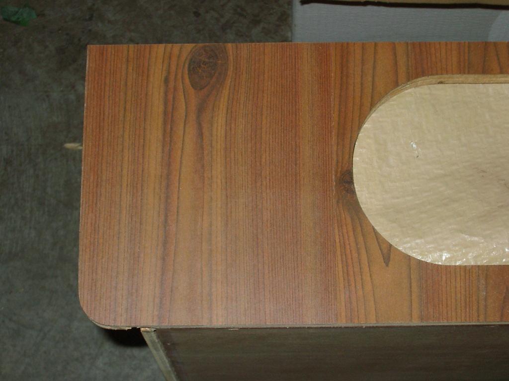

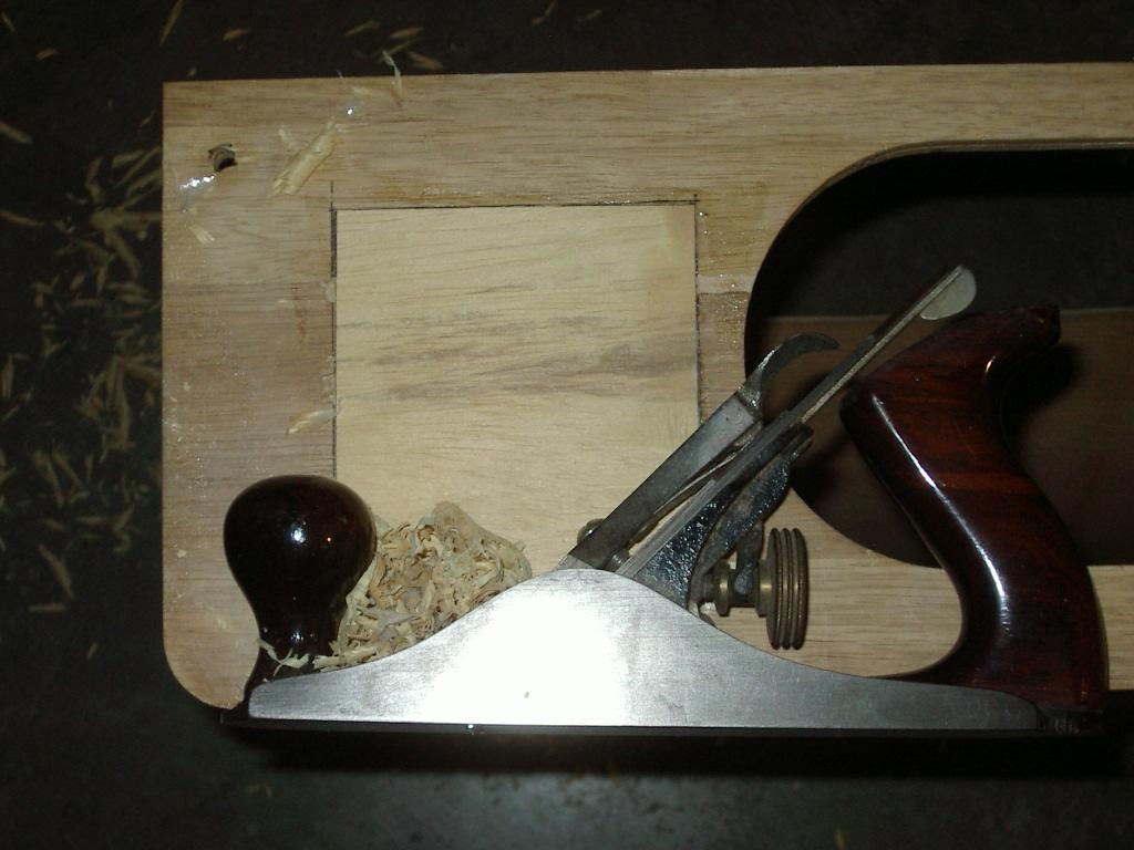

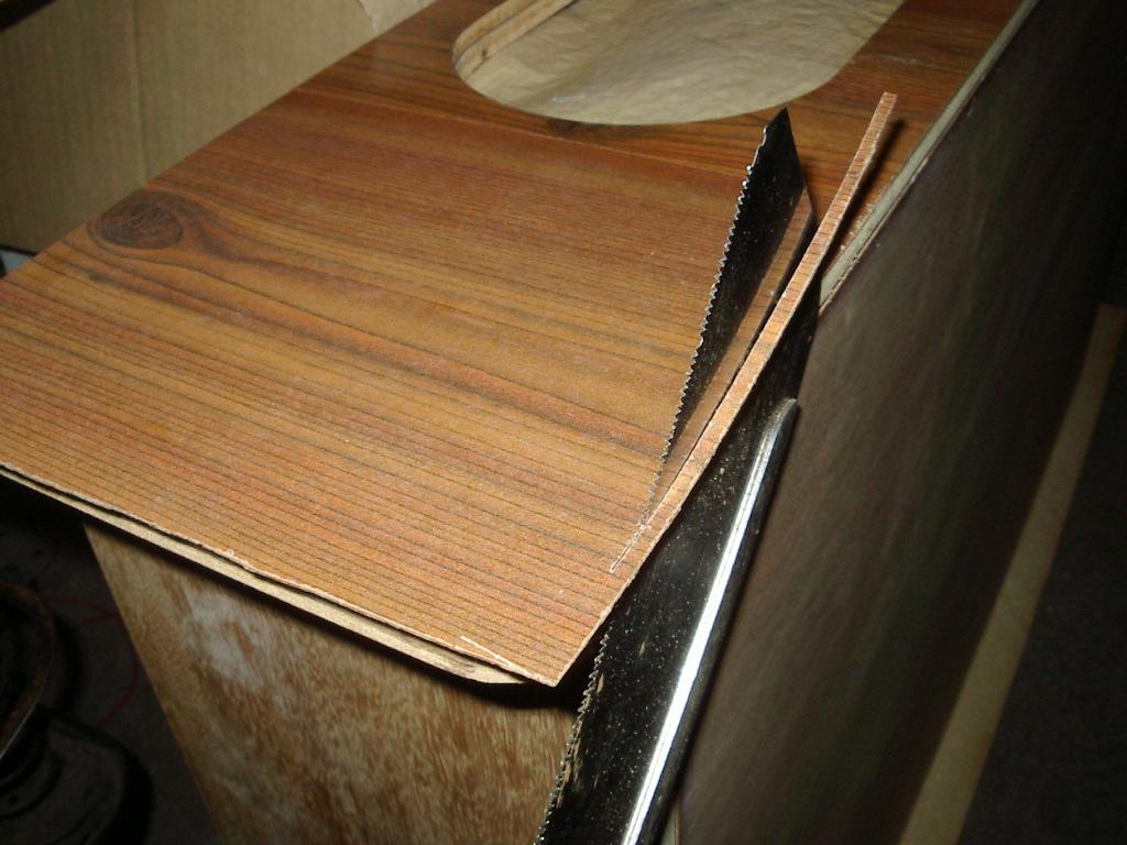

A brief guide to repairing damaged cabinets or parts
A brief guide to repairing damaged cabinets or parts:

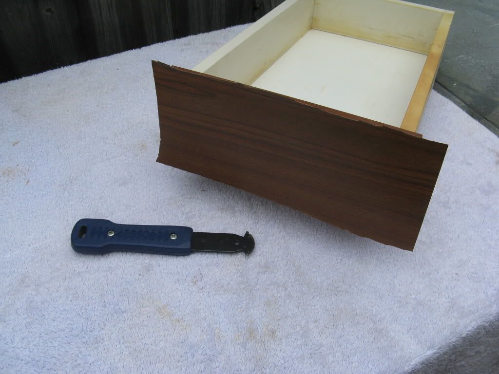

#1 I purchased a mid 70's cabinet for my 69 bus.
#2The laminate was broken off the drawer.

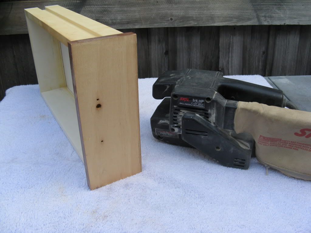

#3 Remove old laminate with a belt sander

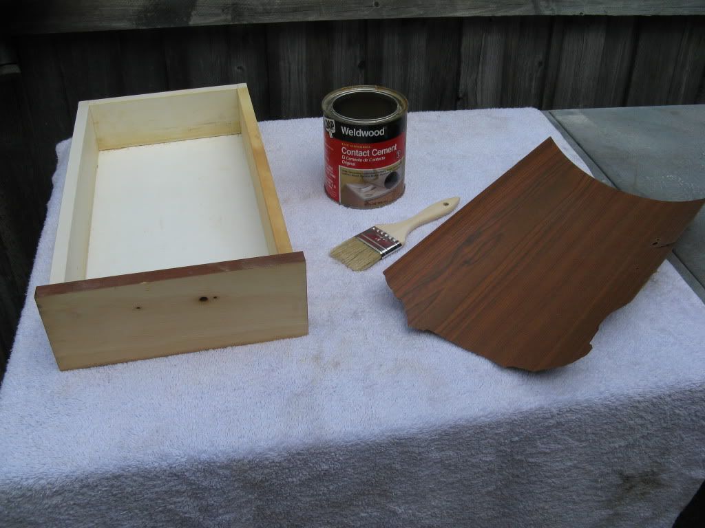

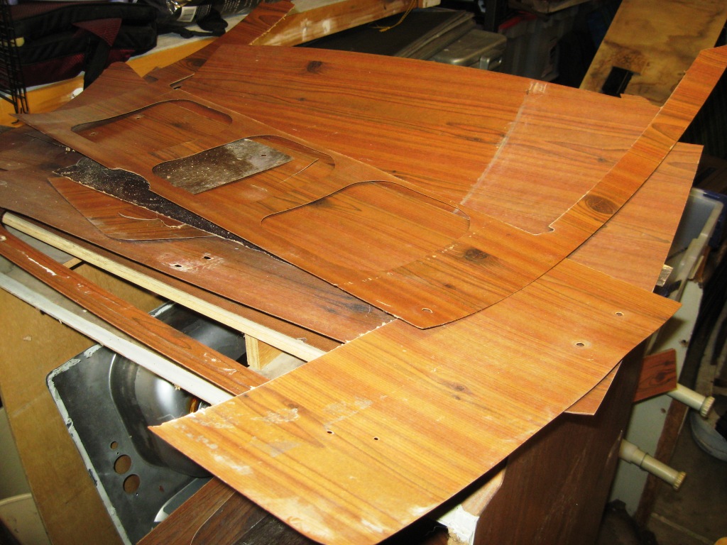

#4 Materials - cleaned drawer, recycled laminate (thank you samba member Tom S. of Stanford CA), contact cement & disposable brush.

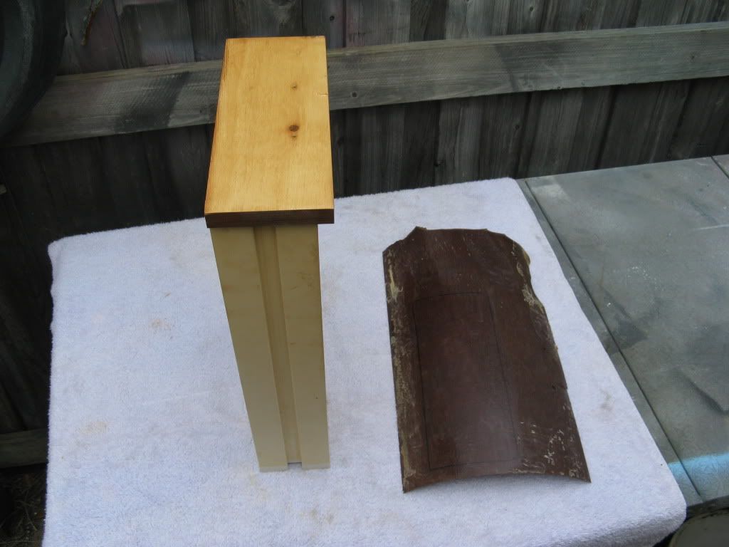

#5 Contact cement evenly spread over BOTH surfaces....let dry 20 minutes.
#6 Laminate glued to drawer front (some excess trimmed with laminate tool. Not necessary)

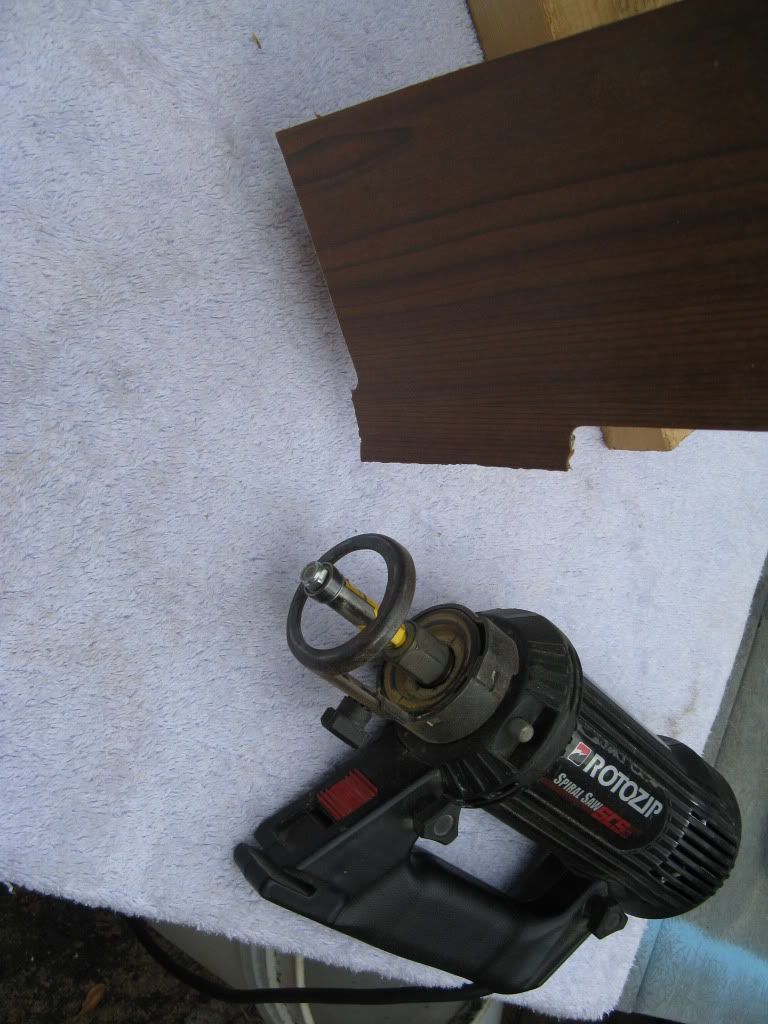

#7 Trim with router or roto zip tool. Note: lightly sand routered edges, they can cut you.
#8Same day, same drawer. 1 1/2 hours start to finish.

Where did you get your laminate?
I've been trying so hard to find a place that has that Laminate so that I can redo mine.

It's obviously a chunk of original laminate someone sent him.

blue bear ..never apologise for asking a question...the stupid question is the one not asked......I got my laminate by repeatedly asking at the end of posts for what i needed:need 5x10 inch peice of laminate for repair: eventually i got what i needed and the color matches pretty well Cool
Hey Blue Bear, I found Formica 6208-43 Glamour Cherry at Southern Lumber.
The provided link has more information. Good Luck
http://www.thesamba.com/vw/forum/viewtopic.php?t=347417
