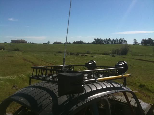

Those style racks are bad ass.I plan on making my next one like that for my buggy

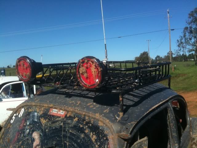

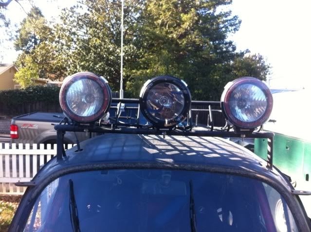

Here are a couple pics of mine, mounted to the cage

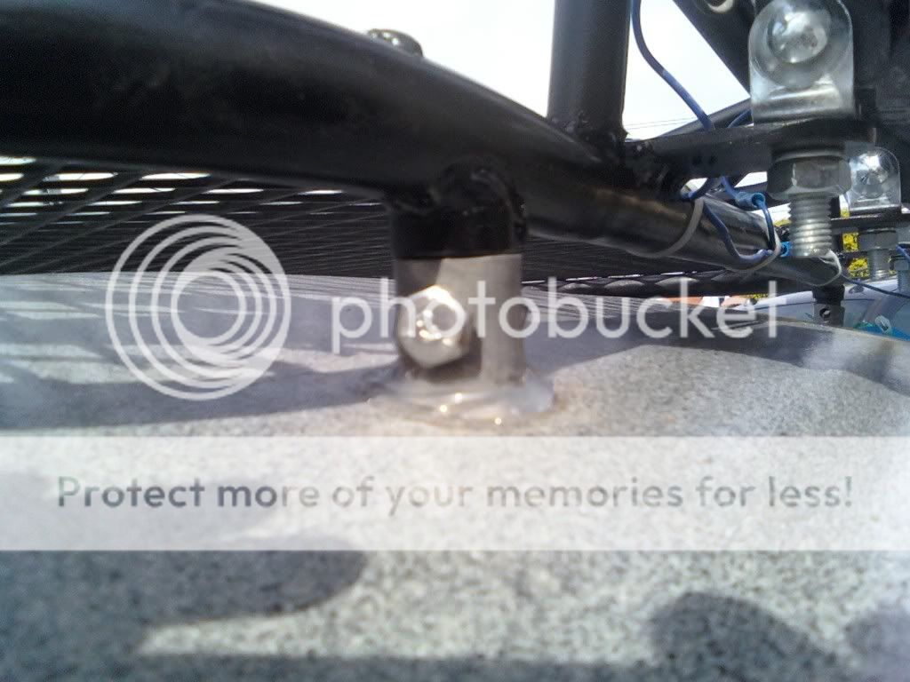

I used a bead of silicone around the roof holes to keep water and dirt out. Also the wires on the lights can be unplugged for when the rack comes off

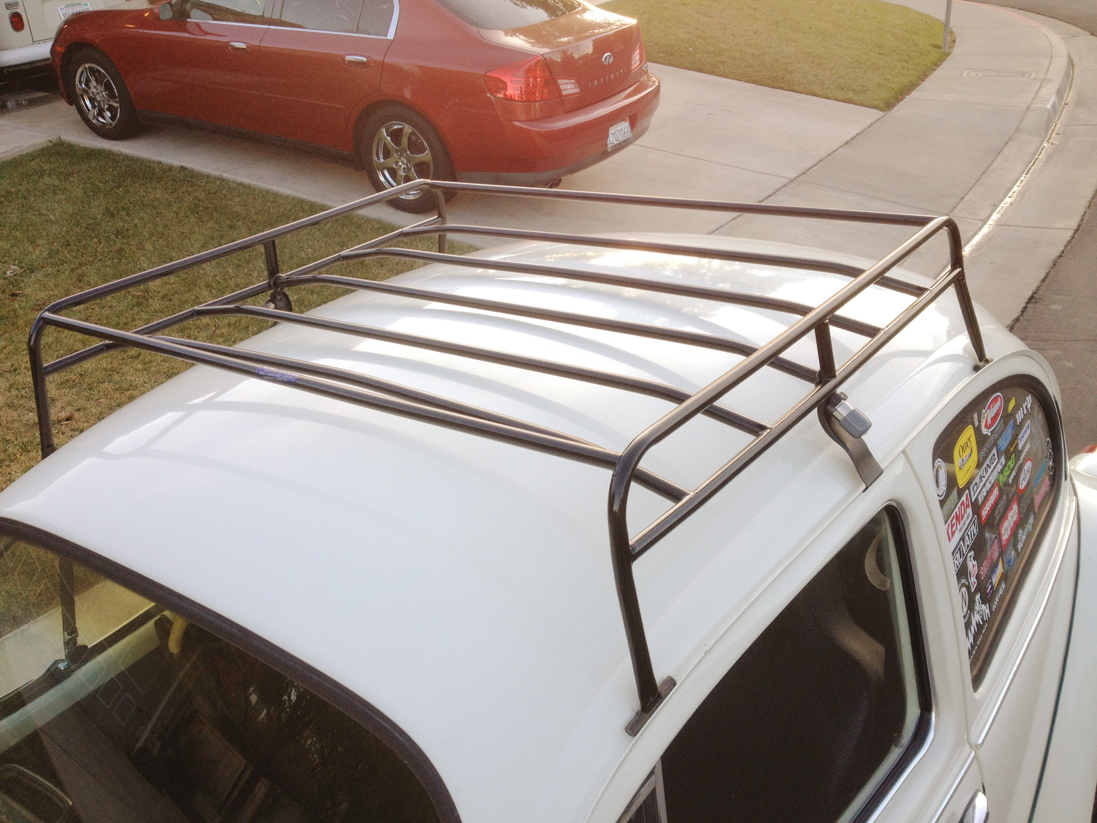

This is currently on my sills, but will be cut and tied in straight to the roll cage when complete (similar to Thext94's and K-B's set up). It is 33" wide (don't plan on ever running anything larger then a 32" tire), 48" long and 4" high. Have an opening for my moonroof that can be covered to carry more, lights are easily adjusted together, tools are tightened down securely and plenty of tie-down spots. Measure twice, cut ones.

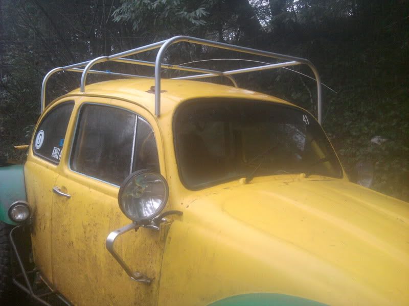

I just started building a rack. For measurments, i can tell you the drip rail is ~45" apart at the B pillar. Further forwards and backwards, it gets skinnier.
I used 3/4" EMT conduit. I know, i know. "But that stuff is hella thin walled satelightguy" Yeah, and despite the fact that the rack is at its bear minimum, it can still hold my 180# ass.
