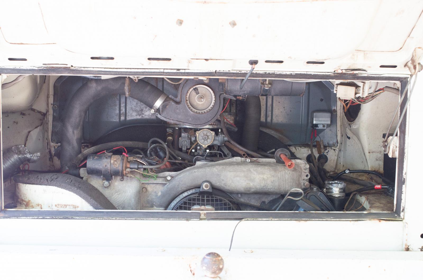

I am going to guess that his engine is a formerly fuel injected model that was an early conversion to a progressive carb. Note the use of the stock FI manifold runners and the welded center section for the manifold.
To the original poster, is your engine prepped for a mechanical fuel pump toward the front of the right side of the engine?
@Wildthings - I'm not sure what the answer to this is. Here's a picture of the engine bay as it was in the 1972 bus that I first purchased. It was sold and a better, much better, 1979 bus was purchased.
