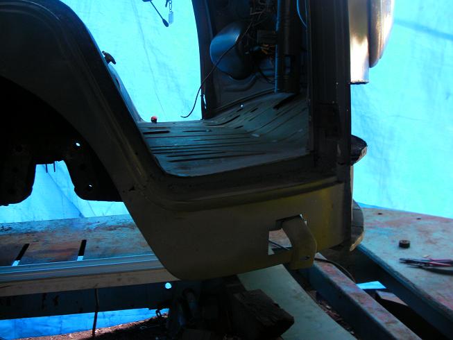

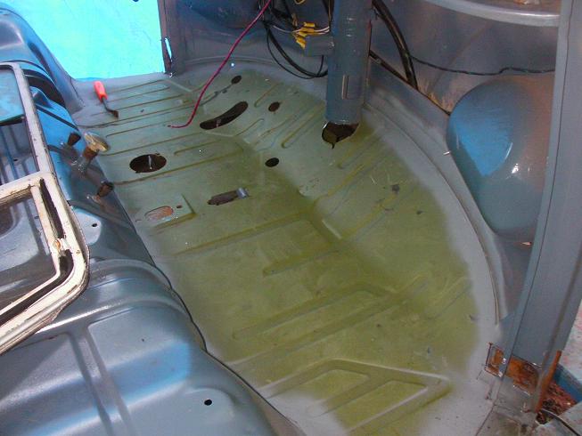

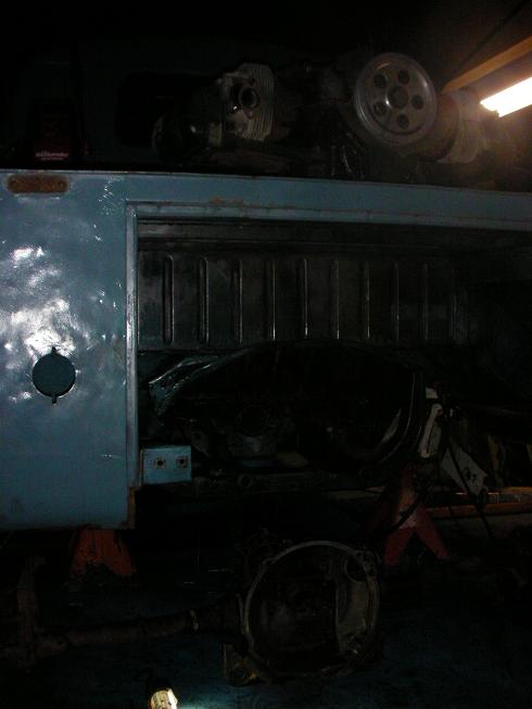

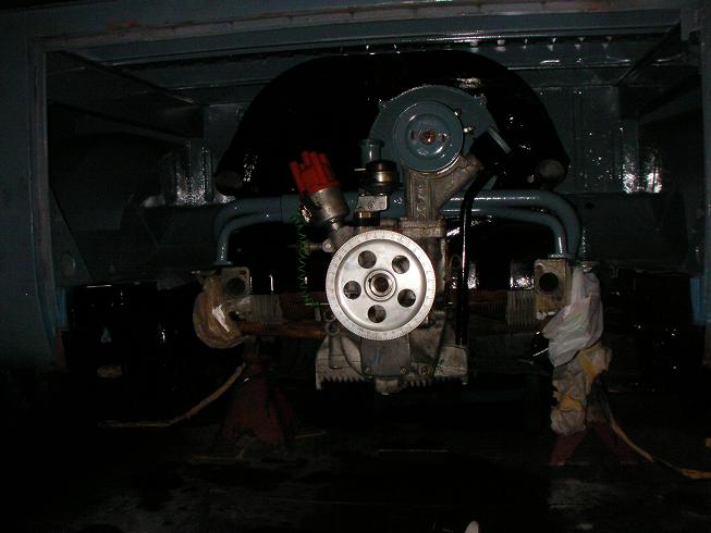

Honestly i had no idea what it takes to restore a car properly it's alot of work and i haven't even touched the body. here is some pics of my progress.
Luckily the front beam has been recently rebuilt so all it needed was a good cleaning (5 hrs with a steel brush) and paint.
i realize that my engine colors are custom but this is not the original 1300 engine. the only original part i am missing

Original tire size is 6:40X15 bias ply. Also, original engine is not a 1300, but a 36hp 1192cc. Transaxle is also split case.

Excellent project. I think you are going to regret the klown paint on the engine, but if you change your mind, that can always be easily fixed. If you're going to keep it stock, keep it stock.

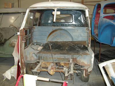

I think that is my old DC, if it is, it has been thru hell!!! Do what you want with it and enjoy it
on the way to Big Island

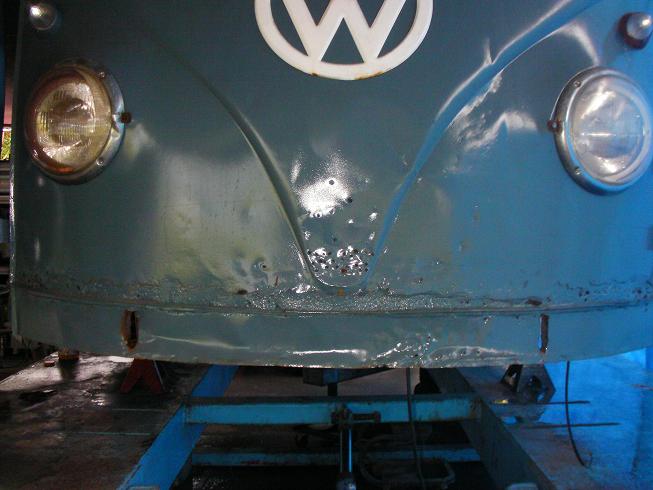

Honestly i never planned on restoring this truck to show quality. But rather give a mechanical and rust repair overhaul, and fixing all the noticeable weld ins. Then give it a cool vintage look paint job. Yes i will be leaving some dents but the rust has to go. I'm just not into owning shinny buses, but i love to sell them Cool
Just finished the some of the front end repair its nice to see clean metal.
