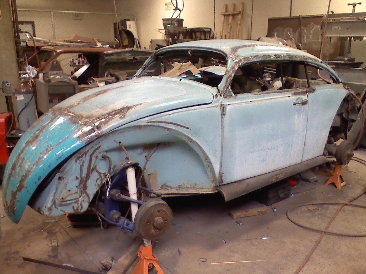

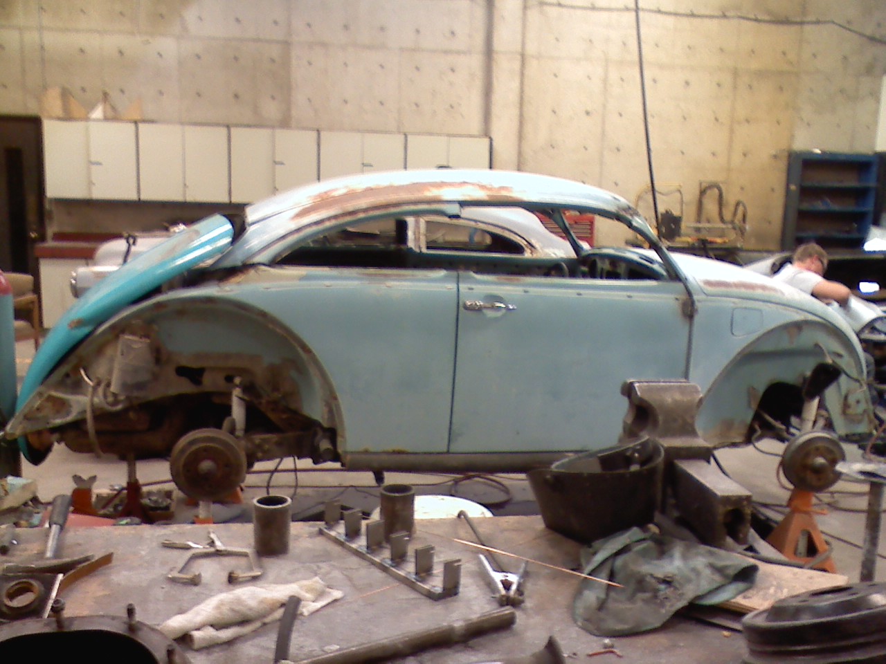

Thought I would show you what I have cooking in my shop. This was the first car I've owned and it's been sitting for 14 years. Finally I have the time and skill to do what I have been wanting.
Its a 1970 pan with a 1972 top, that I have chopped 4in, slated the post back 5in, dropped the top into the body, extended the hood 7in, dropped it 5in, removed the drip edge, removed the post and there is a lot more to come. To see photos and to watch the progress, go to www.facebook.com/VizionCustoms

Yea I cut the sides off. Then pulled the top back to get the look I was wanting. Then had to weld the sides Back on. But it was worth it, to get it to look the way I have been dreaming it to look. Here is a photo of the sides off and getting the right look, to the drop top.

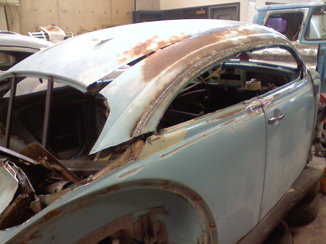

GO to my Gallary or on Facebook.com/VisionCustoms to see the start on the back window mod. Using a later 1960's rear window tin's, I am installing a 1963 rear window, that was given to me by one of my mentors. It has some rust but I will be cutting it out and then replacing it.

I just got done removing the drip edge, post, fit up the corner of the door with a curve and flared out the back out 2in on both sides. Still have more to come later on.
