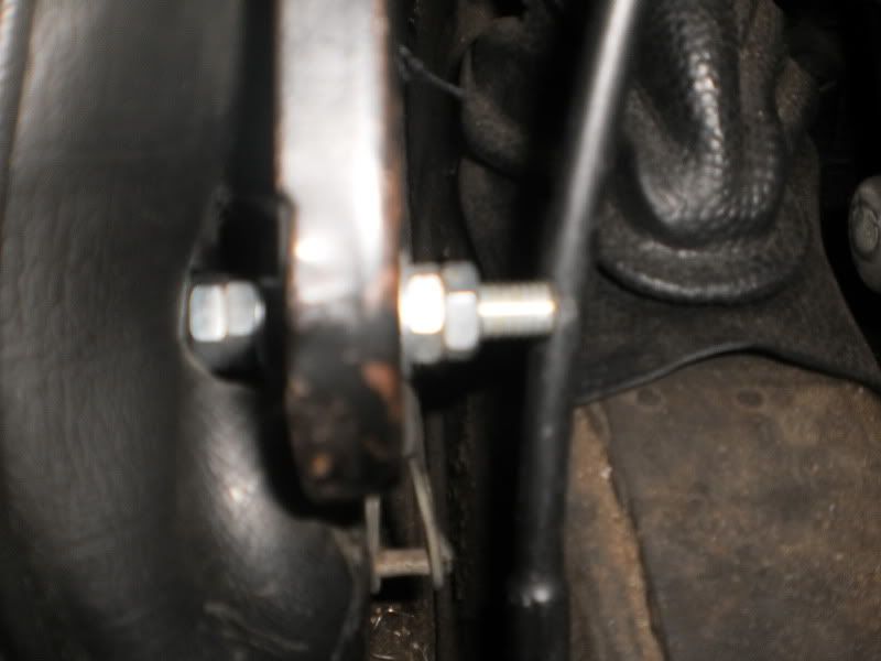

Dwayne1m wrote:
I have the bolts. My problem is where they screw into the seat base the threads are stripped. I'm trying to find a nut the same as the bolt and I will weld that on the seat base but I'm not having any luck.
I had the same issue. What I ended up doing was taking a piece of threaded rod cut to about 2x the length of the bolt, putting it through the hole, with a washer on each side, and a couple of nuts on each side with thread locker. Just dont tighten it up too much or you won't be able to move the seat back anymore.

Valnar300
Joined: March 18, 2010
Posts: 342
Location: Garden Grove, CA
Valnar300 is offline
PostPosted: Thu Feb 23, 2012 10:53 pm    Post subject: Reply with quote
Here's what I mean (Sorry about the blurry photo, with no lighting its hard to get a great shot)
