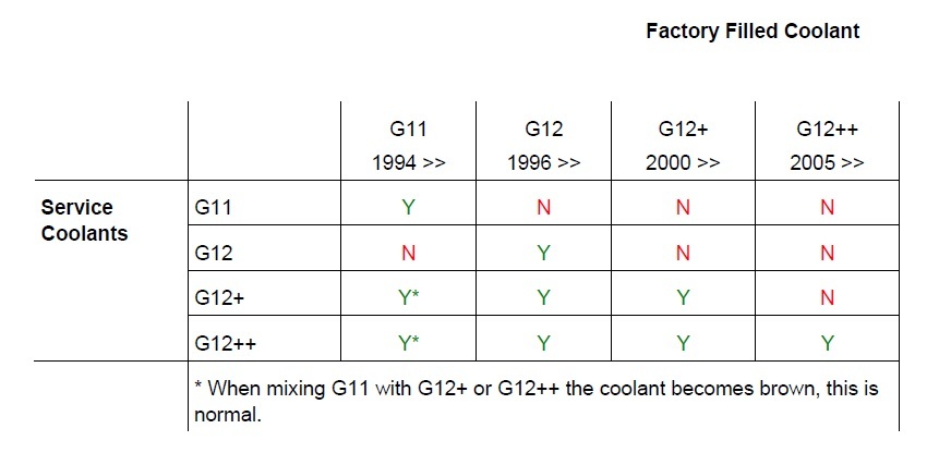

Actually G12++ IS backward compatible with G11 but will turn it brown. Apparently they went back to silicates with G12+ and G12++? Only G12 is not compatible with G11. If you go into any dealer right now, you will be getting G12++
If you want to keep it G11, BMW still uses that formulation and color in their cars.
Flushes suck in these cars. We pull both drain plugs in the head, both radiator pipes and heater hoses, get them drained, run compressed air through them and then hook a hose up to them to flush. We pretty much half fill our 30 gallon coolant drain bucket with one flush, minus the stuff that gets all over the shop floor. We use an air-lift to create a vacuum in the coolant system and then air bubbles are kept to a minimum and easier to bleed out.
I tried looking but couldn't find the coolant TSB publicly, it's 1910-03 if you want to search. I downloaded it from Identifix so I can email it to anyone interested too.
Here is the main gist of the TSB

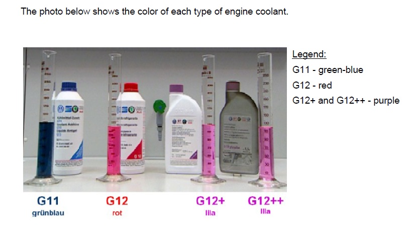

Since this is a thread about colors, let's add some info to ^that:
G11 = blue
G12 = pink
G12+ = purple
G12++ = purple
G12 should not be mixed with G11. If you go into any VW/Audi dealer today, verify what you're getting because some will still sell G12 &/or G12+. In fact, several years ago I was still able to get G11 at my local Audi dealer.

PostPosted: Sat Mar 03, 2012 8:42 am    Post subject: Reply with quote
Here is the picture the TSB uses...
Personally, over the last 12 years of adding coolant to VW/Audi's almost everyday at work, I can't tell the difference between the 'red' and 'purple', it's all pink to me. Our dealer sold G11 several years ago too, it's only been in the last 9 months or so it has been unavailable. And if you go buy G12, you will get G12++
Basically, your coolant should be all of one color; however I don't recommend anything that isn't OE VW. I have to flush all the green out of mine and will be running G12++ as it is formulated for my car and easy to get (especially since we buy it 5 cases at a time at work!)
