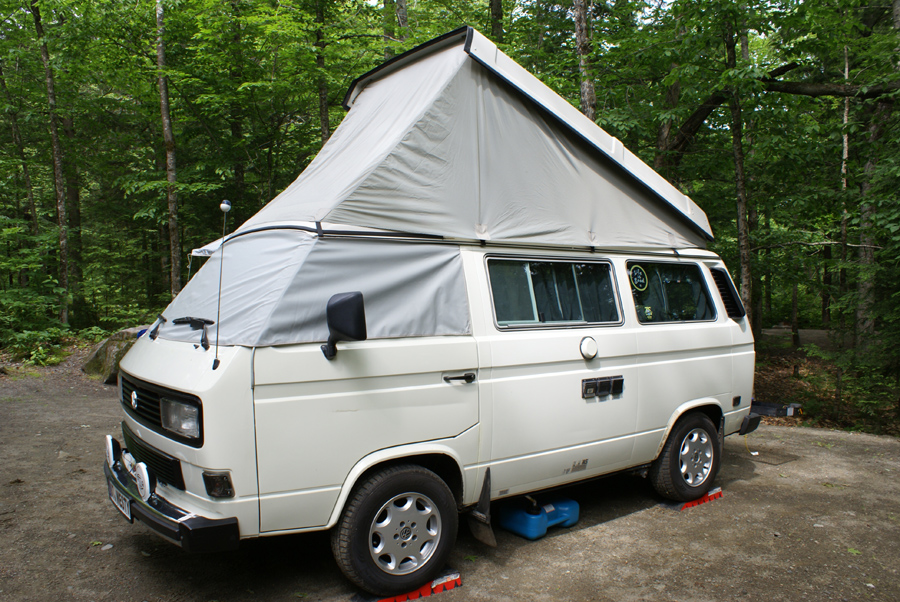

This blue, grey water tank was purchased at a local RV shop. It cost around $30, a little more
than I thought it would be. The tank is really rugged and has a large cap to drain out the water.
For the most part I am happy with its performance.
