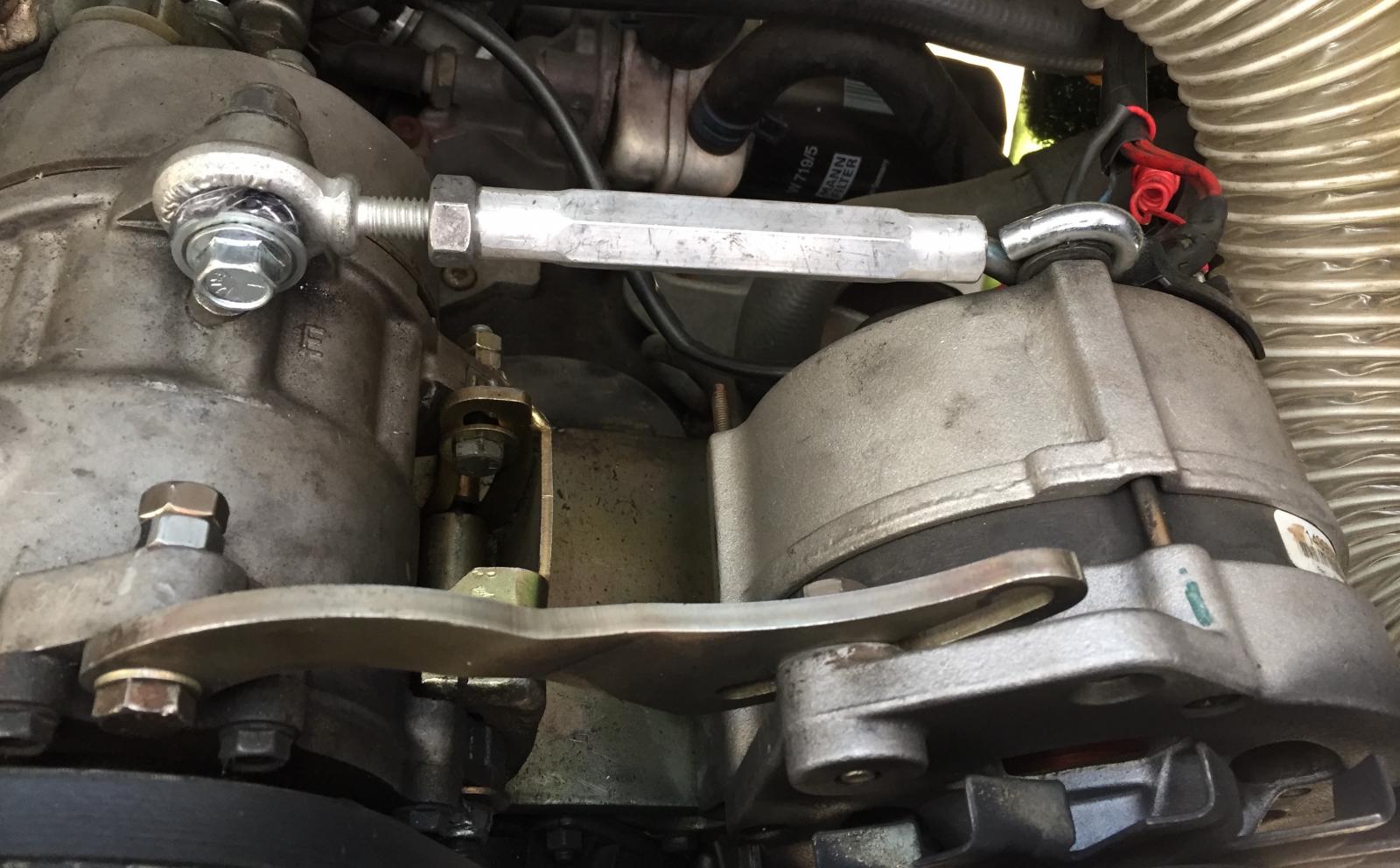

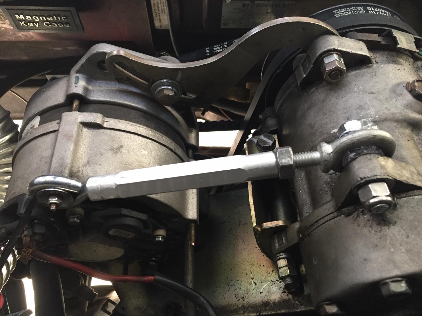

For less than $20 in Lowes hardware, I solved
the Mickey Mouse alternator mount on my Tiico.
Now it's as solid as a rock. No more vibrations
in the shifter, and pulleys are aligned.

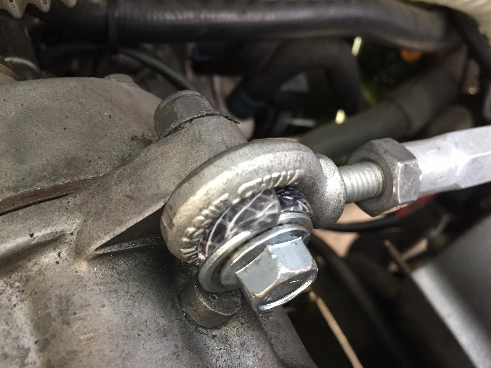

I used hose to fill the big end eye, and provide some damping.
Overview showing new support on backside of alternator:
End links on alternator and AC compressor.

PostPosted: Fri Oct 26, 2018 4:59 pm    Post subject: Re: Tiico alternator bracket FIX no more vibrations. Reply with quote
Nice mod...simple, cheap, effective!
PS: YES, new wiring, please... Shocked Wink
