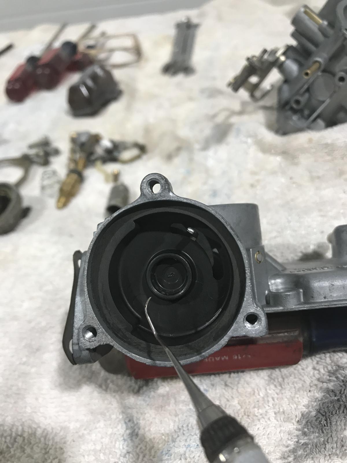

Been awhile since I’ve had to work on one so I need some help guys and girls !! How do you remove this diaphragm and stem from top cover of carb.? The Bakelite part will not budge!!

Pull the black plastic part out, towards you. Then it will be obvious how the triangular diaphragm comes out, will simply pull out once its rod is disengaged.

That is the problem the Bakelite part is stuck in housing . I use dental picks and cleaner to make sure there was nothing to keep it in . Gave it a few nice sharp smacks on a flat piece of wood bench . Not budging!!! Scared I will break it by prying on it .

jeffros 58 wrote:
That is the problem the Bakelite part is stuck in housing...Scared I will break it by prying on it.
Try squirting a little penetrating oil (PB Blaster, WD40, etc.) around the plastic insert, then try it again.
You can also try applying a little heat around the aluminum housing (not with penetrating oil around though). Not too much...you just need to expand the diameter a few thousands of an inch to loosen up the insert.
If the insert breaks, it probably wouldn't be too much trouble coming up with a replacement...even if you had to buy some junk carb for a few bucks to get it.
Maybe someone super-glued or epoxied it in. So it could break, but can't be too much to obtain. I'd guess that [email protected] would have several hundred.

Put the choke unit back in and tap around the edges of the carburetor choke housing to make it rounder again. Over time the heat from the choke and the pull from the choke screws distorts the housing.

Was at a swap meet last week end and found a replacement Bakelite part so when I got home I did a little bit of digging and pried it out broke it but it’s out and new one went in clean so all is good

Super glue and bakelite (phenolics?) go really well together, good as new if you do it right.
