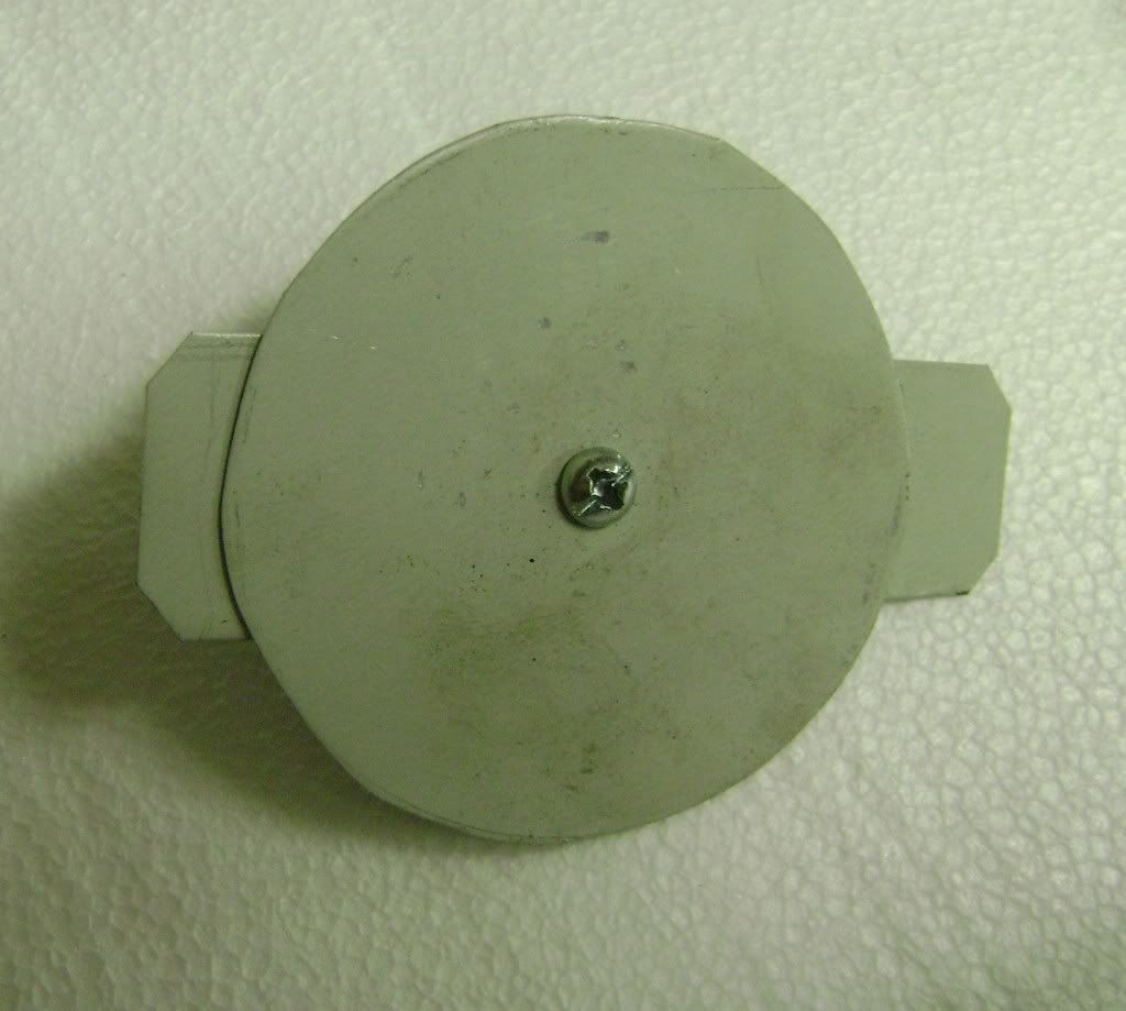

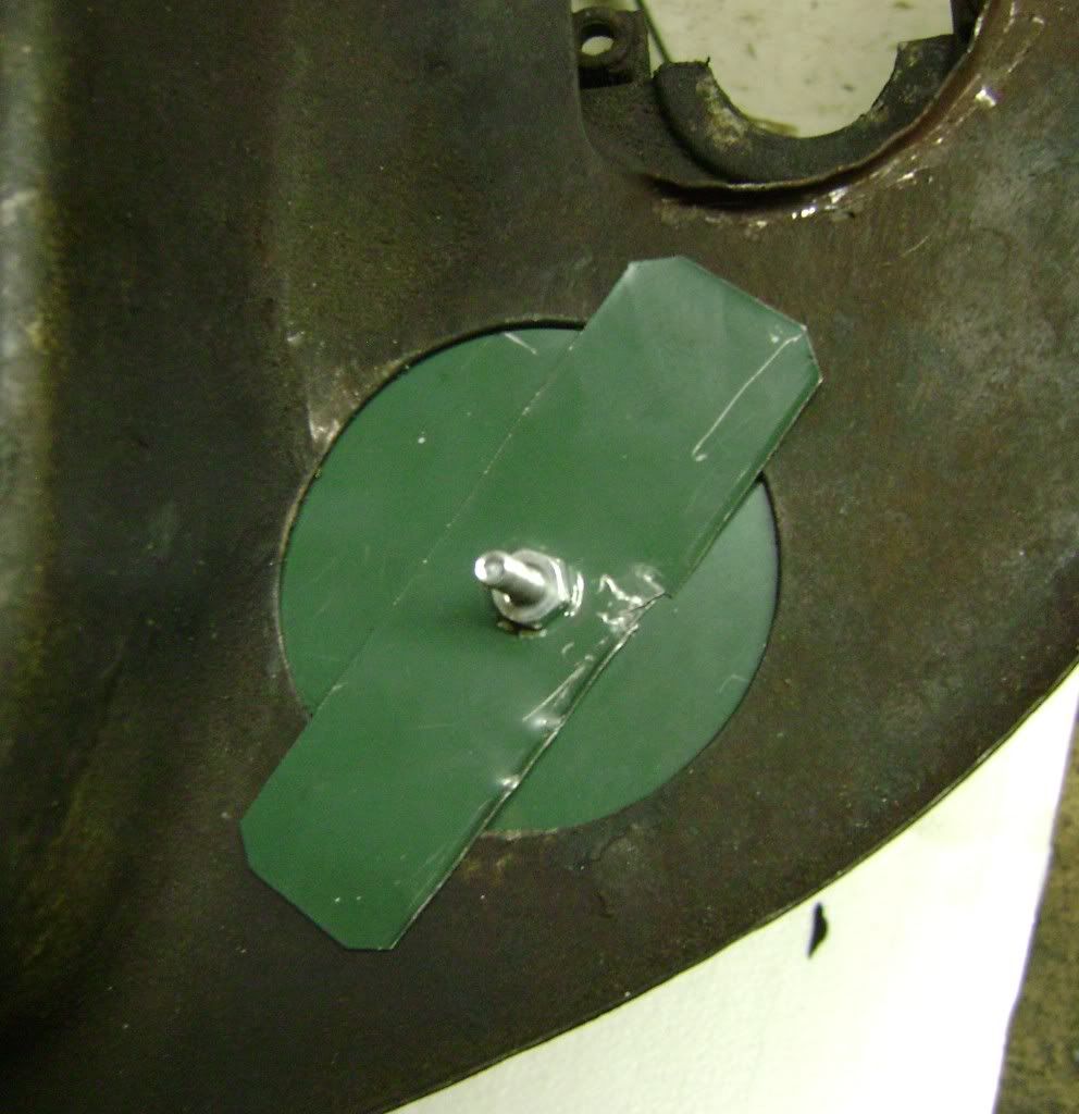

I plugged mine with 2 round aluminum pieces cut with a hole saw that I just happened to have. Brass machine screw through the middle to a 1" wide piece of aluminum under. A good piece without the holes would look better though. Awesome Powdercoating might have it.

I did something like the above poster, I made the under piece just wide enough so I can slip the assembly in/out without tools. Holds its place just fine. (I only run the hoses in winter).[img]
