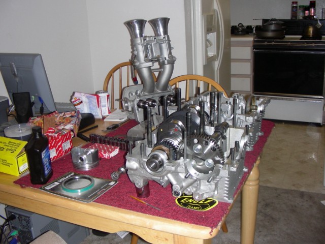

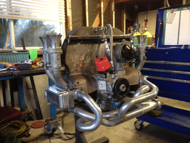

a couple years ago I was working tons of OT and started stockpiling parts for a killer new engine. Here are some of the parts:
2387cc
86mm Bugpack Flanged Crank
Pauter Rods
94mm Weisco Pistons
S/F Heads ported By Deal Lowry
Pauter 1.5 Rockers
Pauter Rods
fk-46 cam
12.5:1
1-3/4 A-1
Italian IDA's
I still had my thing fan shroud and misc. other parts
I reinforced the subframe and purchased Delrin solid mounts from Bugbox then had it powdercoated.

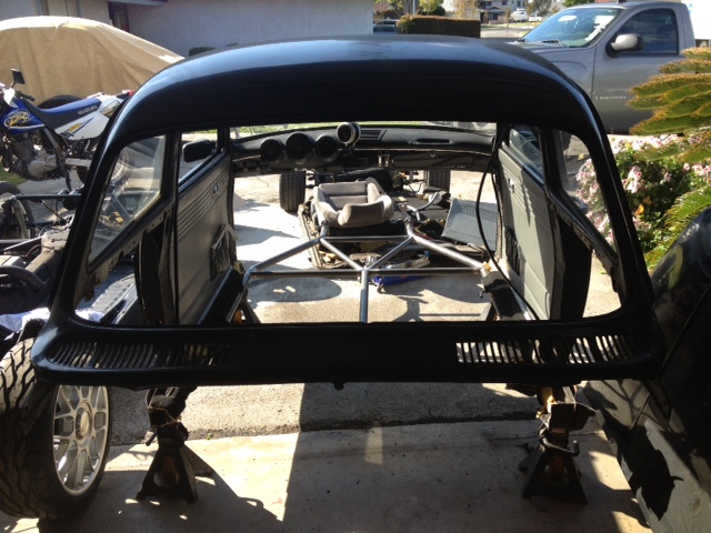

I was not happy with it so I started building a coilover rear end with ladder bars. I was test fitting the subframe and noticed a lot of rust in the sheet metal "frame" where the subframe mounts. I gave up and was pretty upset. What do I do now?
Repair/ Rebuild the frame sheet metal?
No way!
Its time for a full tube chassis!

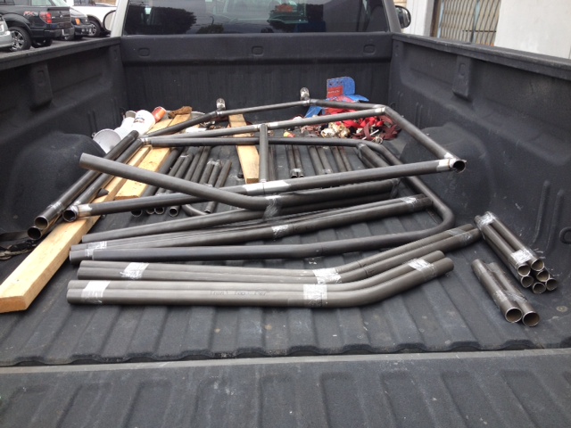

I drove over to Ron Lummus and purchased a Chromoly chassis in kit form.
I came home and fired up the compressor and got out the death wheel and sawzall.

I picked up the chassis kit yesterday and could hardly sleep last night I was so excited!

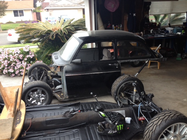

I notched a few tubes today, got the pan out finally and disassembled it for the parts I need. I am going to build an a-arm/coilover front suspension and am going to use the type III spindles.
Good Bye Pan... Hello Chassis!
Some of the front end parts I have accumulated.
More pics to come...

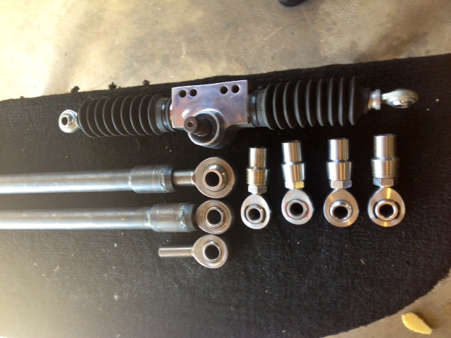

These are not the rod ends I plan on running, just figuring things out. The Type III front spindles will work perfect for an A-arm front end! where the ball joints attaches to the spindle is a through hole, not a taper. The top is really close to .625 and the bottom is a little over .700. I will ream the bottom to .750 and use some high misalignment bushings to clamp in the spindle then run a 5/8" rod end on the lowers and 1/2" on the uppers...

Got home early and decided to work on the notch engine a little tonight.
I tig welded my old German fan.
I'm going to assemble the alternator with pulley and balance it as an assembly.
I have only owned one VW alternator my whole life. I purchased it from a friend while I was in high school probably around 1992 for $30. It was extremely ugly and making loud bearing noise. I was putting new bearings in it and started sanding the parting lines off. My plan was to powder coat it. I hit it with 80 grit then went to 220. after that a little 400 then 800 and even 1200. Took it to the buffing wheel and now I have a polished alternator...
I hope it still works
Hopefully I can get the engine complete this weekend and take it over to the dyno. After that I am going to attack the chassis and try to get it at least a roller by June.

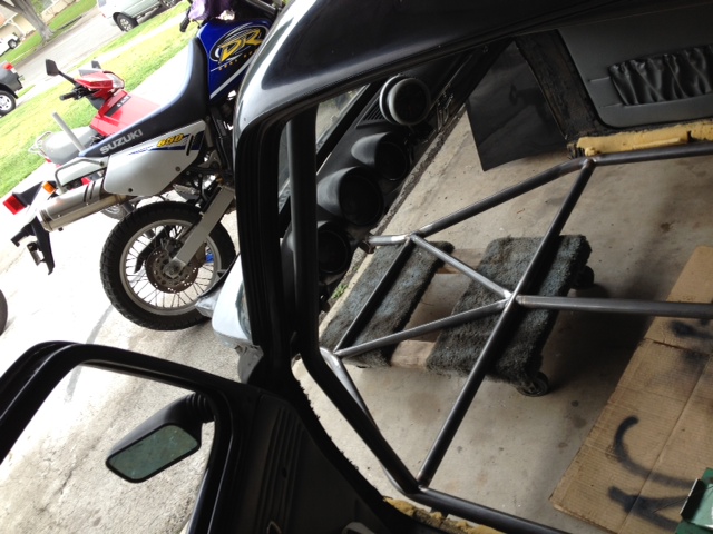

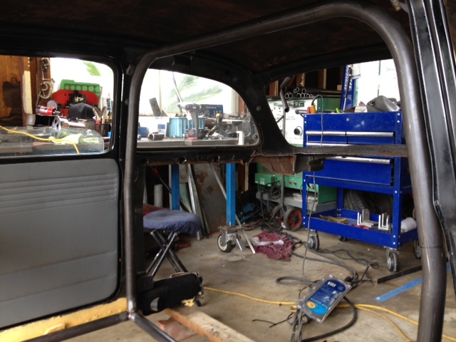

I got a little work done on the Notchback today. I spent a lot of time getting the tools working properly and built some adjustable support stands to hold the longer tubes while notching them.
we also got my dads '67 back on the pan today. Its going to be a really nice car!
I'm starting a new job tomorrow so i'm not sure when I will get to work on this again. Hopefully soon. I was hoping to have it rolling with the engine and trans in by the classic but we will see...
