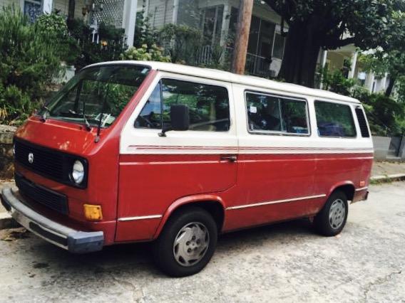

Hi all, first post here.
ive got my vanagon (see title) and it runs for about an hour and then when i shut it off, it takes at least 10 minutes to crank back up. I thought it might have been the fuel pressure regulator so i just replaced it yesterday and also put a new ignition switch in, but same problem. Could it be an electrical/computer issue? Any info is greatly appreciated
