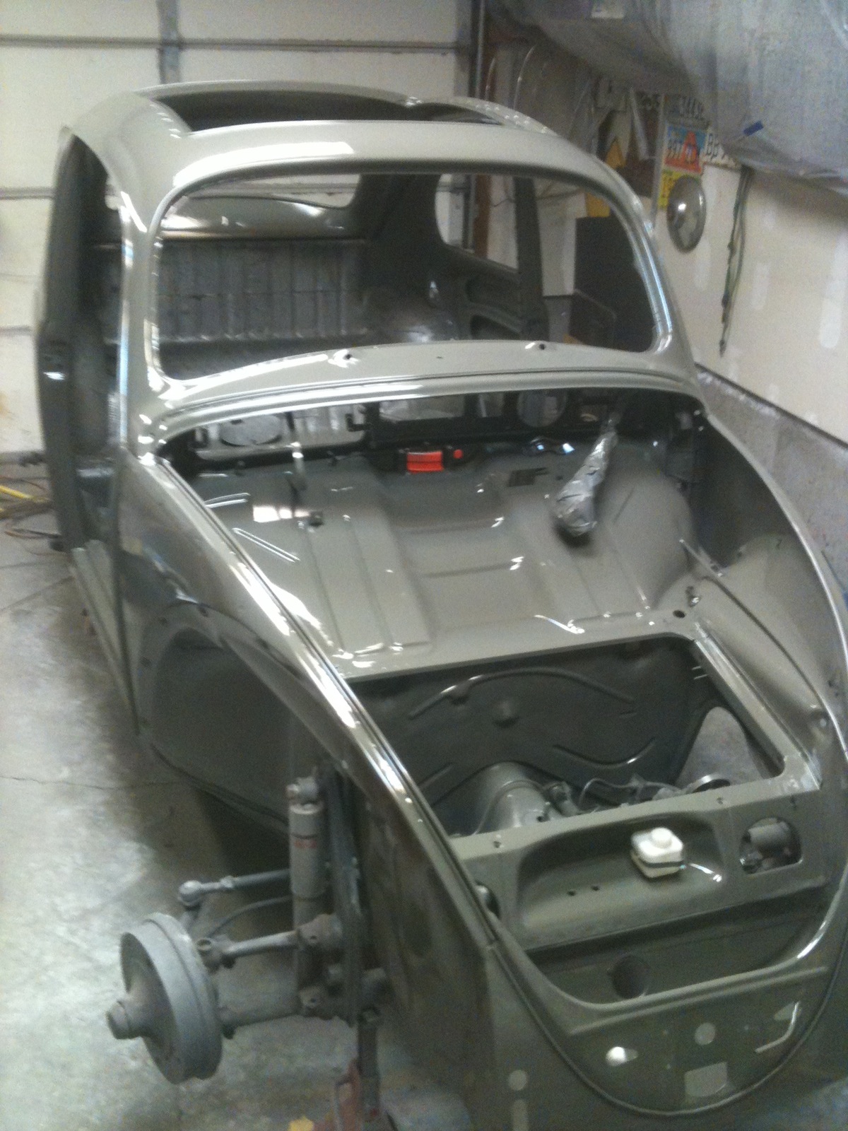

It started with an oil leak last october. I pulled the engine to take care of the oil leak and decided, since the engine is out, I will put the new transmission I had waiting in the garage. The orig trans was popping out of 2nd gear. When it was out, I decided to paint the engine/trans bay. That required removing the rear interior to weld up some holes from the P/O. Well next thing I know it looked like this....
It is an original Anthracite grey(L469) car. I love that color with the True Red interior so on with the restore.
She had been hit in the front so I needed to repair the front qtr panels and replaced the front apron and spare tire tray. It came out nicely.

I masked up my garage and turned it into a paint booth. Painted late at night so I wouldn't get any complaints from the neighbors. It was a chore to keep the garage heated, ventilated and floor wet down to hold down the dust when the temp was in the 20's. But it turned out nice.

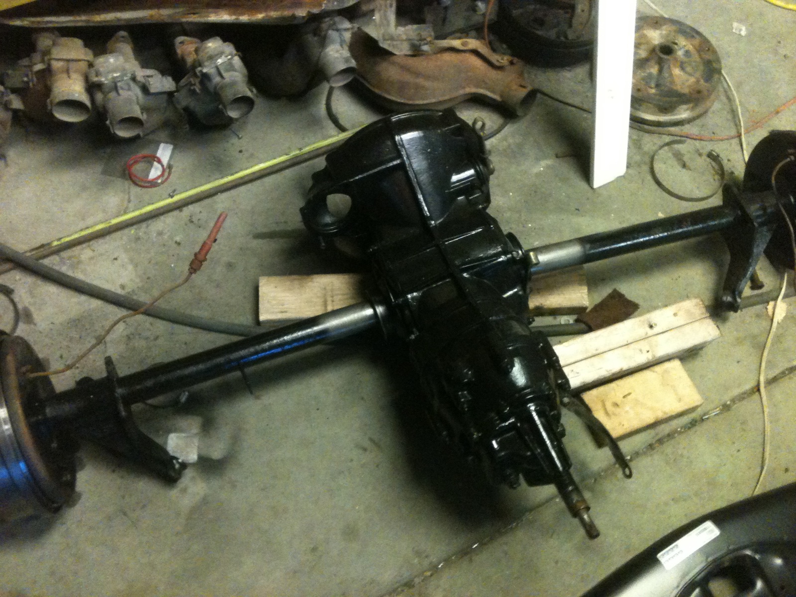

New transmission, a rebuild 73 Ghia trans converted to long swing axles and upgraded to Type 3 rear drum brakes.

Hey just wanted to know what size tires you used on the long axle set up?
I also would like to know why you went with long axles as compared to short. I currently have long axles in my 1960 & considering changing back to short. After looking at your set up I am thinking I may just keep the long.

The rear tires are 165r15 stock size tires. I went with the long axles to give me a wider stance. VW went with the long axles in 67 to help eliminate the wheel tuck issue. Add a camber compensator and the issue goes away. Personally I love the smoothies and wanted to fill the wheel well with tire but keep a close to stock tire. If you are going to use any aftermarket wheels with different offset or disk brakes then the short axles are for you
