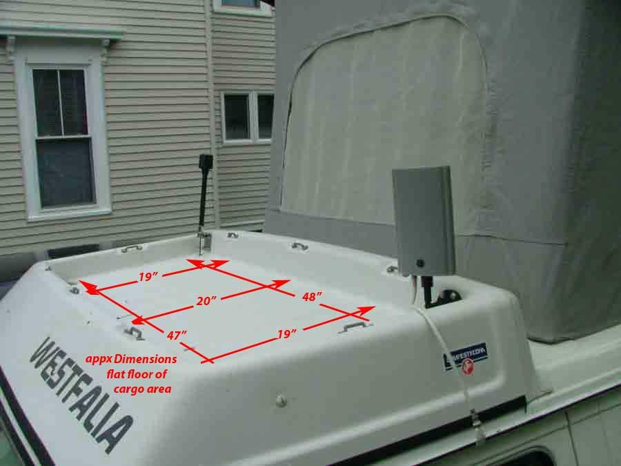

Is this the one you speak of?
https://www.renogy.com/100-watt-12-volt-monocrysta...ontroller/
Does it fit in the well of the luggage rack (assuming you park pointing south)?
Thanks.
Sodo
Joined: July 06, 2007
Posts: 10615
Location: Western WA
Sodo is offline
PostPosted: Tue Oct 22, 2019 2:13 pm    Post subject: Re: Renogy Solar Panel Sale Reply with quote
Heres appx dims of the flat floor area.
It gets a little bigger as you rise up out of the rounded corners.
Looks like it will fit in the middle of the cargo area while folded up, then certainly fits when opened and up on the stand.
