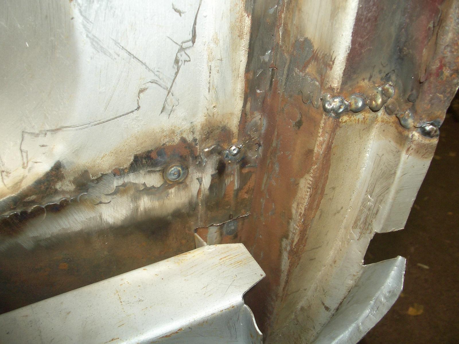

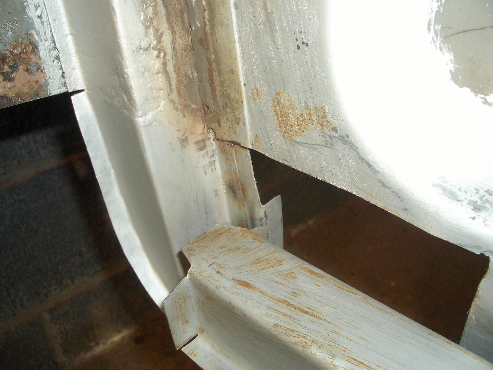

First question, concerning bulkhead repairs:
I disassembled the front clip, took me about three weekends of cursing and drilling spotwelds and stuff. The new patch panel needs some repairs before it can really be used, so I want to know the following:
If you can't read the writing on the pic there, I'd really like to see a picture of what a non rusted out stock bulkhead looks like in the lower corners, and also some measurements for those area's features, and for the distance between the lower line of the pressing and the lower edge of the bulkhead. Any help there would be appreciated.
Once I know that, I will try my hand at the rust repair there, and that will be a big step forward. I've already got the bus cleaned out and I've welded up some bracing in the cab area. But I haven't cut out what little is left of the original bulkhead and wheelwells yet, because I want to leave whatever rigidity is there until the new panel is ready to go in. I left the wheel well tubs attached to the bulkhead clip, and it should all go in pretty quick and dirty once I make the space.

Congrats! That's one of the most fun areas on a bus to fix! I'm sure you already know this, but there is ALOT of pieces that intersect right there. The top hat, floor, bulkhead, b pillar, jackpoint, outrigger, front wheel closeout, dogleg, rocker, and the rocker strenghtener is in there too and the forward cargo door lower bolt holder.
If you check my sig 'Samba Iron Workers' link, it will lead you to a bunch of project threads dealing mostly with metal work.
Here's some pics from my 21 window;
I welded that little 'square' piece as a little holder.
I only ground the relevant welds, not all of them, so excuse the bumps!
This is from the other side..
Turned out ok in the end Smile Just keep welding, grinding, cutting, measuring and powering on!

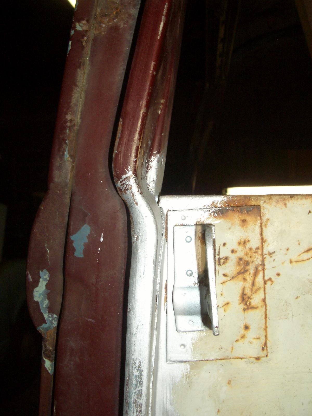

ya, I've been trying to wrap my head around all of these intersections in this area, and around the b pillars especially. Many hours squandered pouring over build threads on thesamba.
I drew this up so that I could figure out how the b pillar works. if anyone sees something wrong here, please let me know.
These new pics should help a bit, but I'd still like to know at least a width for the lowest part of the bulkhead, and the distance from the lower line of the bulge to the edge. I suppose I could just try to mock it up in situ like you did, but I feel like it will be easier to do the welding and some hammer/dolly work while it is not installed. I'll scratch my head some more and see what I can figure out. Might be able to derive some measurements through mechanical wizardry.

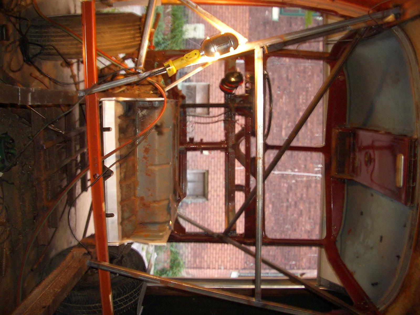

well, i had to move the bus to a new garage. this time its the garage behind the house im renting, which is good cuz i am much more motivated to work on it. but it is bad because rent is going up in november and i don't know if i'm gonna stay. and the land lord also said i have to find a new spot by spring. so odds are good it will be moving again in the future.
meanwhile, i have been plugging away and disassembling the donor clip. here are a few pictures of where i am now.
this is the scariest one i think. sorry, i was too lazy to rotate this, but that just adds to the scariness so lets say i intended to not rotate it for effect.
top hat is not installed yet, just setting on the rails so i can visualize how f'ed up the body to frame relationship is.
and I say f'ed up because i think i have some frame bending issues. potentially from having to move the project in a fragile state.
as you can see, it seems like the frame has sort of pinched up in the middle. I suspect the rails should be straight all the way across the bottom edge but this is currently not the case. worse on the driver side than the passenger side. At first I found this odd because there is more shit being held together on the driver side, but then i realized there is nothing holding the weight together on the driver side and now it kind of makes sense that that side would suffer more.
the result is the following:
granted, i made my own patch panel, and i haven't measured yet to make sure the distance from the beltline to the bottom of the b-pillar is the same on both sides, but the patch panels i made for the driver side and passenger side are identical and the driver side sags below the folded edge on the top hat by 5-10mm (using the eyecrometer) whereas the passenger side lines up pleasantly. I am going to print the frame dimension file tomorrow at work so that I have some reference points, but it would also be handy to hear from someone who knows what the overall distance from beltline to bottom of the b pillar is, or beltline to that folded edge on the bottom of the bpillar that lines up with the folded edge on the top hat. lots of words there, sorry. I may draw up some lines on a picture tomorrow at work to try to better explain what dimensions would be helpful.
I am also wondering whether i should attempt to straighten out the frame rails right now and see what happens to the areas in question. I am trying to think about how to brace the non bent parts of the frame so that i don't do even more damage. eventually, i want to box in the frame rails for strength. but i think i need to get them as straight as possible first. any ideas here would be appreciated.

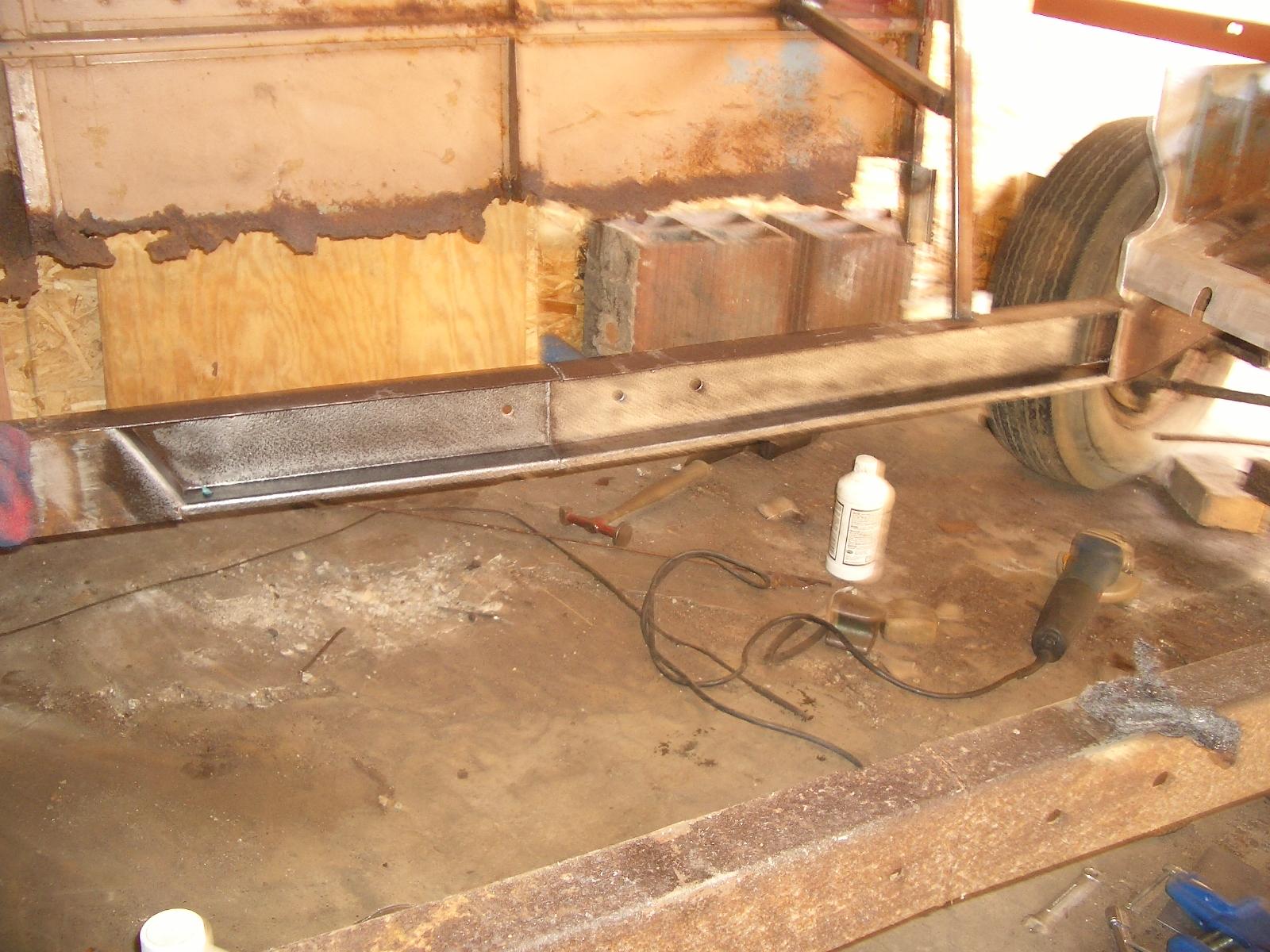

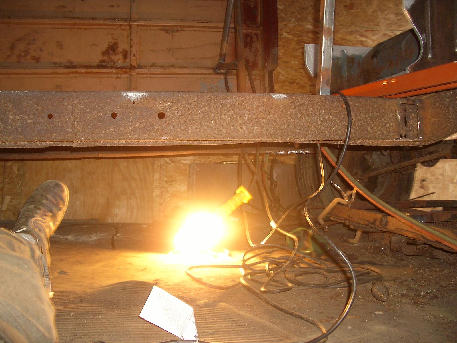

skipped out of work early today to work on the bus. I got the frame rails pretty much straightened out yesterday using a 3" bench vise, one of my favorite hammers, and a chunk of scrap stainless steel. It is not perfect, but it is damn close with a straight edge held up to check. Maybe slightly under 1/16" from being totally straight. I am thinking this is close enough.
Haven't checked to see if the tophat to b pillar junction looks much better, but I am a lot less worried about it now because I compared my drivers side patch to the passenger patch (both homemade) and discovered that the folded area was not exactly the same length from side to side. I suspect this is where a large chunk of the difference in alignment is coming from.
Spent today cleaning up the inside portion of the drivers side frame rail. I have no access to a sandblaster, so I've been using navel jelly, a wire wheel on a grinder, ospho, and then master series. I am letting the ospho sit overnight, and plan to paint tomorrow.
straight, clean rail (either my camera is on its last legs or I'm getting parkinsons.)

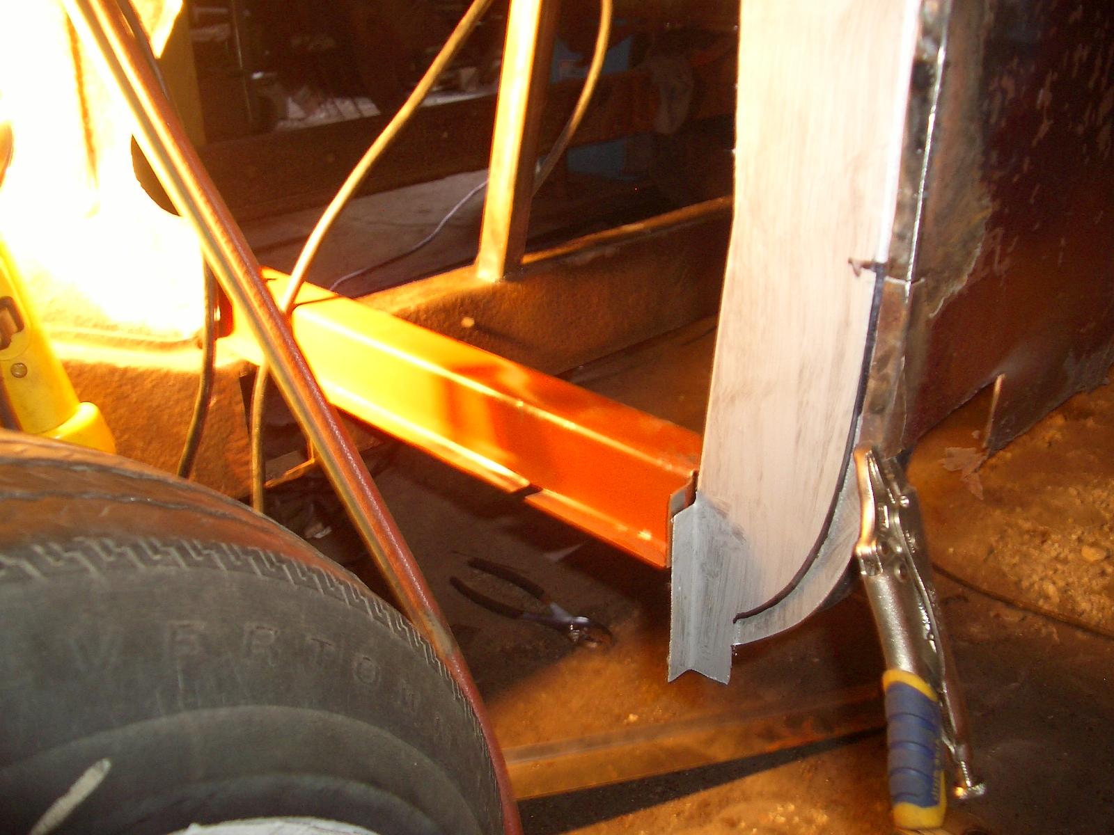

While I was outside, I started fitting repair pieces on the passenger side. I also took the opportunity to fabricate a wiring harness tube for the passenger side out of some 1" by .035" wall tubing that my bicycle building friend has had in my other van for months. Figured he wouldn't miss it. I'm thinking I need to dig through my notes and figure out who his tubing supplier was so I can get another piece of 1.125" diameter by .035" wall tubing for a new shift rod tube. Maybe I will make some phone calls to that effect tomorrow.
wiring harness tube shot
The whole idea behind the wiring harness tube is to keep stuff from rattling around and make installation easier for the new harness when I box the frame rails in. I also ground down a few of the original frame rail welds at the bend so that I can box the c channels and have the new pieces fit flush.

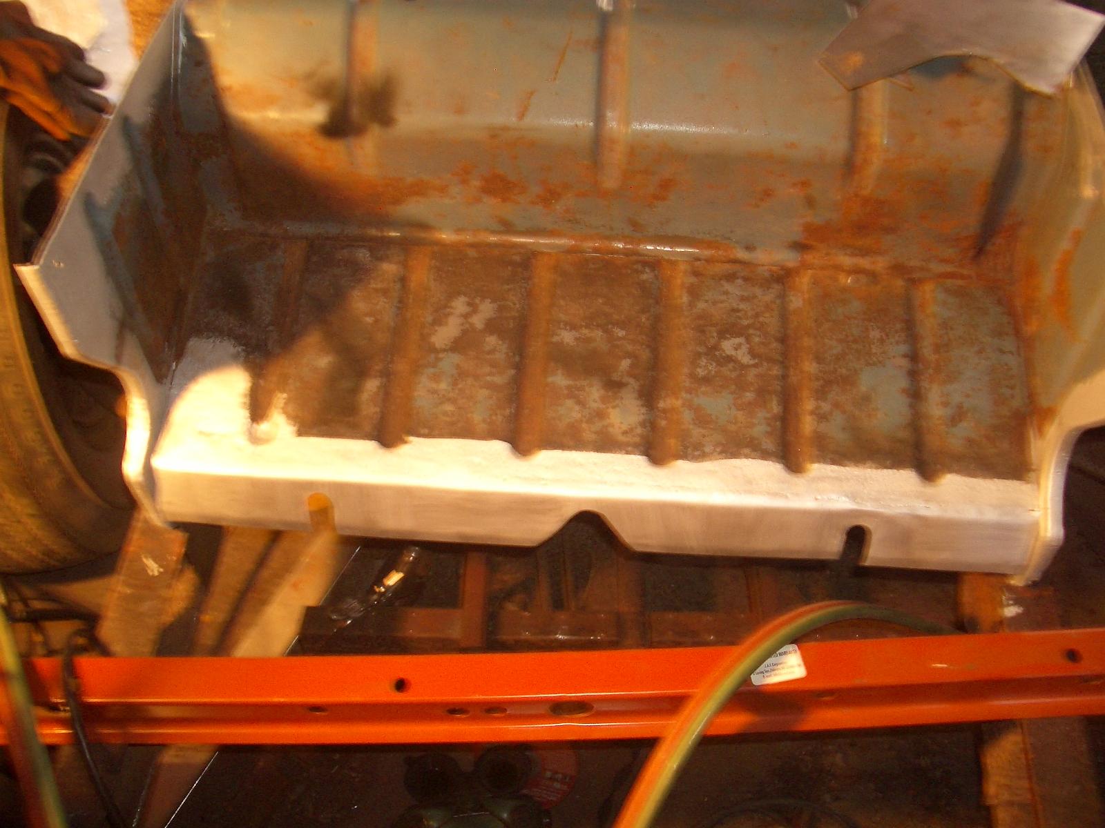

see, its actually in there! Had a hell of a time getting photos into the gallery. (my own laziness is to blame, not this wonderful site.)
Actually wondering if anyone can check out this area and tell me if I got it close. Had to lift the drivers side about 5/8" to get it to line up the way the passenger side did. This looks right based off the rust/paint line on the old b pillar from the front clip i disassembled to get the bulkhead, but I'd still like some input.
been slowly working on finishing up the patches down low on the bulkhead, just a couple to go. Expecting to get some work done later this month as I saved up some vacation days. Gonna be cold outside, but I got a wood stove in the garage now, so I have no excuse to not work.
