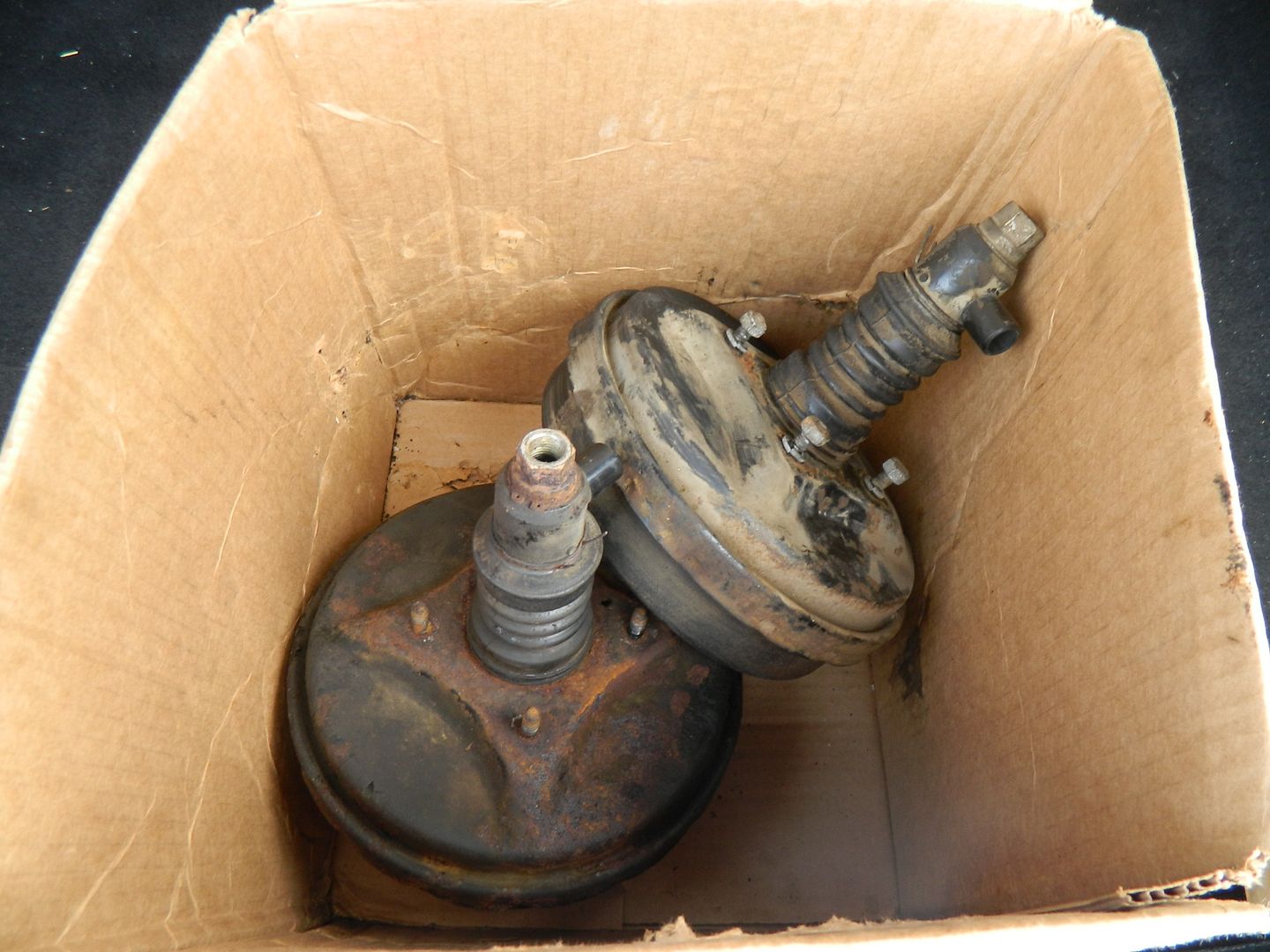

Booster
Booster with parts assembled

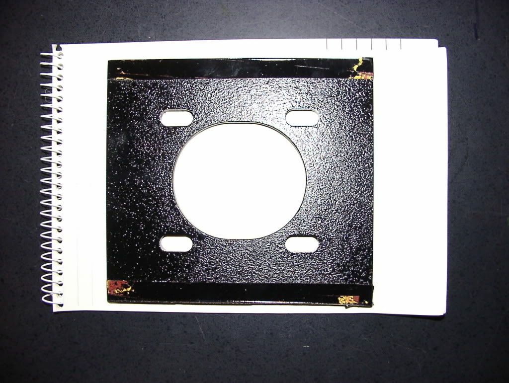

The plate

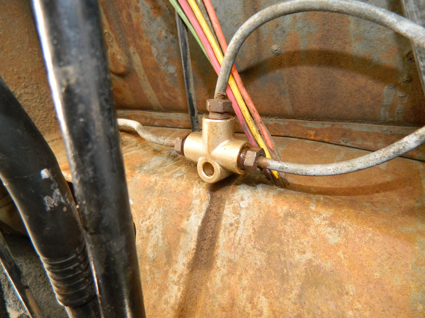

T fitting

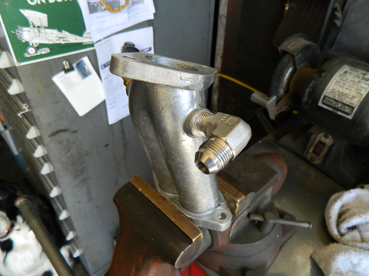

Vacuum fitting to intake manifold

1) Weld the plate to the beam.

5) Remove the old MC and install the T fitting. Best to cut the rear line first. More on that later.

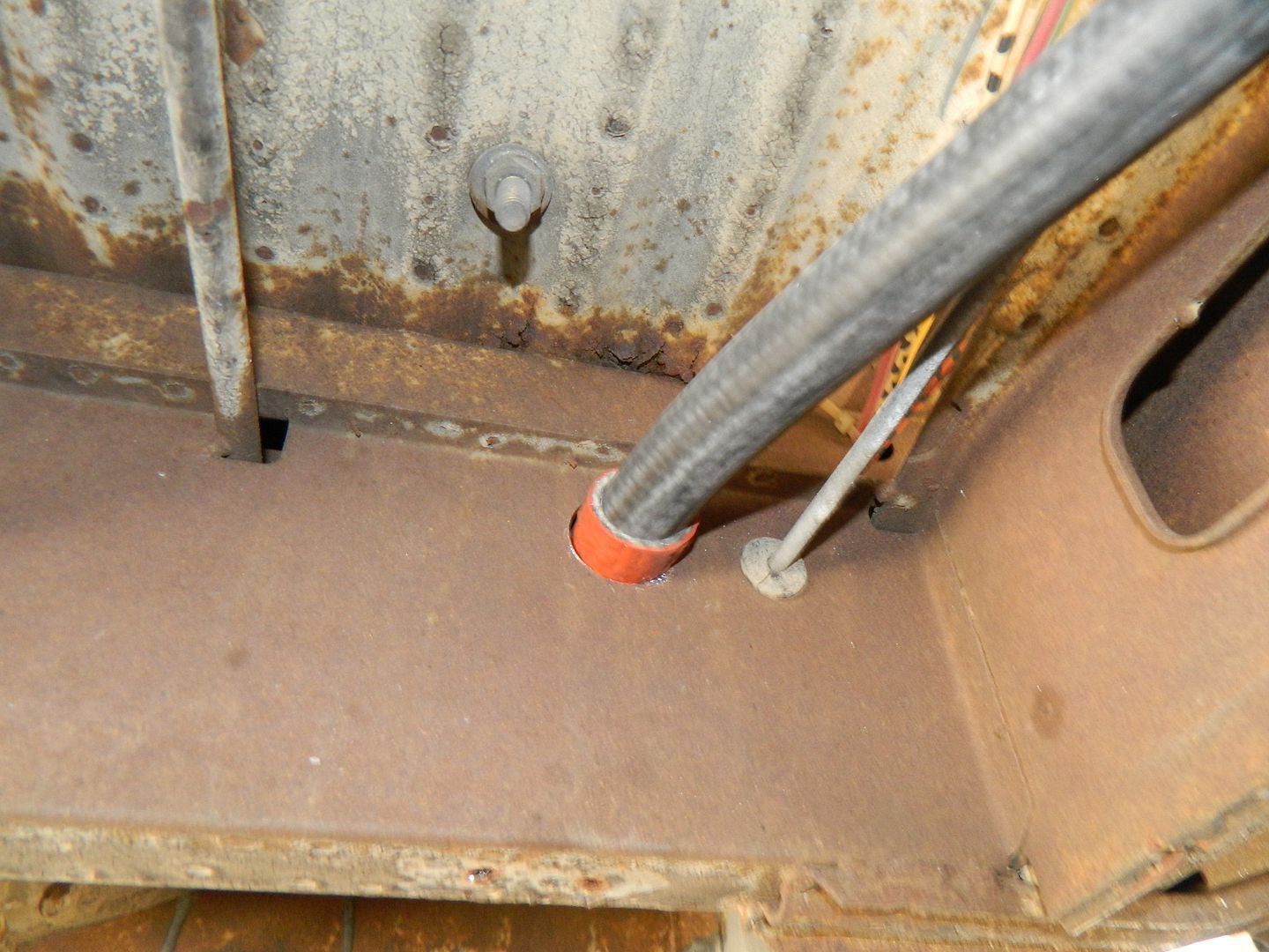

10) Begin routing the rest of the brake vacuum line back to the engine. I use a hole saw

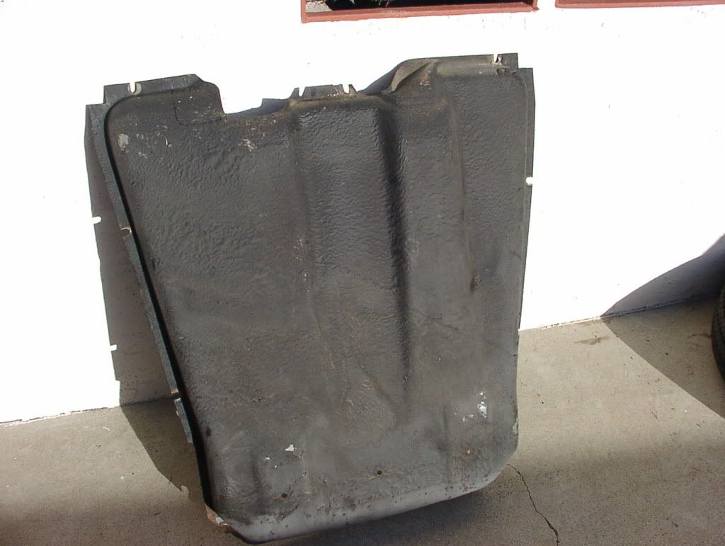

12) The splash pan may or may not need to be cut slightly for fitment.
