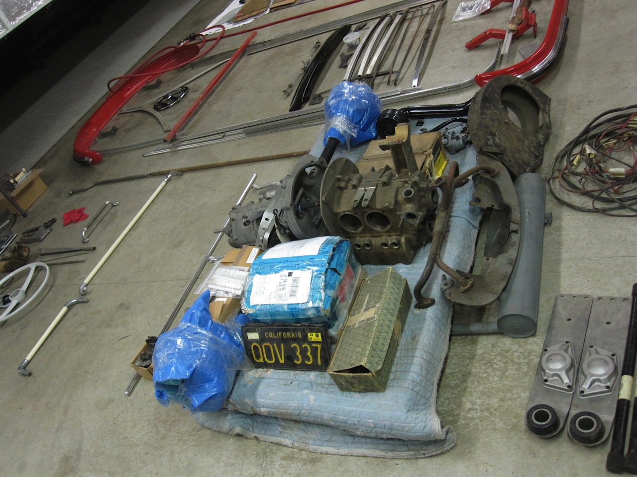

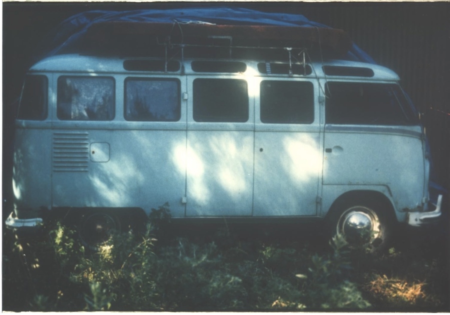

Thought I would share the restoration process on my 55 Deluxe. The Bus
is a 1955 Deluxe with Semaphores, Factory Safari Windows, and 6 Pop outs.
Built March 26, 1955 and left the factory on April 4, 1955 delivered to Competition Motors Hollywood, CA. Located quite a few years back by
Buggen who proceeded to tear it down and start the restoration using all
NOS German panels or original donor panels and collected most of the NOS
parts needed to put the Bus back together. After losing interest he sold it to
me and it was shipped to Douglas Denlinger of Transporter Restorations to
be completed.
As discovered by a previous owner
On the trailer heading to Phoenix, AZ
Parts

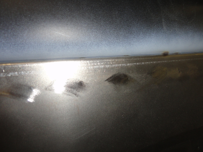

When the bus arrived in AZ we soon realized that a previous blaster
got carried away and in just the right lighting...

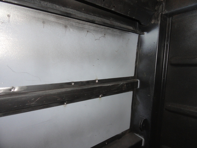

It became apparent that the panel could not be beaten back to shape so
a replacement was ordered and the original was carefully removed by
Trevor and crew then the new panel was spot welded back on.

The man obviously did not shoot walnut shells on the body. There was some serious heat buildup to cause that much distortion to the sheet metal. He probably did not have the nozzle at enough of an angle to the body, too. I don't like a media being shot over "sealed" panels," e.g., rockers, because it goes through every little crack and drain hole into the panels.

I s that from using what kind of medium<sp for blasting..walnut shells? sand? or just the heat? just for further reference.
Buggen....Matt, will need to answer the question. However, in my 25 years of restoration experience, along with the shop that handles all my blasting Pro-Strip in Mesa, AZ, for panels to warp as seen in the above picture, it's usually caused by one of the following:
Sandblasting the inside of the long side
Too much pressure
Wrong media used to blast the vehicle
In this case, I'll bet it's all 3 of the above.
Needless to say I was completely floored when I saw the side warped like that....Matt, Kirk and I spent an entire day packing the parts and bus for the road trip.....none of us noticed this....even the photo on the trailer just outside of Kingman, AZ at a slightly different angle revealed no clue of the problem.

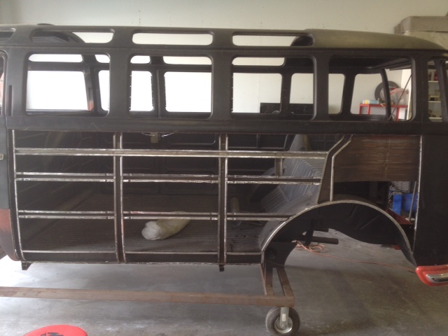

So as Kirk mentioned, a new side was needed, since NOS are more than a bit difficult to locate, I called on my european friends to give me their impressions on the Autocraft metal, after several glowing reviews, an order was placed. Special thanks to BBT Bob, Enrico and of course Autocraft.
Now that the side was inventoried, the search began for the best possible way to install the panel.....to me that always means as original as possible. When I stumbled across up and coming bus super star Trevor Reis who had just landed in his new shop and had access to the "right tool for the job".

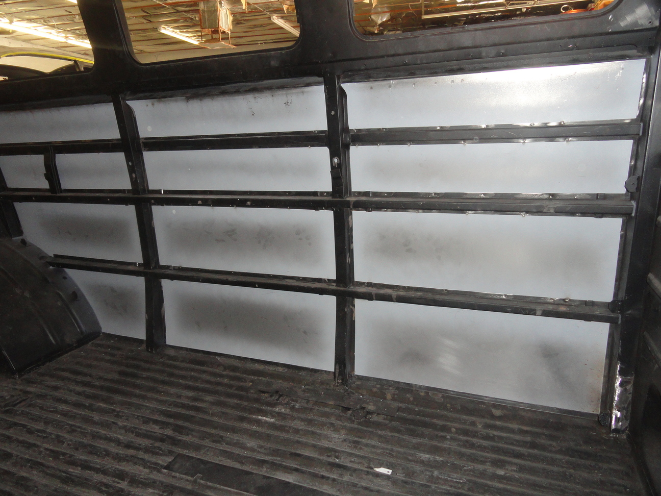

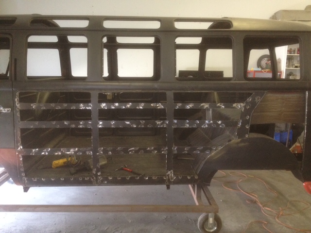

After a bit of time to remove the warped side and prep the frame work

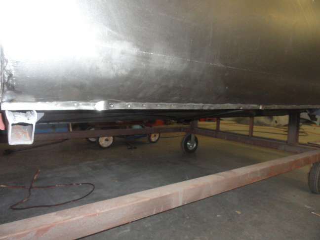

So, I'm more than pleased with the results.
The Autocraft fit is nothing short of incredible.

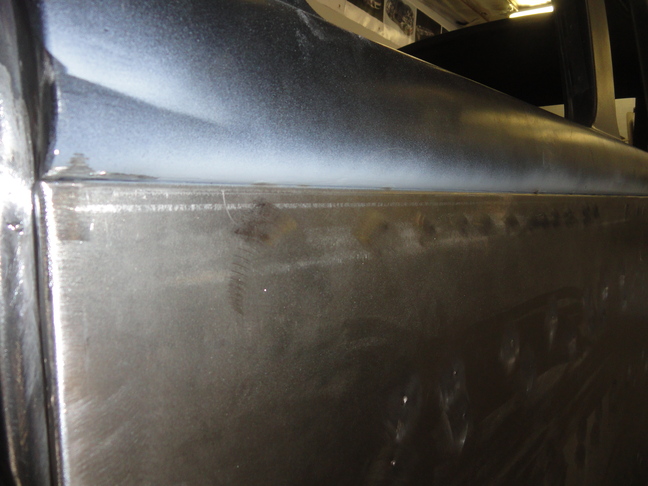

Hey Doug, How did Trevor spot weld along the top of panel @ beltline?
I always wondered about that, too. How are top edges of the panel sealed off?
Plus, in the photos it appears as though the spot welding caused puckering around the welds, is that just an optical illusion?

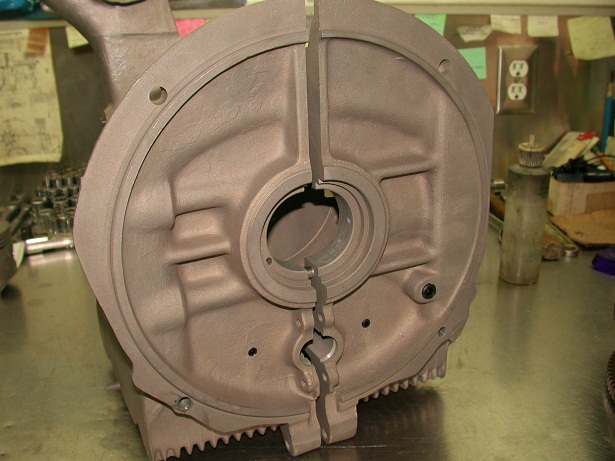

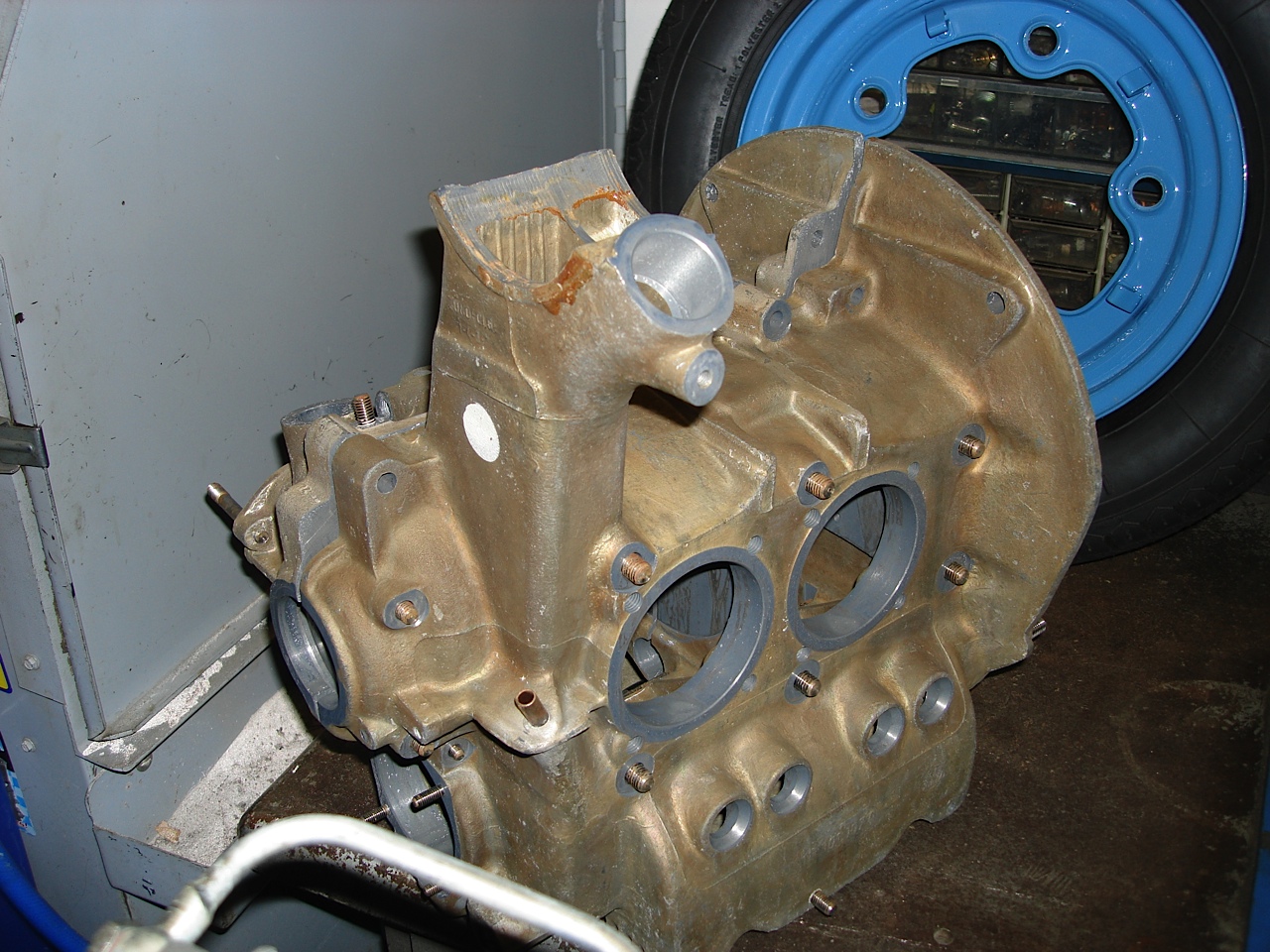

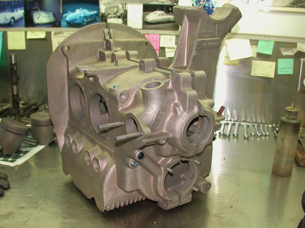

Here are some pics of the NOS Case that came with the Bus on Frenchy's
bench awaiting a rebuild. After a thorough cleaning both Doug & I felt that
the finish was not up to scratch so it was shipped to Joe Ruiz (Mr Okrasa)
to be refinished using his "Gold" coating process. Frenchy is handling the
rebuild as his attention to detail is second to none.
After cleaning:
After "Gold Coating"
Hi Greg.....the top edge was spot welded as well, a little difficult to see in the pic's. Several spot welders, with various tips were used to get in the hard to reach places.

Braukuche wrote:
No puckering, that side is as flat as one that would have left the factory. The marks you see are cleaning up a bit of slag and prepping the spot weld for sealer adhesion.
The front edge on the b-pillar was plug welded

PostPosted: Tue May 15, 2012 8:55 am    Post subject: Reply with quote
Great work. None of my tips for my spot welder fit in this area along belt line seam.
