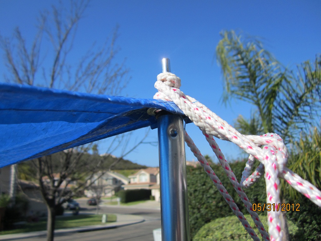

Below are pictures of my $40 awning. It is made with things you can buy at Walmart.
Coleman tent poles $12 x 2
5 ft x 7 ft tarp $6
Tent stakes $4
Small plastic clamps $4
Rope $2
Total $24 + $6 + $4 + $4 + $2 = $40

Fair to say this is a shade-only awning? I love the ingenuity and all, but can't help but think the first bit of rain that pools in the middle of the tarp is going to pull right through those clamps and right in at the slider.
I did a similar thing and found it's the weight of the water (and wind) that will get ya every time.

The automatic rain dumping clips are a great idea.
If you buy 3 more poles, make it self standing with a peak.
I have, in my 40 plus years of camping in just about every camping option have had many of these. From really big ones supported by campsite trees to roll into a fixed bag, to the Fiammas to the big roll ups. Shade is good.
Out from the rain is good, but rain rolling off and not pooling is the key.
Had a canvas awning attached to the trailer onc, no center support, rain started (we were gone) started pooling, weighing down the middle, more rain etc. Got back and the center was hanging down about 4' and the entire awning full of water. Cut a guy line and let it spill. Guy line was tuned to about a high C.
As a temp solution the blue tarps are good, but over the long run, save up get a good one.
