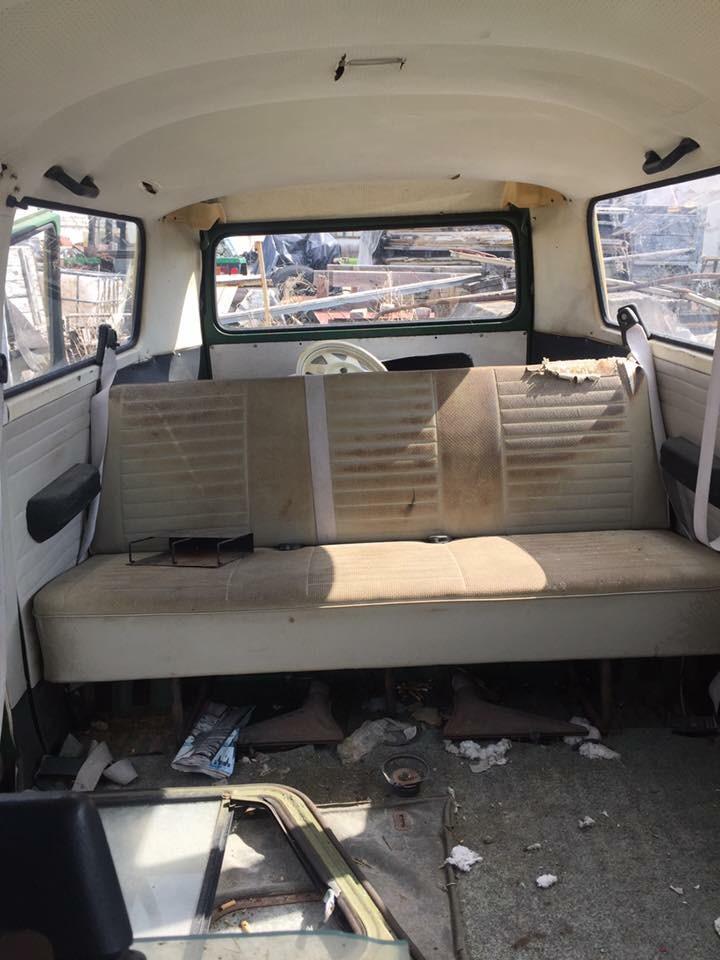

No idea what the year is, paperwork has gone missing, the early bumper threw me off too. Here are aome pics. We got it in the air with a forklift last summer, it seemed pretty good from underneath. The roof is steong, no denta or rust. The interior was brand new, quite a shame conaidering the state of it

PostPosted: Sat Nov 25, 2017 7:18 am    Post subject: Re: T3 barn find/field find. Is it worth rescuing? Reply with quote
the last pic belongs in "mossy bus" post

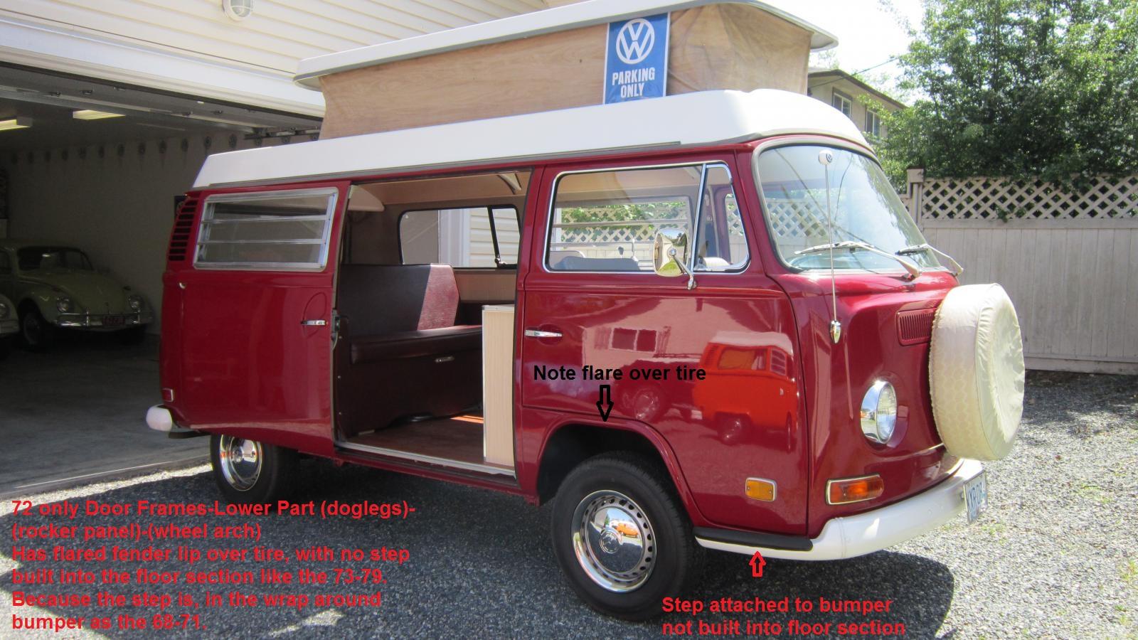

Gotta be a 72. Rear bumper looks correct, also looks like they saved the silver windshield wiper arms used on a 72. Compare doglegs to this.
Tcash wrote:
Searched did not come up.
72 only Door Frames-Lower Part (doglegs)-(rocker panel)-(wheel arch)
Has flared fender lip over tire, with no step built into the floor section like the 73-79. Because the step is, in the wrap around bumper as the 68-71.
Thanks to Volktales for the pic.
72 only front Tow Hook.
Keep on Busin'
