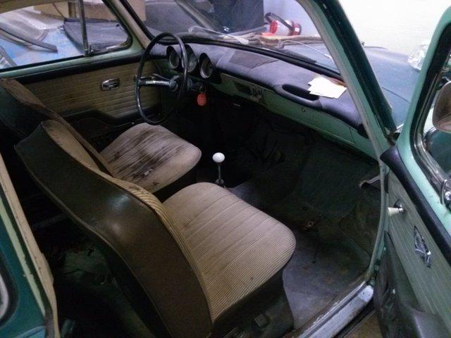

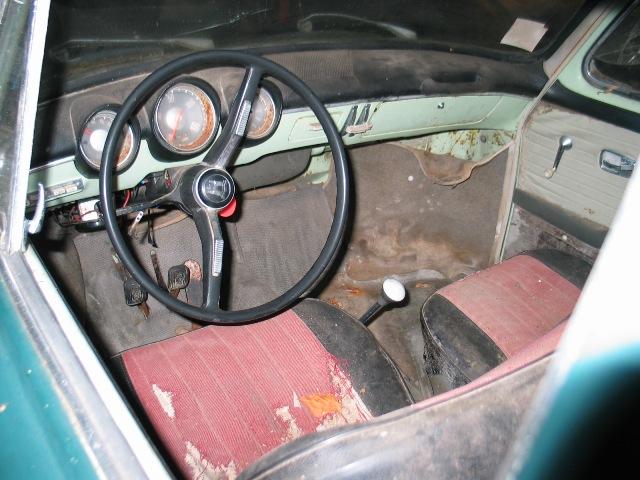

Well, I finally managed to get the car here in October. I’ve started to have a good look at what I have, but with no heat in the garage yet I won’t be doing much to her in the next few months.
Tried scraping off some of the re-spray, it comes off pretty easily, I hope to be able to take it all back the the original birch green.
I peeled off the ugly red and black snap-on seat covers and found this underneath. Just like opening a present.
SMS are sending me a sample of cloth they have produced which might be a match.
