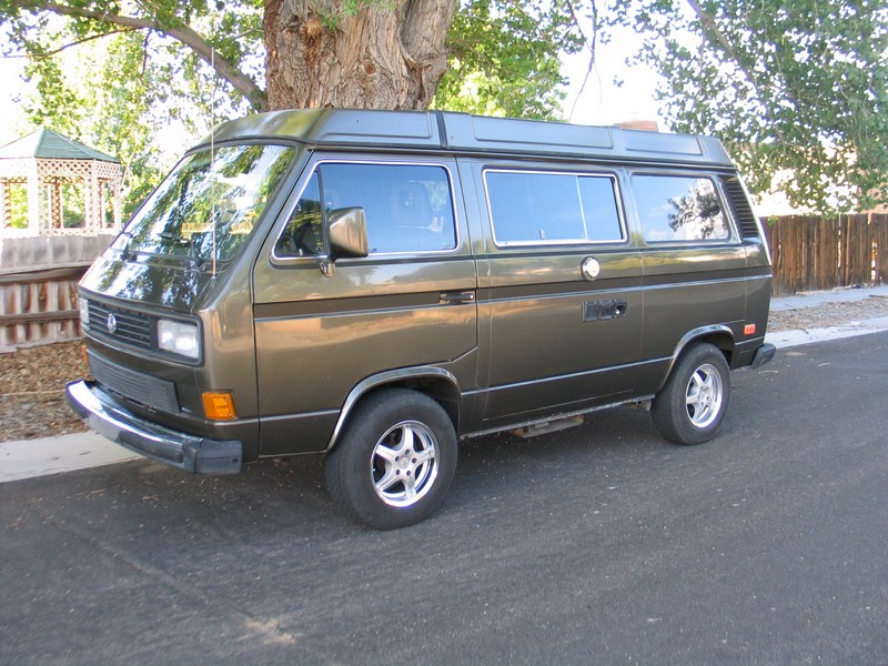

I've got the Voxx ones in th first photo. I didn't buy them, they where on the van when I bought it. They fit well, but the lug holes are very deep and the original lug wrench doesn't fit, no big deal. I just carry a star lug wrench with me. One thing I noticed is that the bolts that hold the drums in place (during the assembly line I presume) had to be removed.

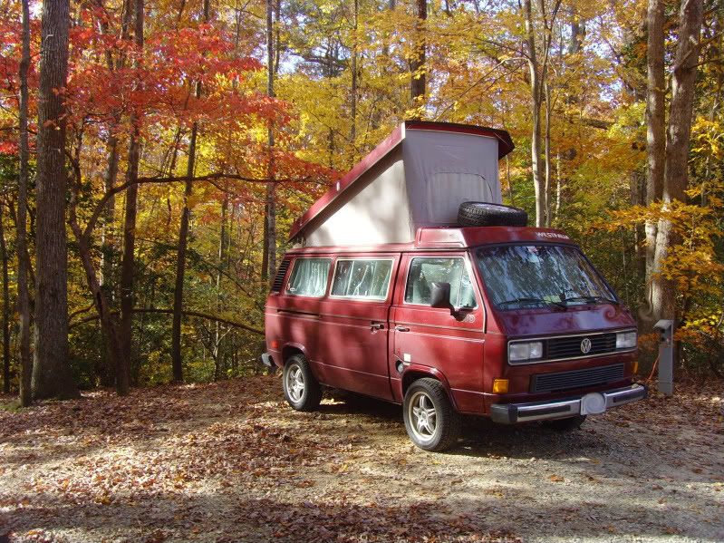

I have the VOXX MG3 wheels. No modifications necessary although I did buy the T3 conversion lugs for the front.
They haven't fallen off yet.
Bought them last year.

The VOX MG wheels in the first pic are discontinued (I need one for my spare)
The Voxx MG3 should fit but I'm not sure about the load capacity of them..
