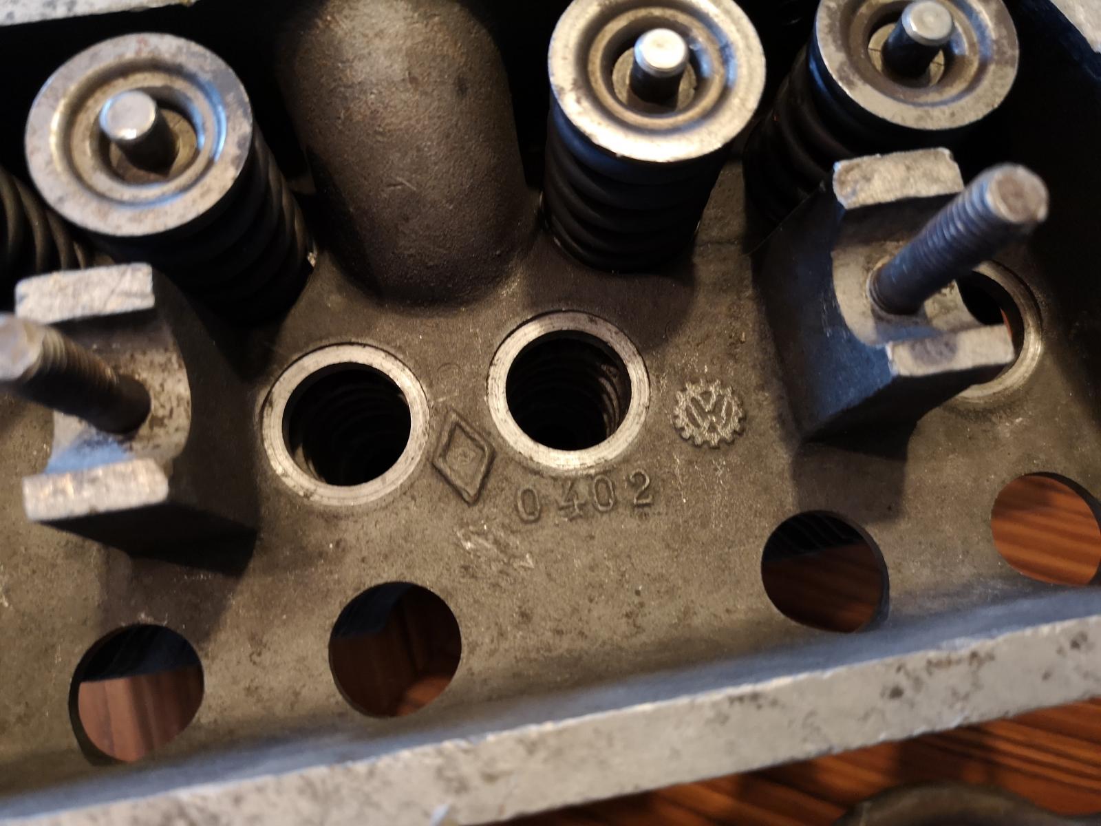

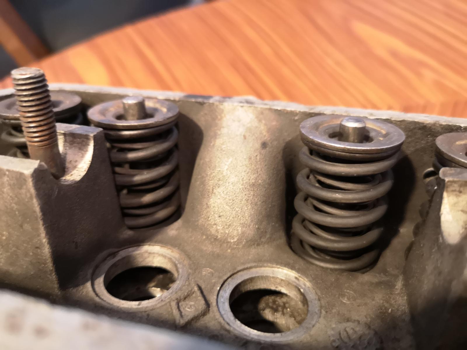

Hi everyone,
I have a strange head, because it is really early with cog wheel. It has dual spring, that is really weird.
Does anyone know about this?
thanks

Measure the diameter of the cylinder openings. It tells if it's a pre or post 43 KdF head.

my 1951 engine had dual springs.
drive your split.

Dual springs were in use up to 29th of May in 1952.

Ok thank you all, I didn't know that early 25hp had dual springs.
Will check the cylinder opening

PostPosted: Tue Dec 03, 2019 2:58 am    Post subject: Re: Found a weird dual spring early cylinderhead Reply with quote
I checked and they are 82mm, can you tell the period from this?

PostPosted: Wed Dec 04, 2019 11:24 am    Post subject: Re: Found a weird dual spring early cylinderhead Reply with quote
It's for 1131 ccm, 1943-49, the most probably made in the war time.
